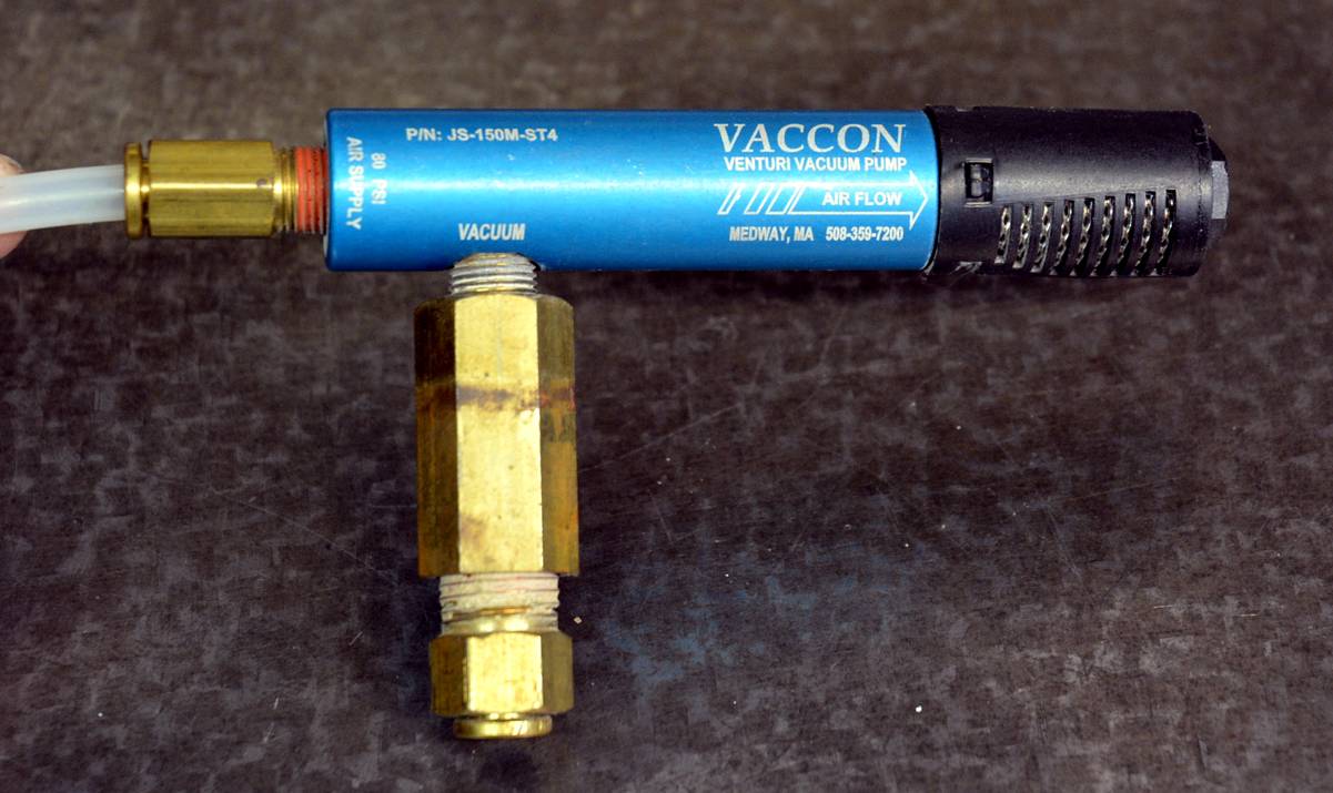

Here is my venturi thingy.
Attachment 27678 Click thumbnail for full size images.

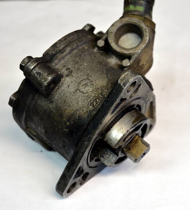

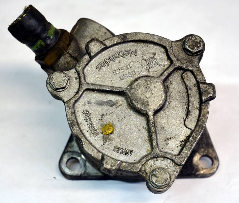

Here is the power brake vacumn pump to compensate for the lack of manifold vacumn in diesel engines. This was driven off the end of the camshaft, so around 3000 rpm should work really well. They have a good flow rate and suction but I have no real data.
Attachment 27683 Attachment 27684
