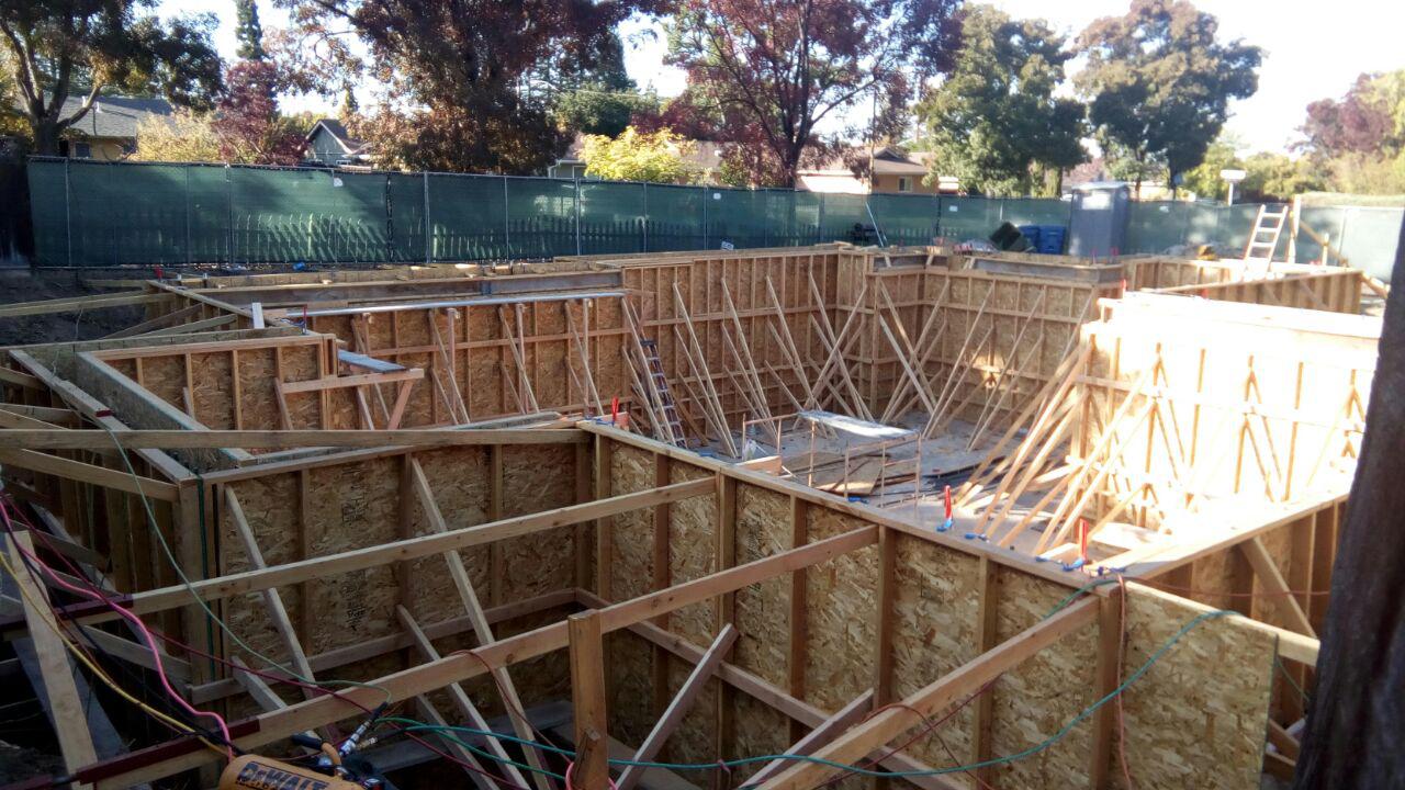

    No work today in the pit, but along with the sill plate bolts they've put in a few pairs of LARGE bolts. One pair can be seen sitting on the table below and you can see a couple pair installed on the far wall. Big beams go here? Maybe the mount for that overhead crane to move around the pallets of gold bullion?
    They've also closed off the door in the forms, added a ramp and a ladder to get in/out.

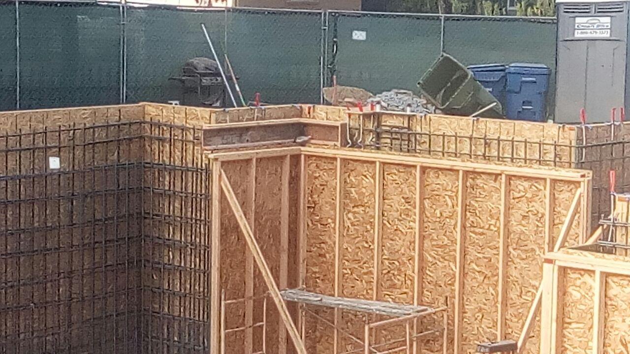

    Here's today's picture, inside forms are going up. I see from their placement that the first floor will be cement, unless there's some other reason to leave rebar above the wall height.

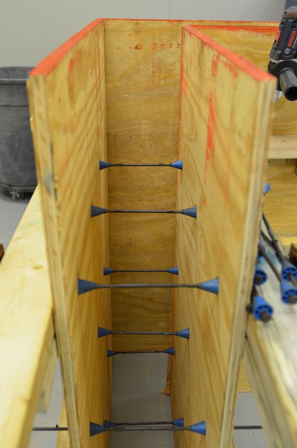

    If it were me building it as soon as all of the inside forms were in place then use something like waffle dome forms supported by beams and support jacks pouring the basement wall and the ground floor in the same pour
    https://www.concreteconstruction.net...n-room-floor_o
    But they are going to need to install a lot of these to hold those flimsy looking OSB wood forms in place

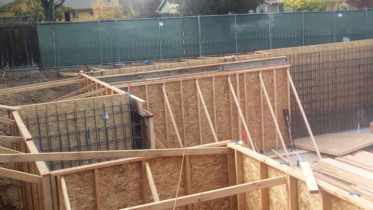

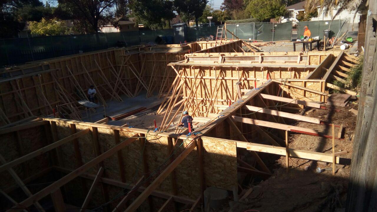

    Ok, they took a left turn on the forms. They're putting a narrow section on top, so I guess the idea is to make a shelf to put the floor beams on. Not sure how easy it will be to fill the forms through the small opening but that's not my problem.
    Also, some new, different anchor bolts in the second picture.

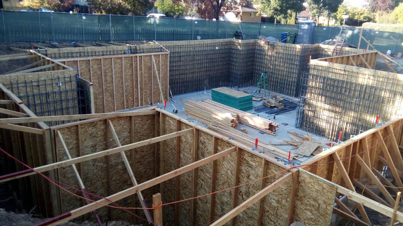

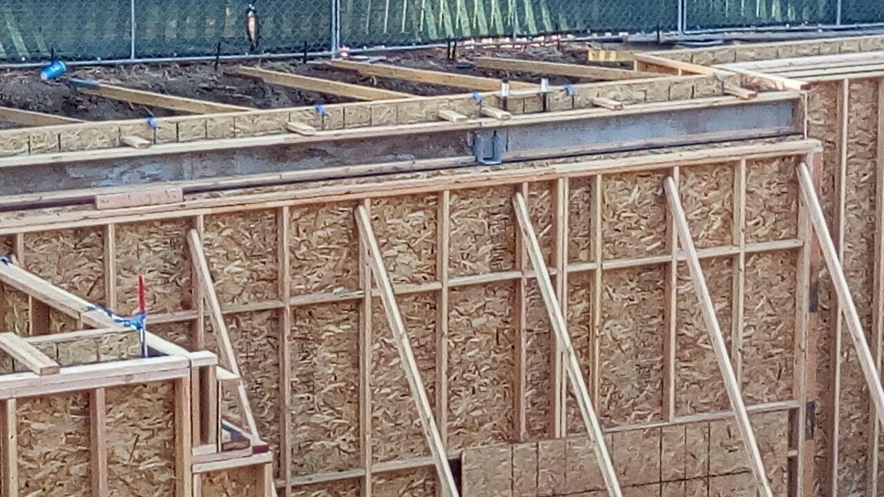

    Forms are slowly going in. There is ONE beam hanger that I can see, I assume another on this side. So, one cross beam?
