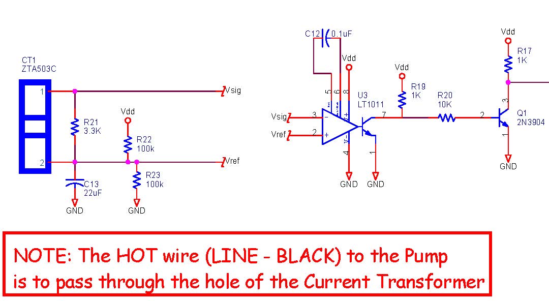

Turns out, I had a similar problem as I had a pump that I needed to monitor and if the pump stopped running (for whatever reason) I needed to raise an alarm so that yours truly could intervene. For that, I designed a circuit using a current transformer that looks like this:
Attachment 47570
Vdd is 5v and GND is NOT attached to earth.
That circuit works really well and can sense the current flowing when the power was down to less than a watt and up to many hundreds of watts (the pump was a variable speed pump).

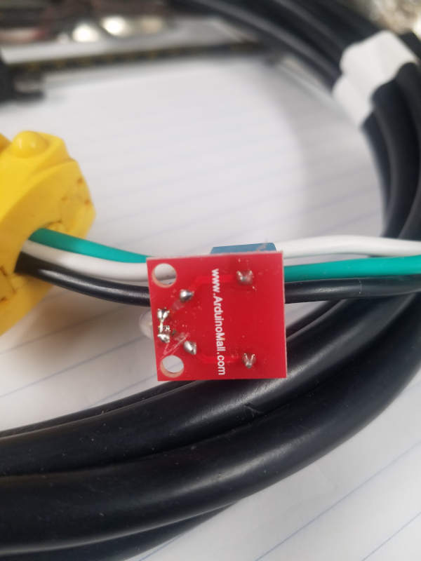

the back of the board
Attachment 47572

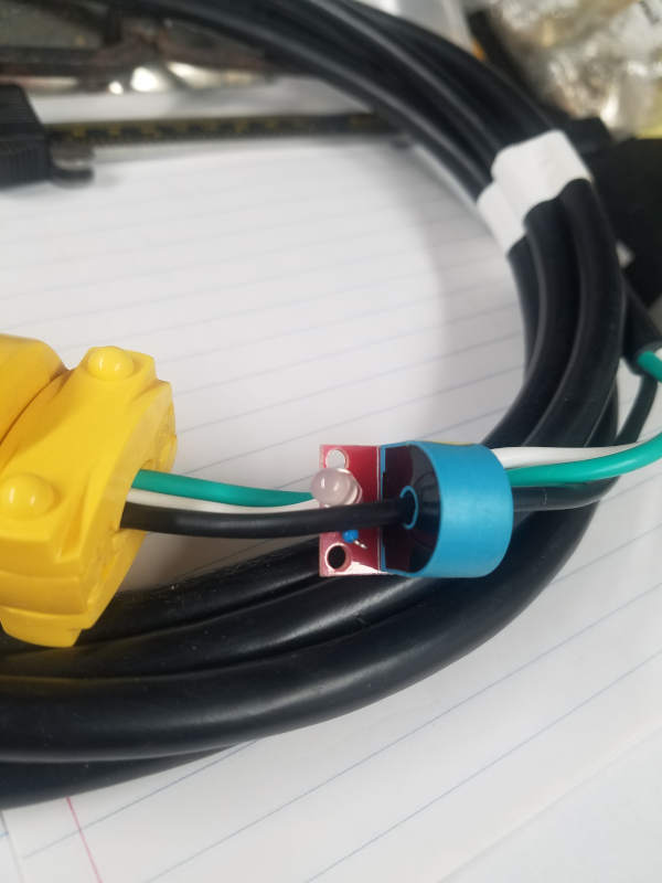

the front of the board
Attachment 47573

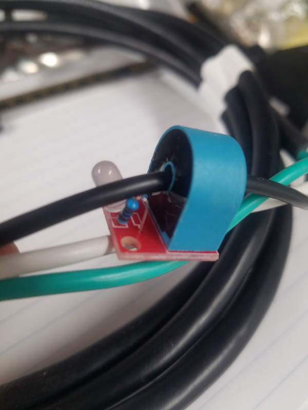

closer view of the front
Attachment 47574
