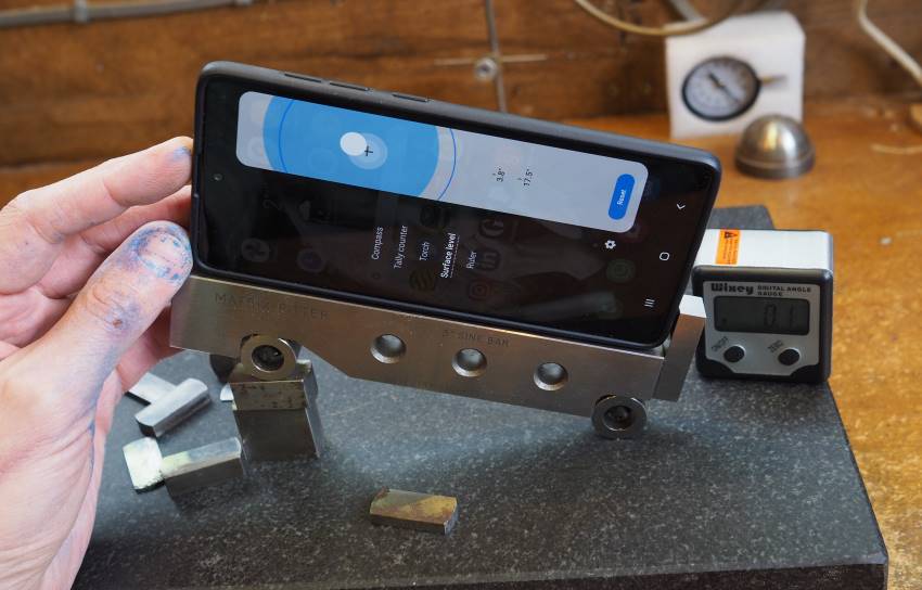

I came across the angle gauge feature on my Samsung A71 android phone and wondered how good it is. So I set up an experiment.
Attachment 38767

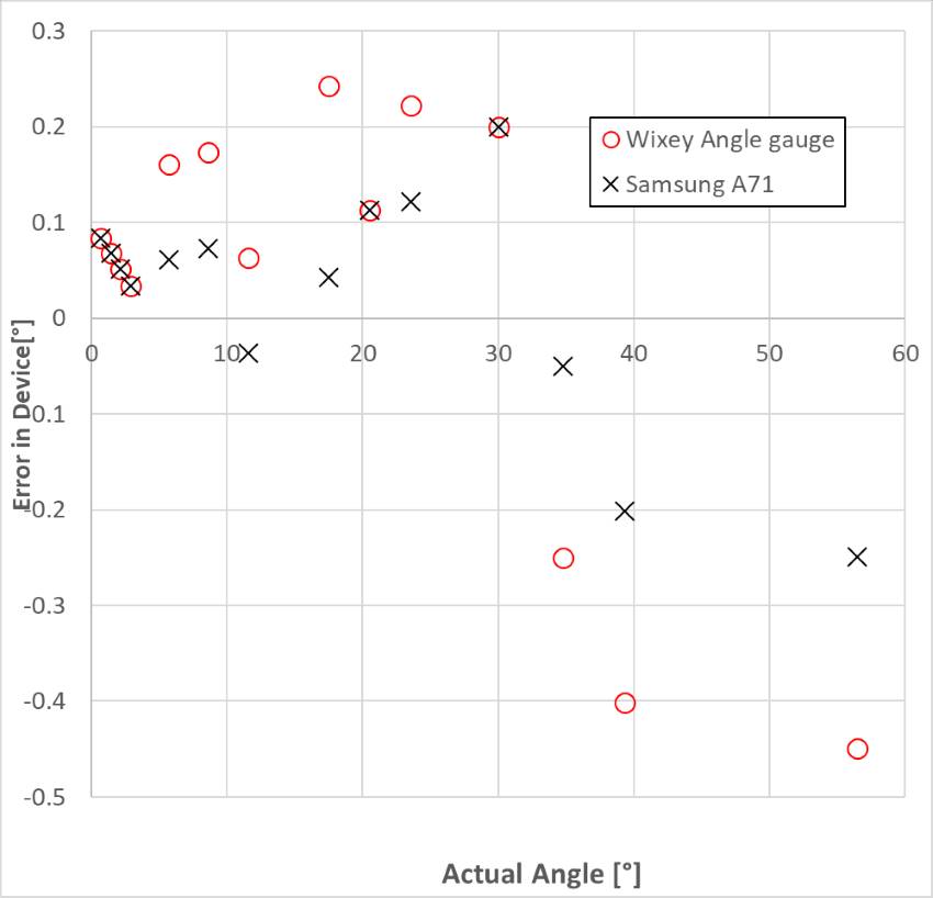

The Wixey angle gauge =+/-0.22° and the Samsung A71 = +/-0.12°

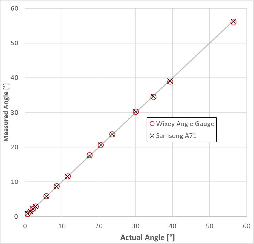

The plot of the phone and angle gauge versus the sine bar shows both are rather good in fact
