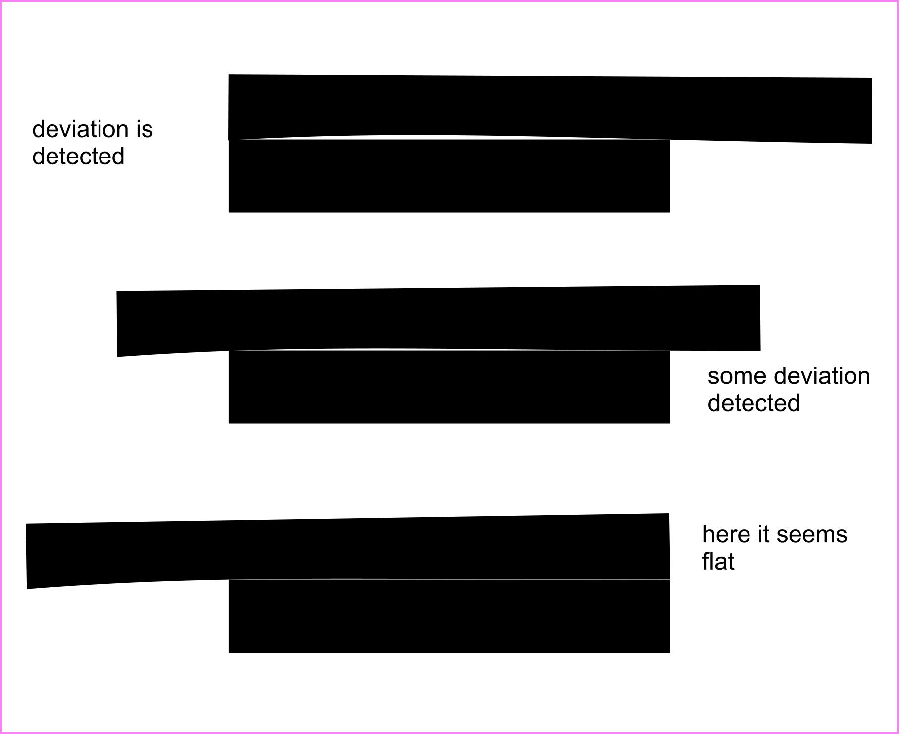

    Hey Johan, glad to have found an other crazy man who endeavored into the three plates method to gain its own flatness
    I've been humble and what I aimed was something in the order of 10-30 microns, so to have a final precision within/less than .01 mm.
    About the laminated chipboard, the stains are there for other reasons (spilled dye), but besides that board is fairly flat in its kind, you are definitely right about the fact that it is not flat by itself as every piece of wood is. So, was it a source of troubles in providing a good support of the pieces? Well, yes it could have been, because the deflexion caused by the weight of the part itself (plus the second part put on top when rubbing against the dye) in the worst case would be 22 microns.
    Ouch, it didn't went in my mind to check this thing.
    However, in a way or an other, that must have not influenced much the work as I checked the final result against my surface plate (which is AA grade) and it seemed ok, but as it is smaller than the part to be measured I did the job in three steps (see picture).
    Then I had the opportunity to checked it against a larger surface plate, confirming it went nicely flat.
    I was lucky.
    So thank you for having pointed it out, I will add a pinned comment to my video mentioning this point and crediting you, if you don't mind.
    Also I liked your instruments.
    Cheers, Claudio.
