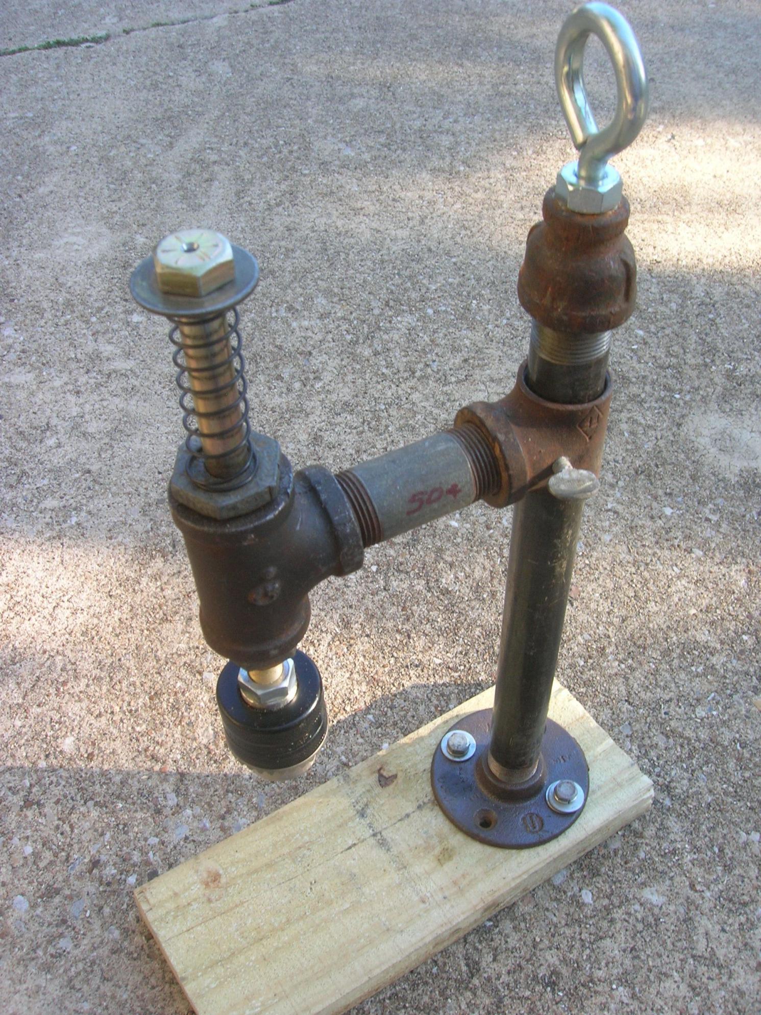

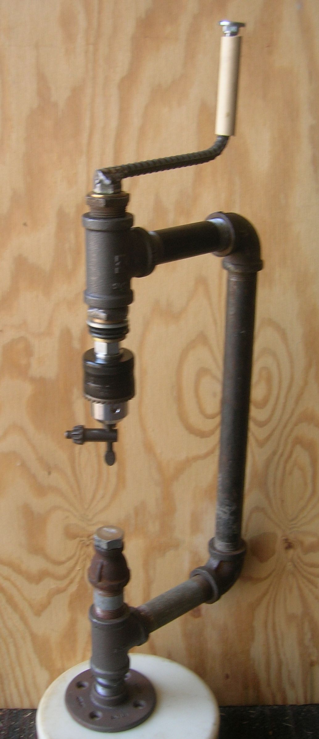

If you are interested in a more modern looking but still hand powered drill here are two variations made from iron pipe with a long 1/2"x20 bolt as a spindle, using a couple of bushings into the pipe Tee and a homemade thrust washer by dishing flat washers and adding loose ball bearings. The lift for the work piece on the first one is via a 5/8" SAE threaded bolt that just so happens to also fit in a 3/8" pipe female thread. Welded a handle to the bolt head but a wrench turns it just fine as well. This is an approximation for a "COLE" drill, but is arranged so it can be mounted vertically or horizontally with a pipe Tee and pipe flange. You can move the Tee and flange to the back side by replacing those pipesAttachment 19204
Attachment 19205
The second one has a spring return and would use a lever to press down on the bolt head which has been center drilled for a pivot point.
Not pretty but simple and can be almost completely duplicated in a majority world village shop with basically a hammer and a hacksaw.
