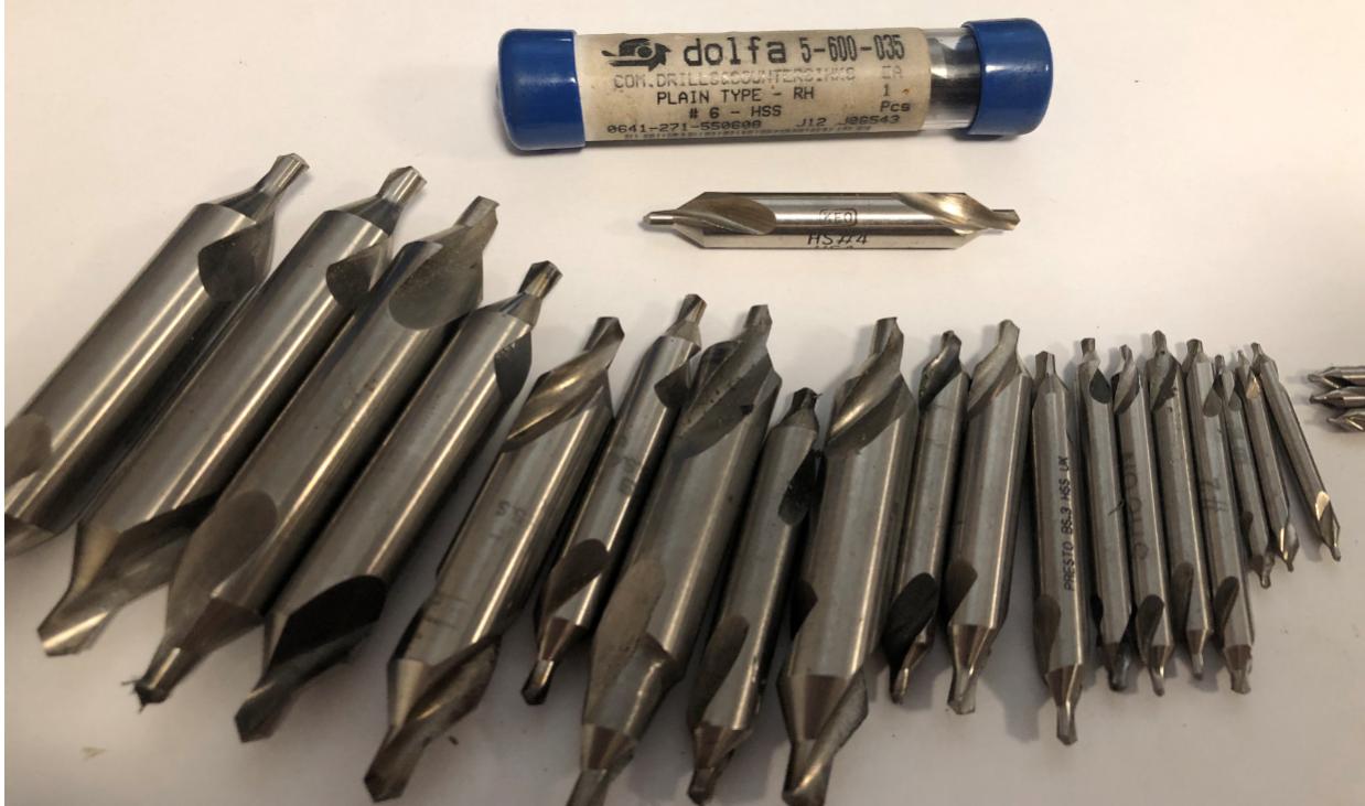

    On the tip at the end on better center drills, can you explain why the spiral cut one is stronger? The one on the left that you refer to as a straight cut is what I have seen and most, if not all of my center drills are that style. But the one you show looks like it has a very poor finish, possible already cracked. None of mine are like that. They have nice, ground finishes like most of my drill bits and end mills do. Is that the reason why the one on the left is no good? Or what? I would think that they both have about the same amount of cross sectional area at the base of the small diameter area, which is where center drills normally break.
    AND, just where do you get those spiral cut ones? What brand? What are they called, other than center drills?

    Hi Paul
    Thank you for your email
    I’m going to try and answer each question in point form
    first question
    can you explain why a spiral cut is stronger
    The spiral cut has a Web just like a drill it starts off small at the top and tapers down wider as you go into the centre Drill Like a skinny pyramid almost or triangle The straight cut doesn’t taper
    Second question
    Most center drills are straight cut
    When I complained about straight cut It was explained to me the cost is almost 10 to 1
    That is why the quality of the grind on the Straight cut in the photo is so low
    The only time we get the spiral cut centre drills is when they are solid carbide
    Question three
    Do they have the same amount of cross-section
    This is where the problem lies if they have equal cross-section the spiral flute will be stronger
    Scenario. Have you ever picked up a Centre drill looked or measured the Cross section?
    If you’re machining an expensive part would you use a no-name tap or a high-end tap
    The only time you’re going to look at the cross-section thickness is if the Centre drill breaks then it’s too late
    If you’ve never broken Centre drill keep using them they are just fine
    Question four
    Where do you get the spiral cut
    I have rarely ever bought centre drills I’ve told other people to get them for me and they just show up When I have ordered Centre drills I purchased them from Sowa tool and machine Co.
    In Kitchener Ontario
    I have also purchased them from Sowa in Calgary for the 2009 world skills competition
    If I have missed any other questions or have not quite explained everything or if you have any other questions Please let me know
    I went to my toolbox at home and got all of my center drills
    And was surprised there are no straight cuts
    Added photo
    Ray
