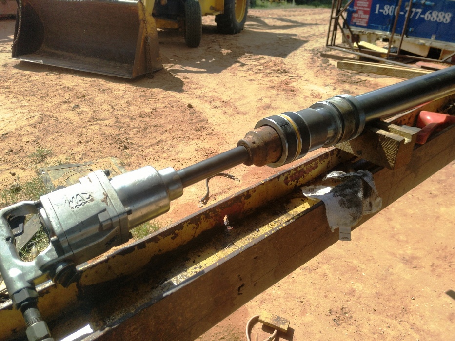

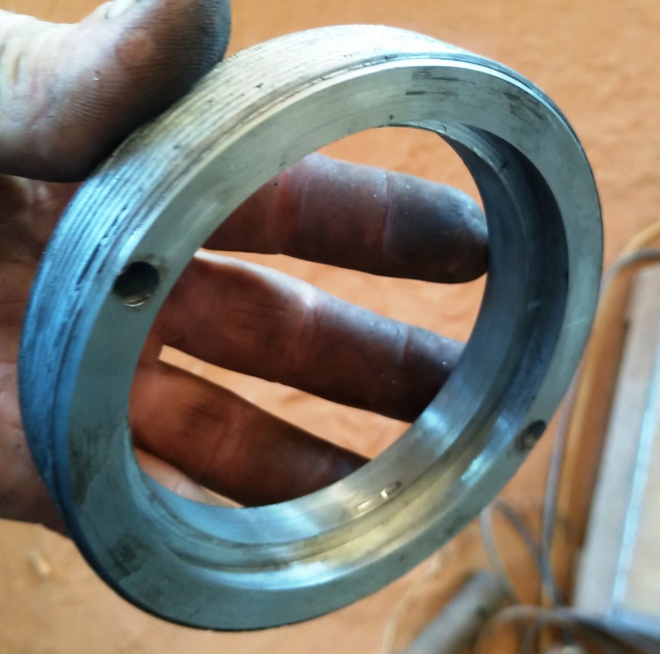

The gland nut on 1 of the Siamese cylinders had some weak looking threads once I had it removed. I decided I should make a new one rather than try and clean up the threads on the old nut.

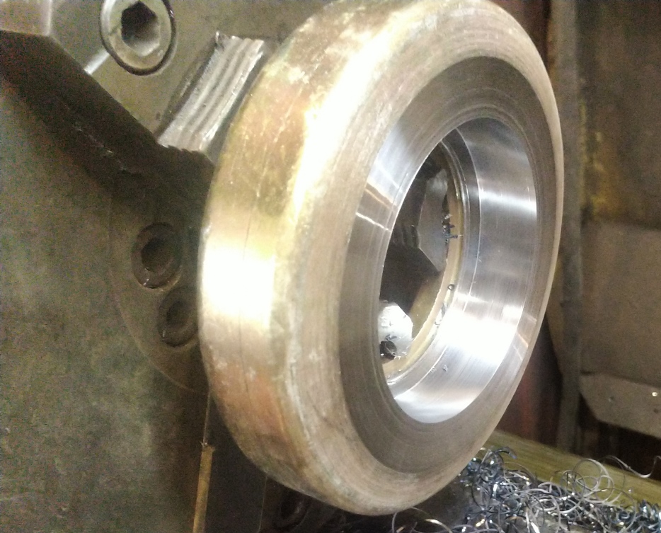

I started out with a roller I had left over from a bygone era of manufacturing 2 post lifts
Attachment 42996

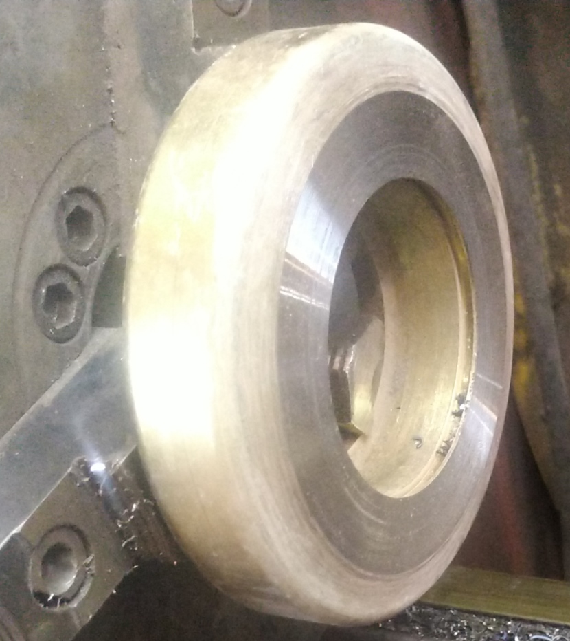

I faced off 1 side
Attachment 42997

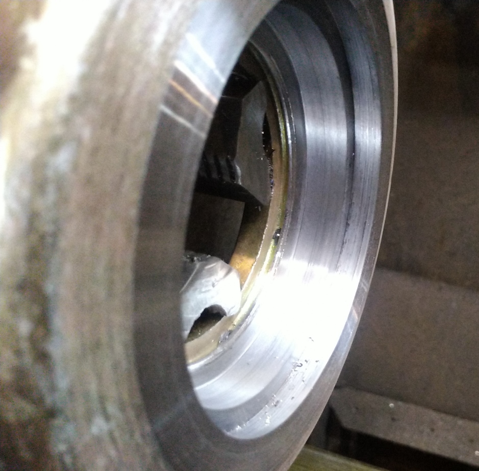

then bored to size deep enough to make the nut
Attachment 42998
Then added the wiper grove
Attachment 42999

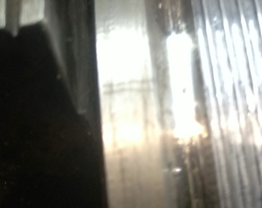

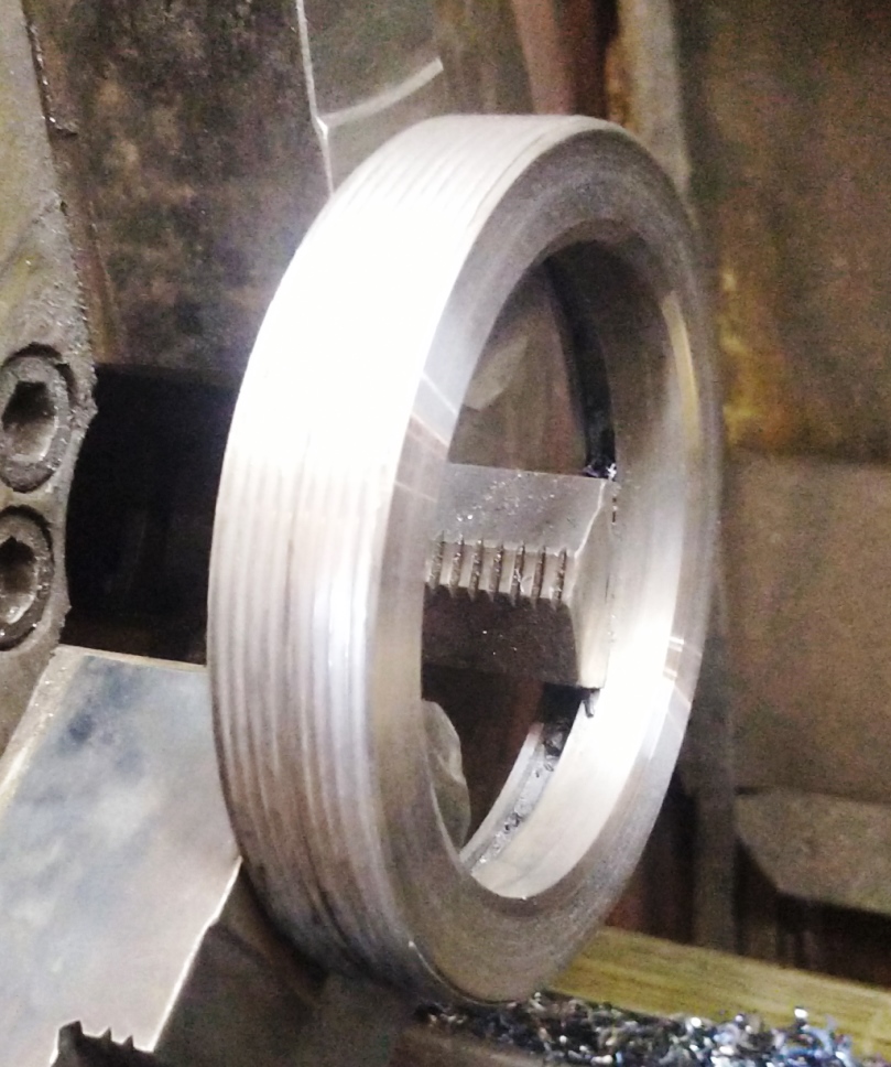

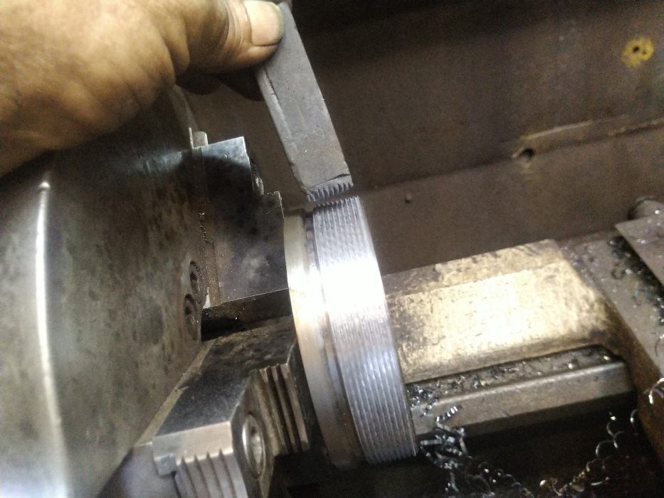

Then turned the OD and treaded to 12TPI and used a stone to smooth the threads
Attachment 43008
Its hard to see but I scribed a mark on the OD incase I needed to return the nut to the lathe and take off a little more of the thread depth
Attachment 43000
Once satisfied the nut would mate up to the threads in the cylinder I chucked it from the opposite side and removed the excess thickness
Attachment 43001

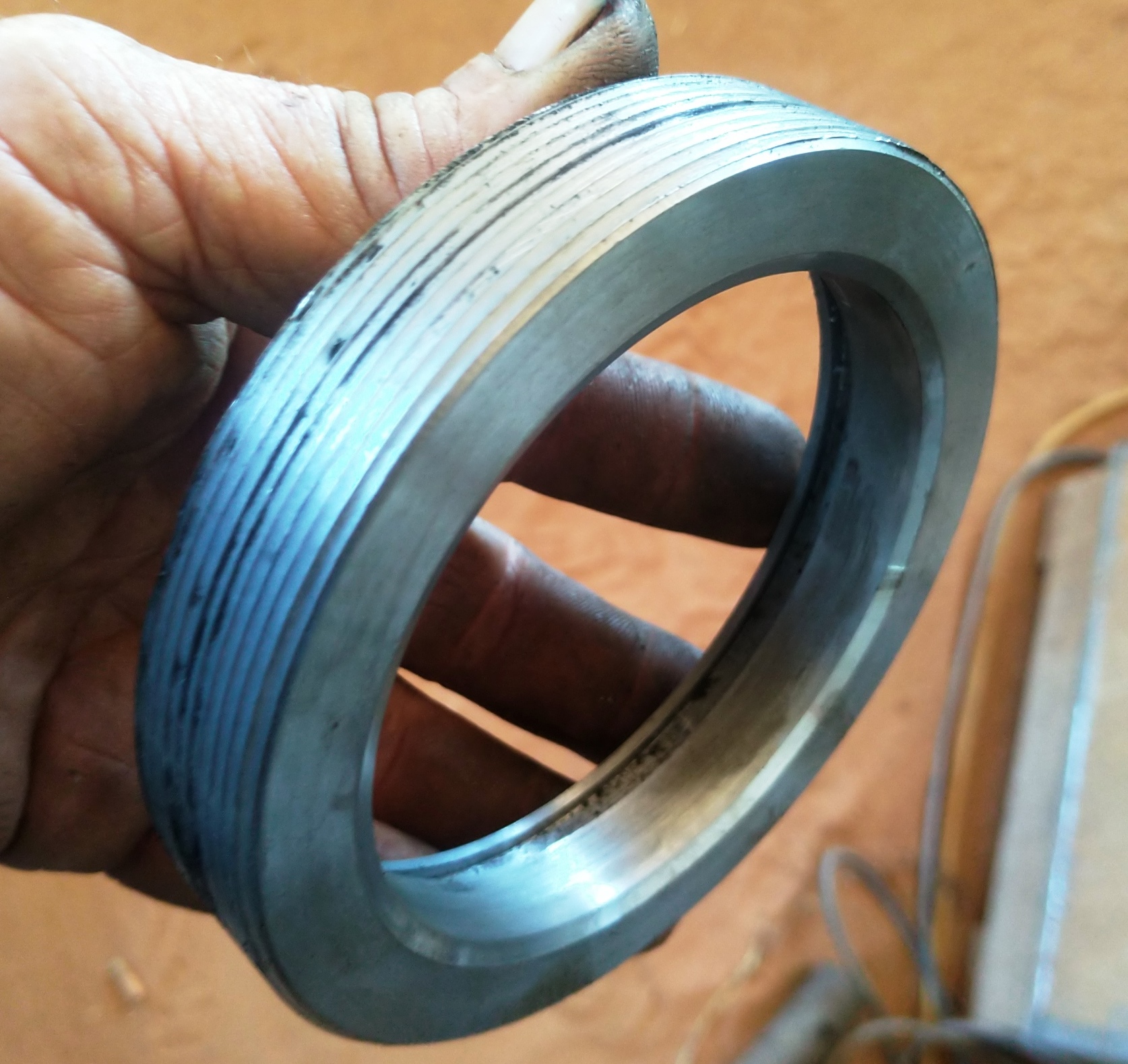

the finished nut
Attachment 43002

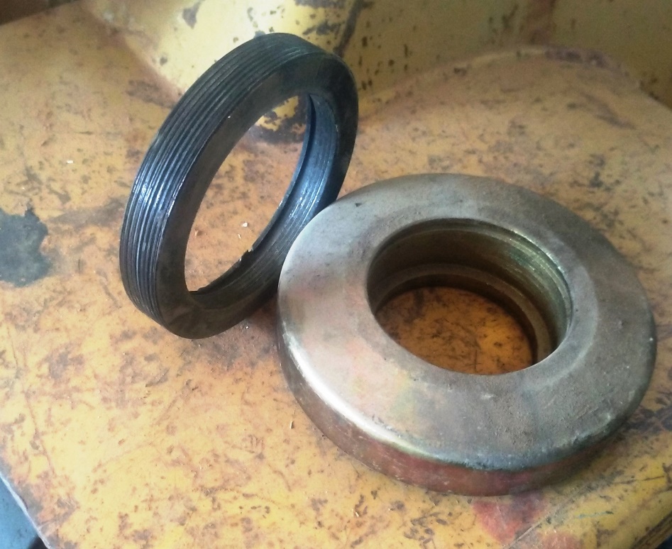

Attachment 43003
Assembly
Attachment 43004

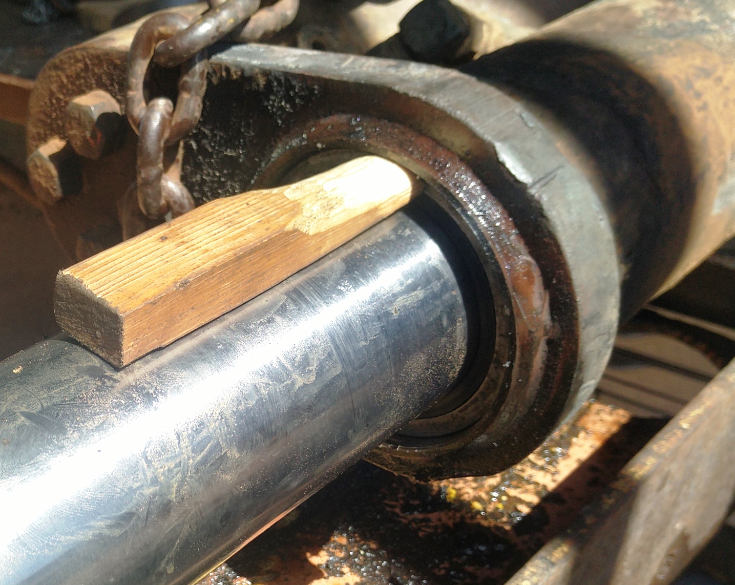

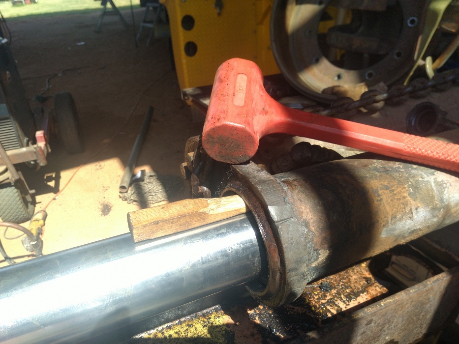

Carving a piece of wood makes the best drift for tapping the gland in place. My brass and aluminum drifts were too large in diameter.
Attachment 43005
I will put this in my tool box to use again
Attachment 43006

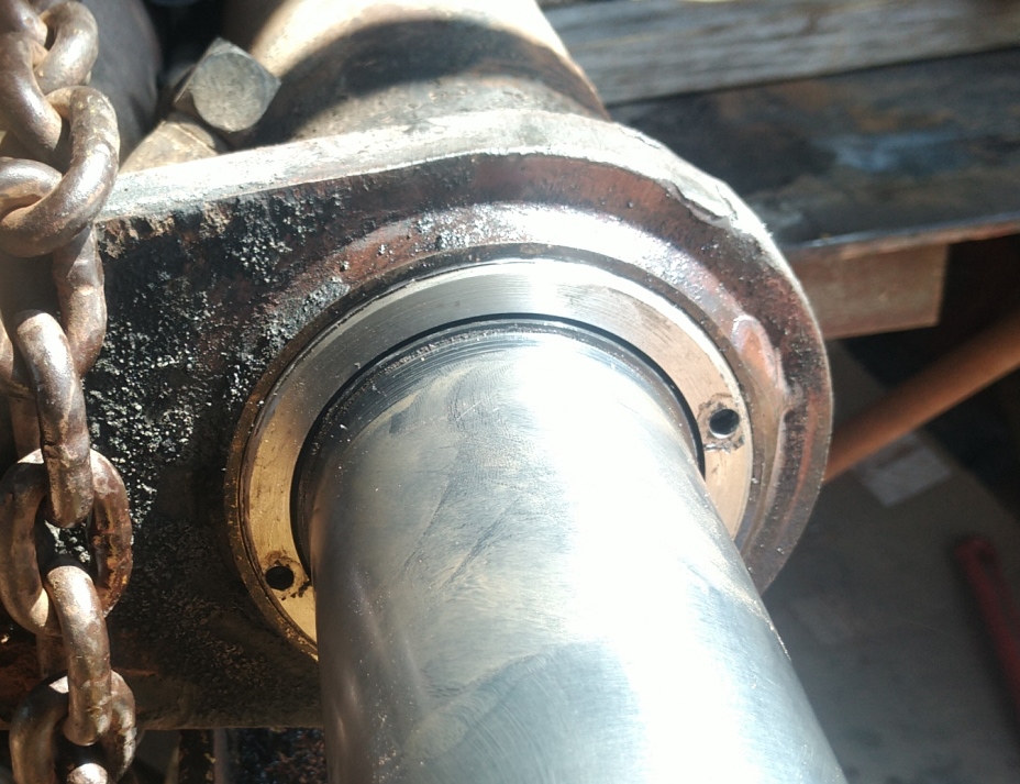

Fully assembled
Attachment 43007
