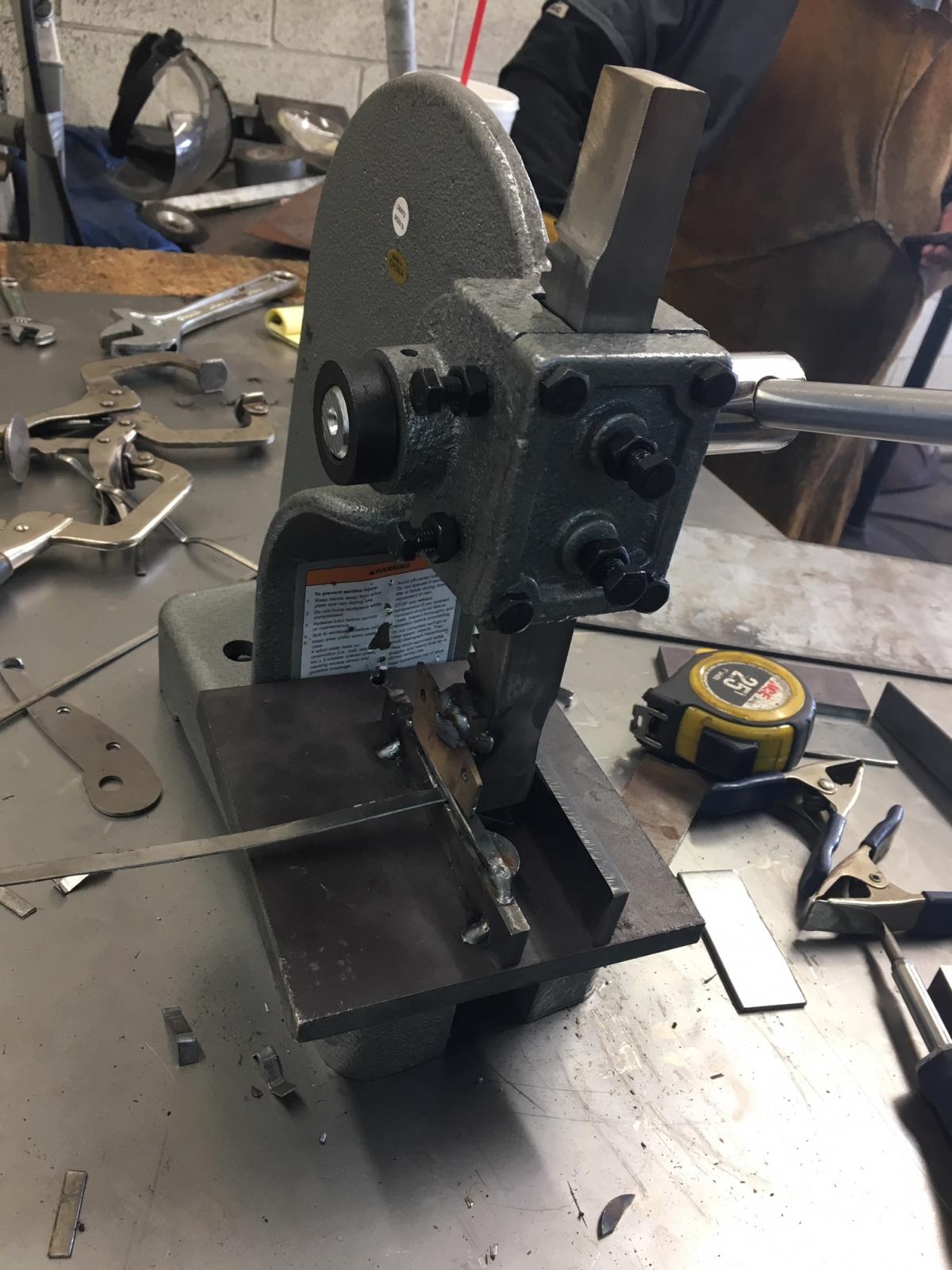

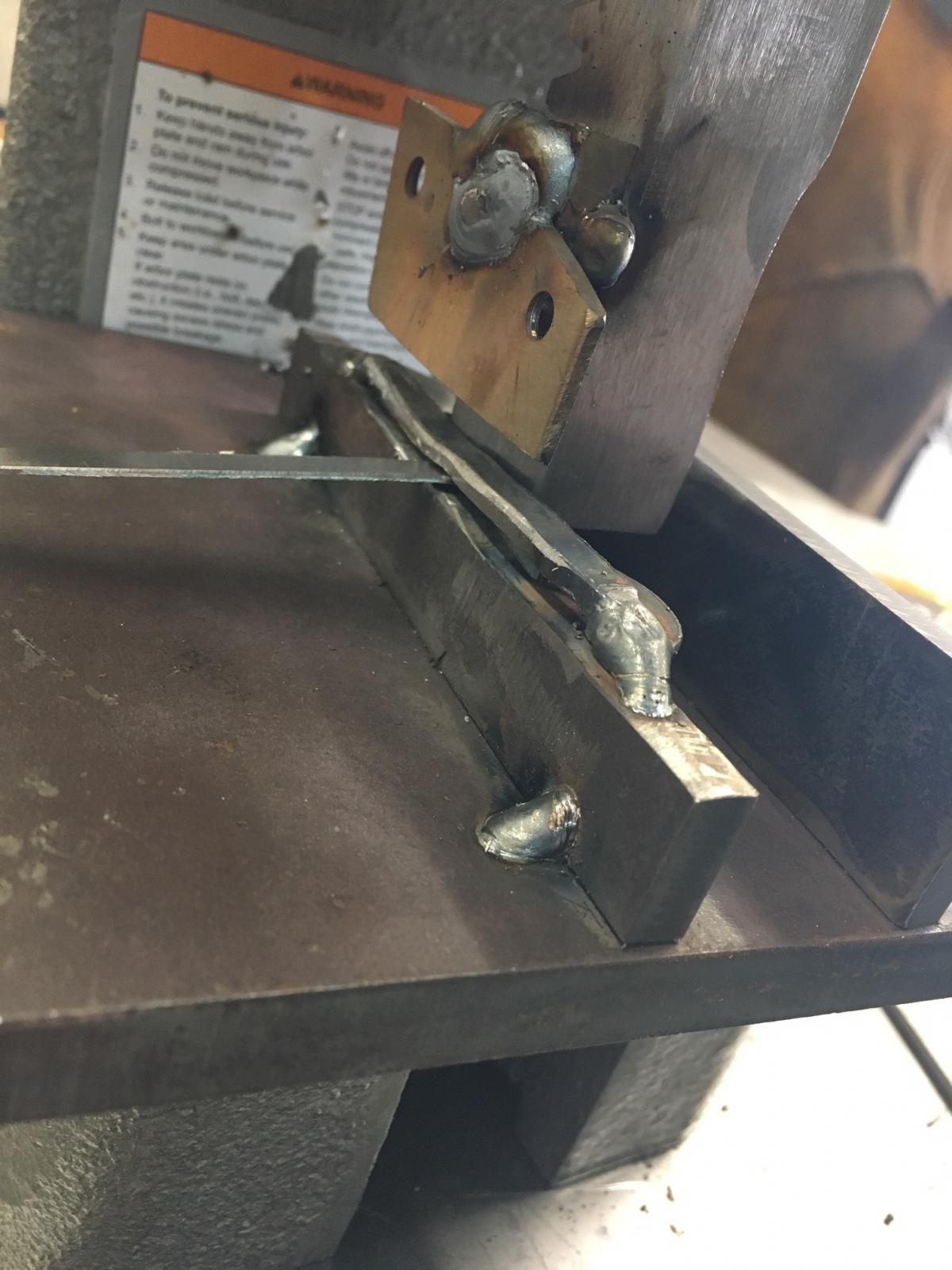

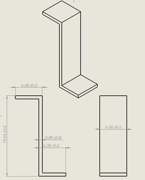

Here's how I make the part now,

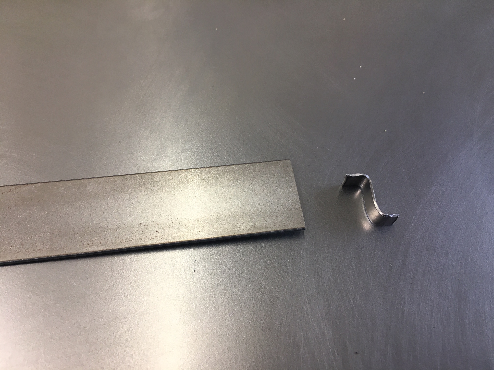

First I cut strips of 20 gauge cold rolled mild steel into 1 1/4"X48" strips
Second I sheer those strips into 1/4" pieces
Third I bend each end with pliers 1/4" on each end
Really Time consuming way to make this little part
Im looking to make a tool that can sheer and bend in one movement.
Heres the part where I need your HELP!!

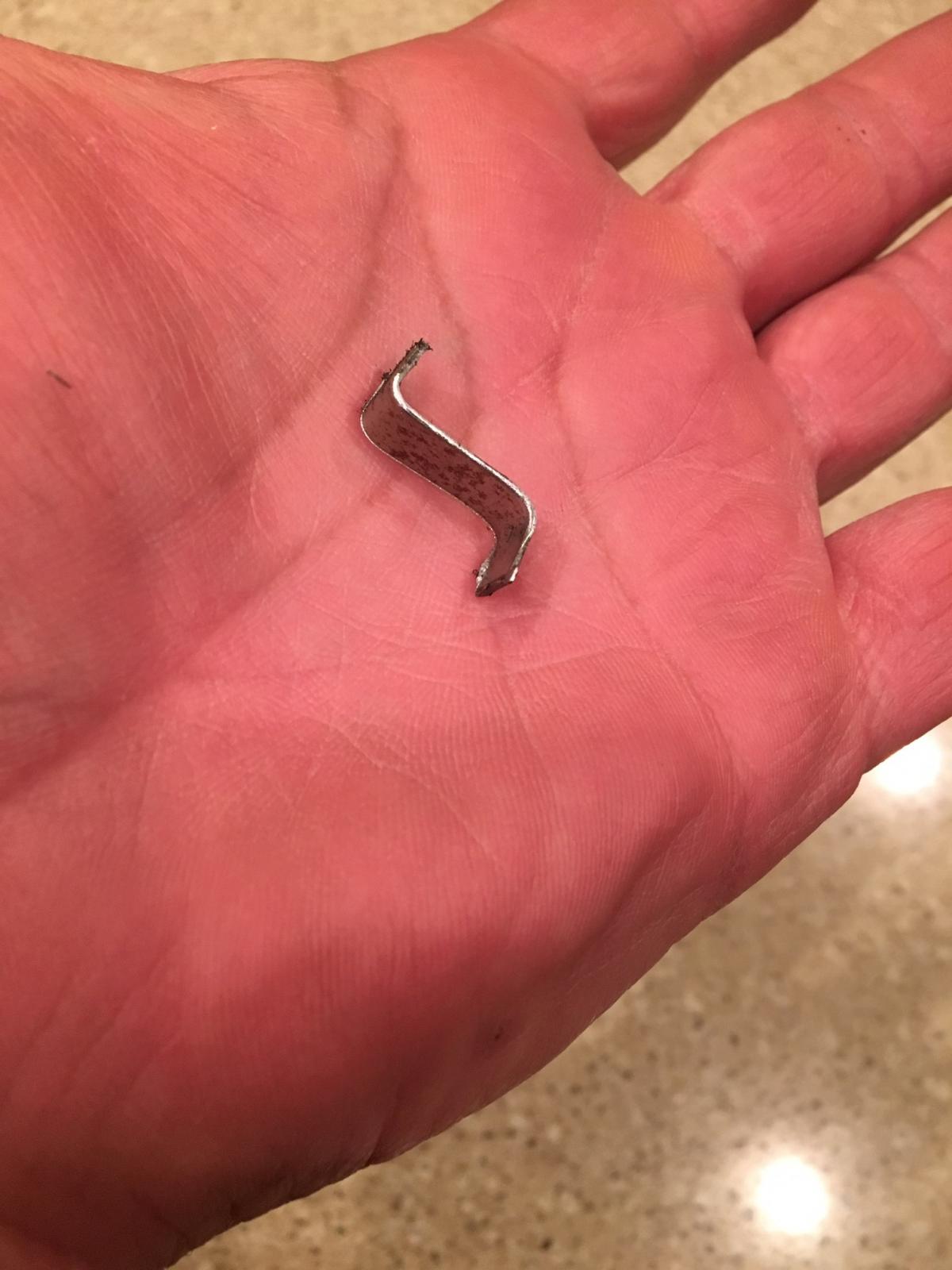

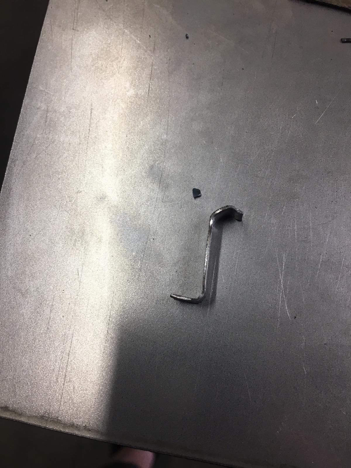

Attached are some pictures of a strip and the actual part along with the finished product. We use the part as an offset
to make our wall art 3d
Any ideas would be appreciated
