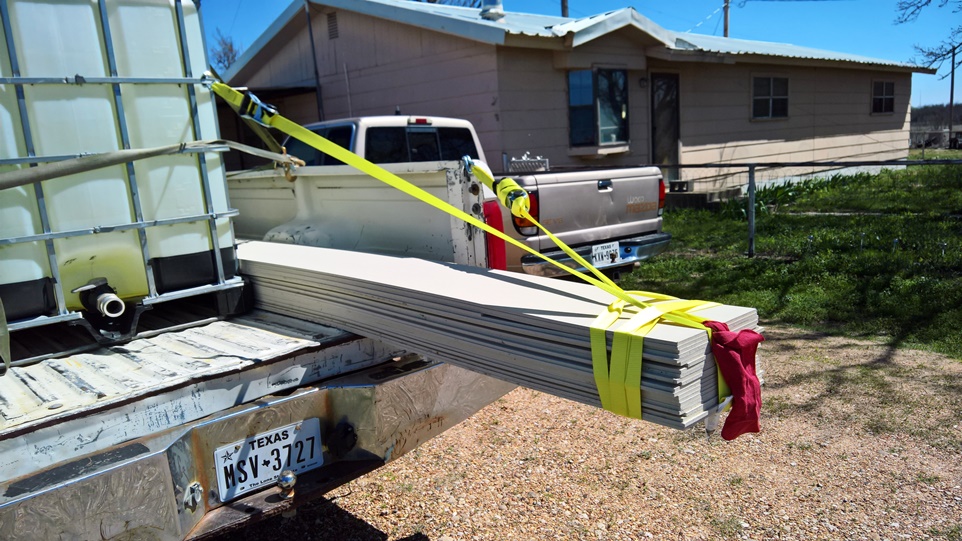

For whatever reason my wife and I needed to drive to the next small town over which is about 45 miles away. I had planned on conducting our business there then drive to yet another town where there happens to be a lumber yard that I had called and found out they had the size and type of siding that we have on our house. We were going to select it then arrange for it to be delivered since I hadn't brought one of my trailers and the materials they had was in 16 ft lengths. Out of a whim my wife said lets check the small lumber yard here in this town and see what they have.

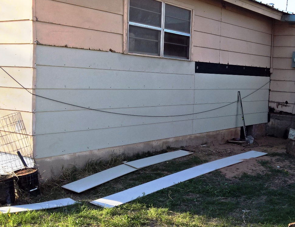

Yes but not the siding I was going to buy, what I was going to drive to Stamford for was Masonite siding the same that is on the house that is weathered away after 50 years this stuff in the back of the truck is that John Hardy plank siding made with cement it is fire proof rot and mildew prof wind proof if installed correctly and almost Hail prof from the largest hail this stuff is 3 times as expensive as Masonite and I got it for almost what it would have costs us for the Masonite plus we didn't have to drive another 40 miles one way.

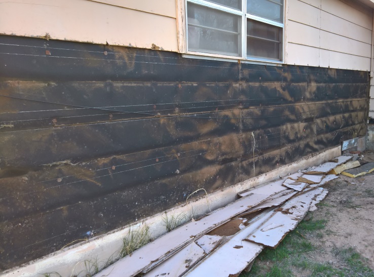

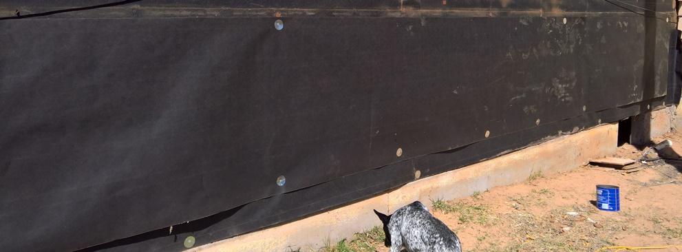

I added 3 more layers of tar paper to the layer that was already there. WHY? because I have rolls upon rolls of tar paper so why not.
Attachment 34198
I only did the wall up to the window even though it really needs to be done all the way up but I have another wall in bad shape I want to repair first
