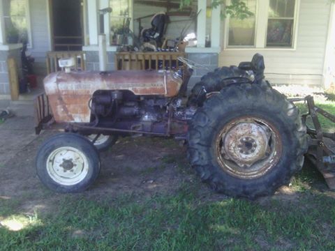

I love working on old trucks cars motorcycles and tractors. I also like building things from junk just laying around I have built a lot of things that never existed before. But I never took pictures. I just moved out to my new home I have not had the money to build me a new shop yet. soon as I do I will start building again I'm sure I will find lots of things on here that will help me with my projects.Attachment 12471 I just repaired this tractor I have had about 15 years it got to where it would not lift anymore everybody said pump or valve body I took it down to the pump. was going to blow out the hydraulic lines and found a hole in the main line I welded it up now its good as new. its a good thing I like to do things my own way or I would have spent $400 for a new pump and would have still had the same problem anyway I'm glad I found this site I think it will be very useful
