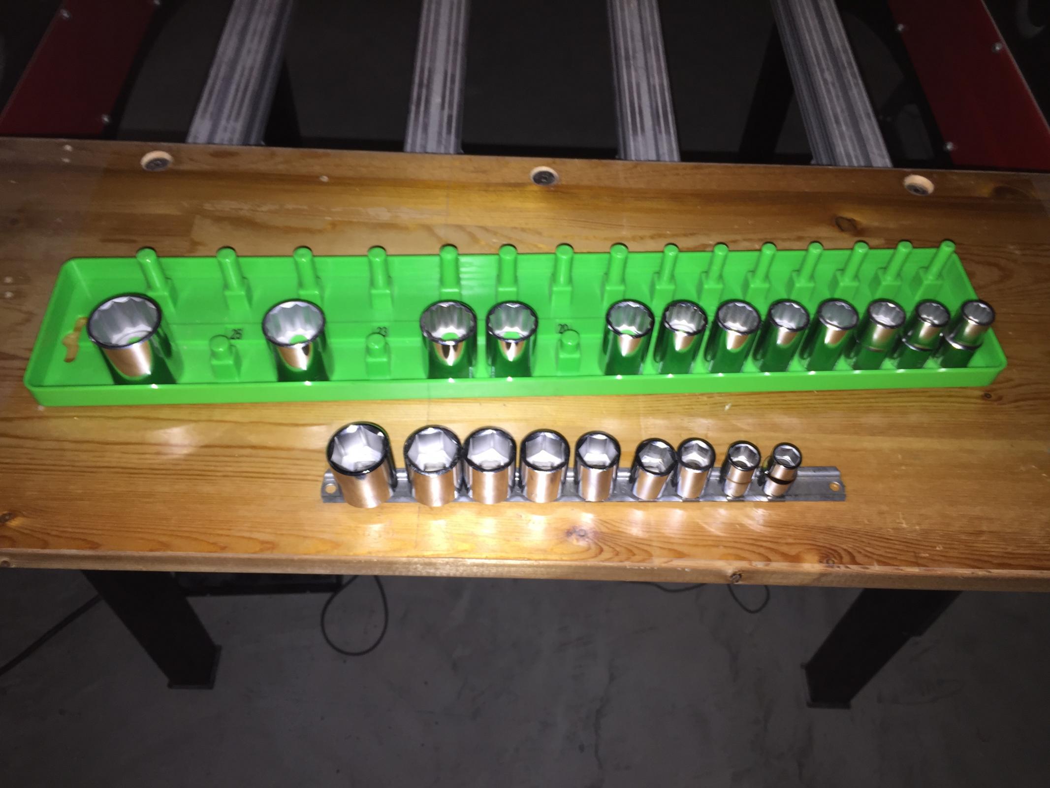

    The space in most of our tool boxes is limited. Socket clips are a pain when it comes to removing sockets. Commercial socket organizers take up too much space and often have pegs for sockets we don't have or need.

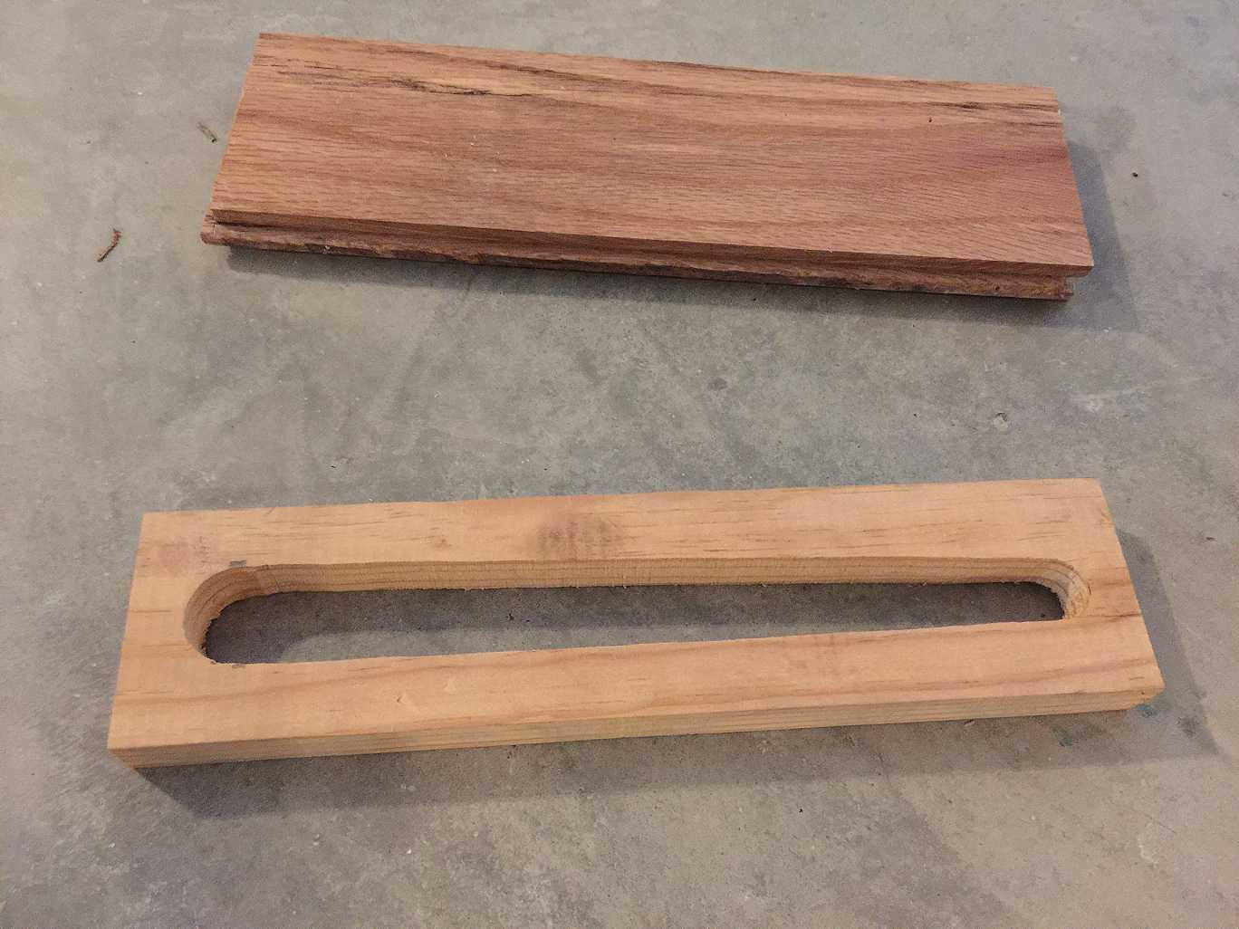

    I am dealing with this problem by making my own socket organizers out of some pieces of scrap hardwood floor I have on hand. I lined up all the sockets on a bench, measured the length of the row, and measured the largest and smallest sockets. Drilled large and small holes at the ends, and cut between them with a bandsaw. Then glued the blade gap shut.

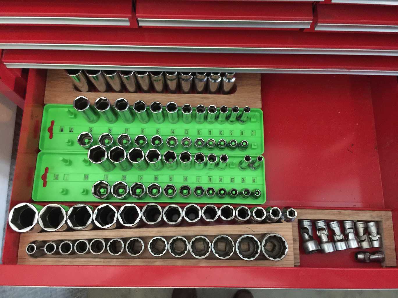

    The photos show the difference in drawer space required for regular vs. home made socket organizers. Due to the drawer height, I didn't put a base under the wooden racks to lift them out, but you could.
    Most of us can recognize a socket size by looking at it and don't need labels. Just use different racks for inch and metric.
    Improved Socket Organizers for Your Tool Chest for Free!-socket1.jpg Improved Socket Organizers for Your Tool Chest for Free!-socket2.jpg Improved Socket Organizers for Your Tool Chest for Free!-socket3.jpg

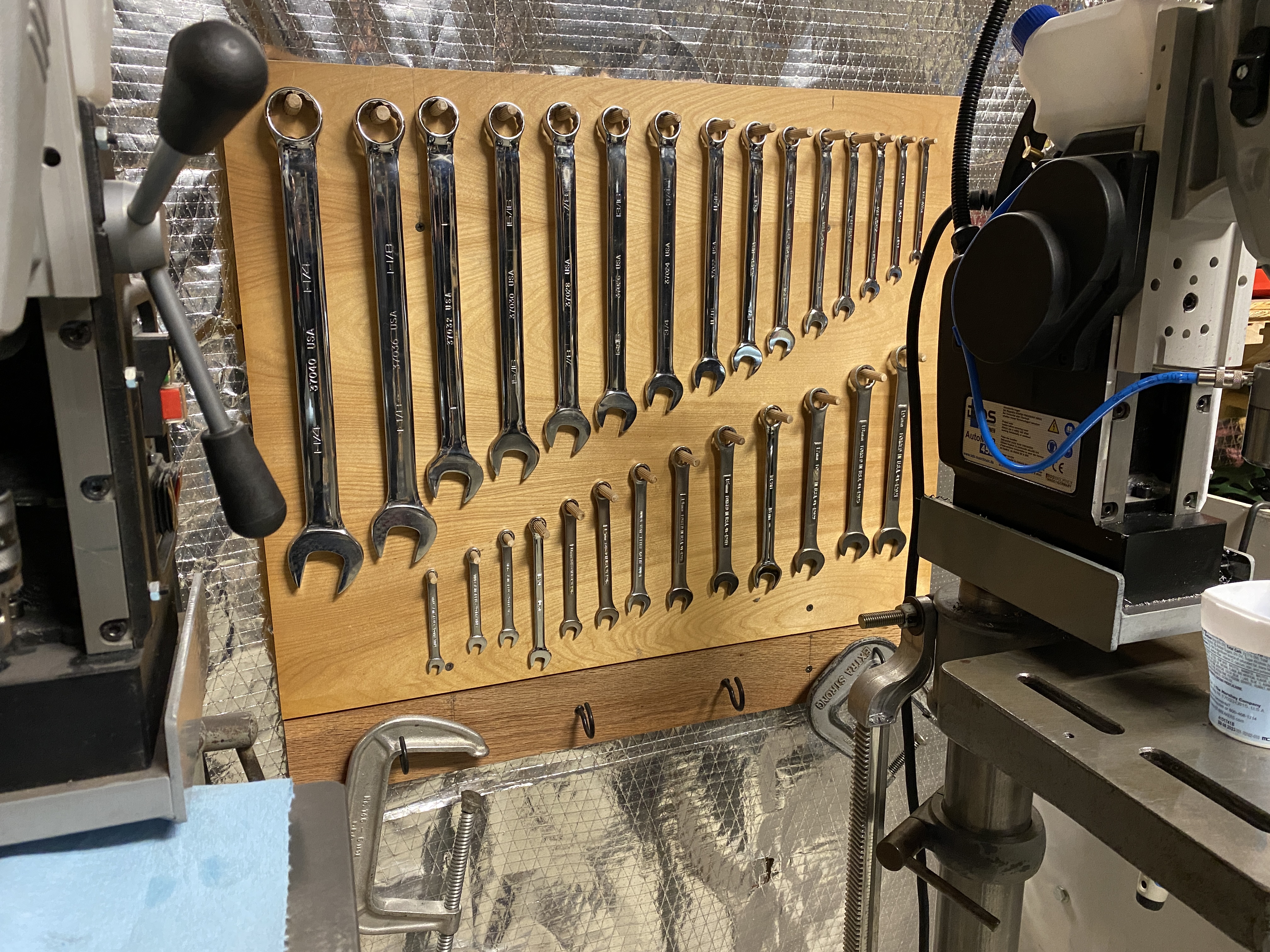

    I try to keep at least one set of every size wrench where I can find them without having to paw through multiple tool boxes.
    Top is Imperial (inch), bottom is metric. Big wrenches are in drawers, as they take up too much wall space.
