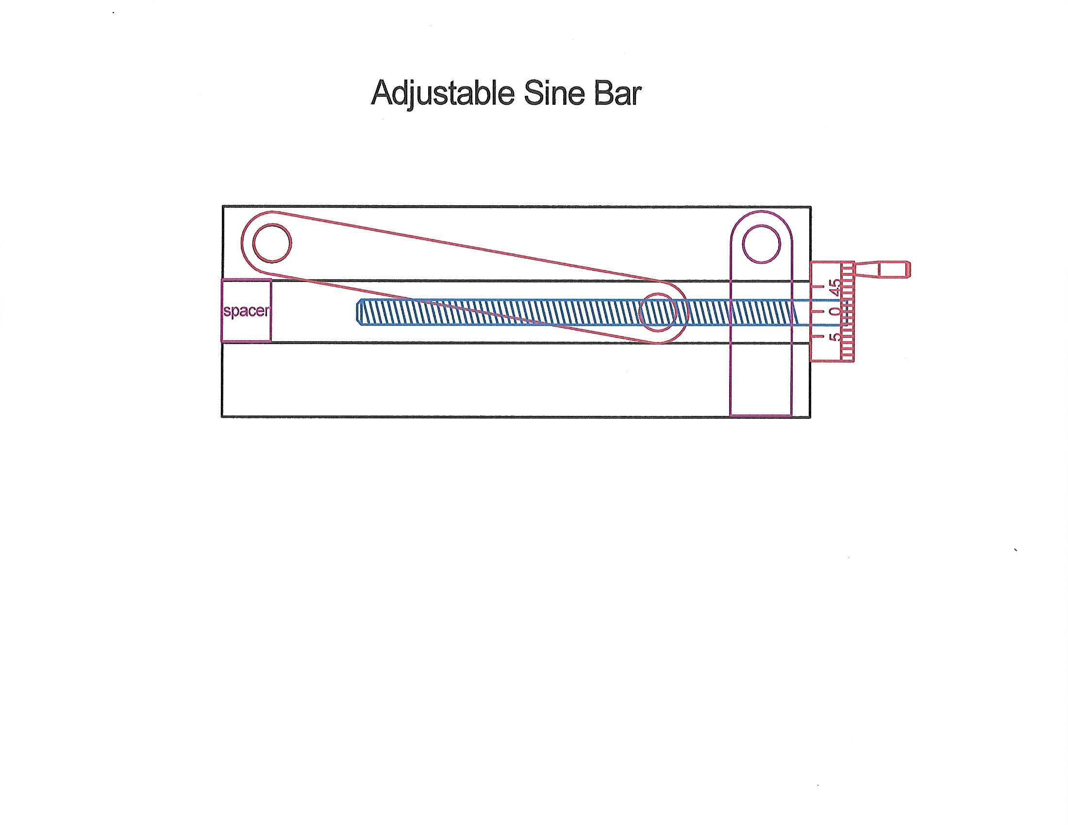

This post is more in the nature of a solution looking for a problem. For a long time I've been noodling how to build a tangent bar, an angle setting tool that would, like the sine bar, convert a linear measurement into an accurate angle. The advantage of such a device over the conventional sine bar would be the fact that it could, hopefully, incorporate a bar moved by a precision screw to replace the block stack of the sine bar. This would make it a self-contained instrument without the need for an external height setting mechanism as is the case with the sine bar.
I'm sad to report that so far I haven't pictured a design that didn't have some flaw that would tragically affect its accuracy. However, while rehashing the problem in the shower, I did have an idea - the one presented here - that might have some utility for someone.
