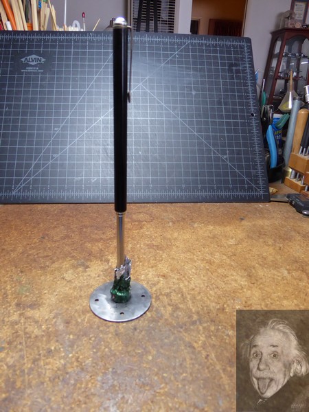

Making new tools is good exercise for creativity skills. Improvising tools from available materials can be equally educational - and entertaining as well.
My wife has a cake transporter - effectively a large plastic dome-like shape that attaches, via clamps, to a tray that serves as the base for the cake. She wanted to know how tall a cake she could carry in it.
After some mental design work with combinations of yard sticks and tape measures I hit on a much simpler method. I stuck a telescoping pocket magnet to a steel disk and set this upright on the transporter base with it extended to a length greater than the height of the cover. Then it was simply a matter of putting the cover on the transporter, thus compacting the magnet. Remove magnet and measure comfortably with a ruler.
Attachment 40738
Well, that's thinkin' with your telescoping pocket magnet! Now, we know why she married you!
Thanks mklotz! We've added your Cake Transporter Height Gauge to our Measuring and Marking category,
as well as to your builder page: mklotz's Homemade Tools. Your receipt:
