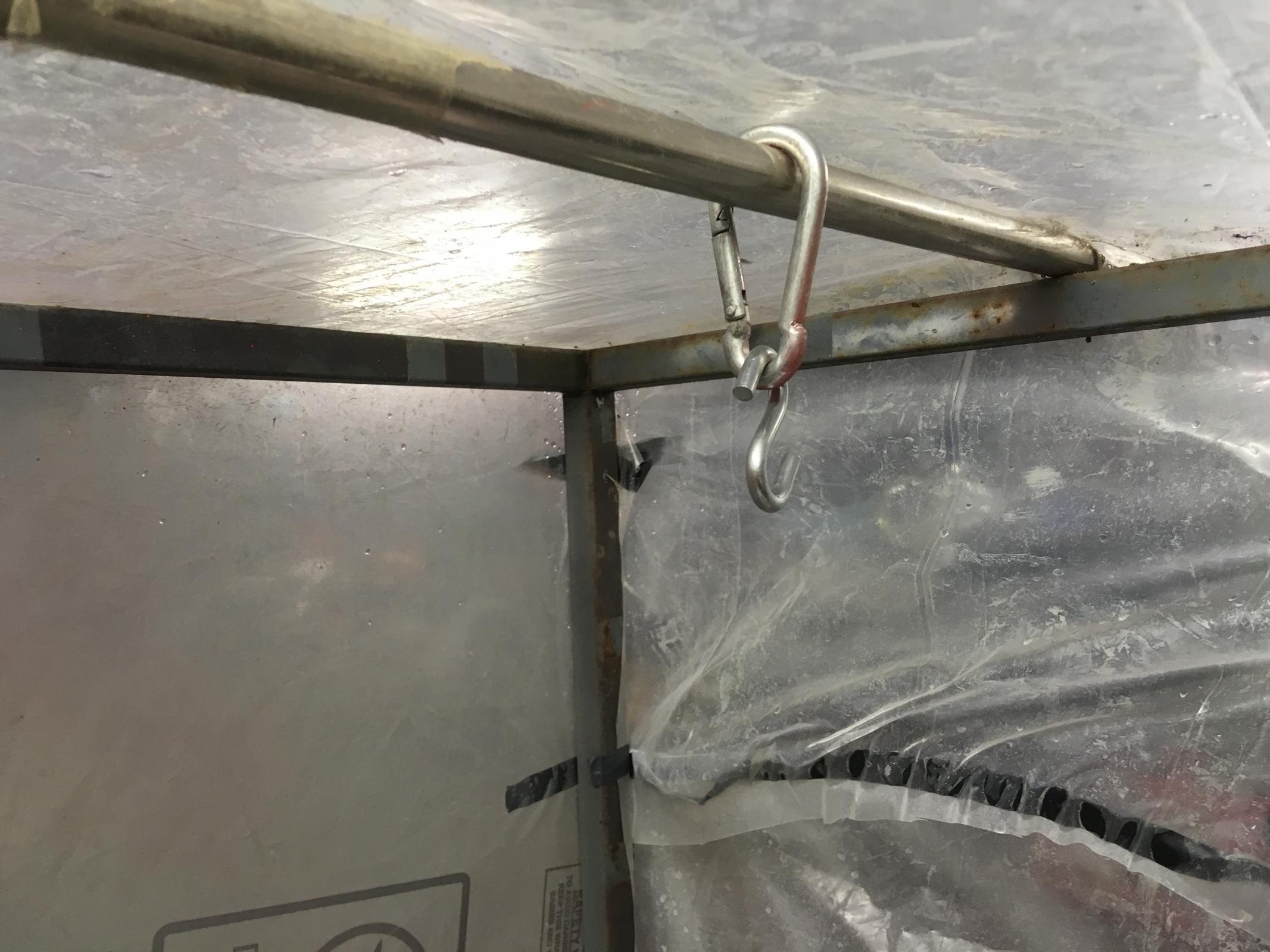

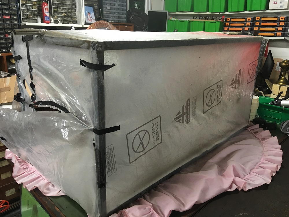

I have used this spray booth for many years (I use the term spray booth loosely)
Attachment 31518
Basically a speedy frame cover in plastic. I did plan on cladding in thin aluminium and putting an extract fan and possibly a integral light. But 10 years later it keeps getting recovered in plastic and kept outside in all weathers when not required in the workshop. The booth is a good size and it does stop over spray covering the workshop.

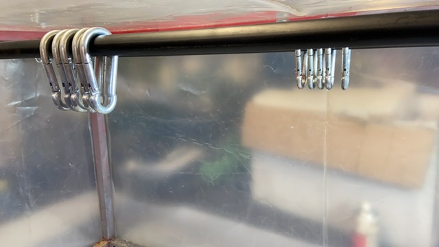

I also place a tube across the top to hang components which is very convenient from carabiner snap hooks and "S" hooks.

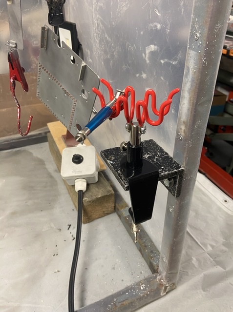

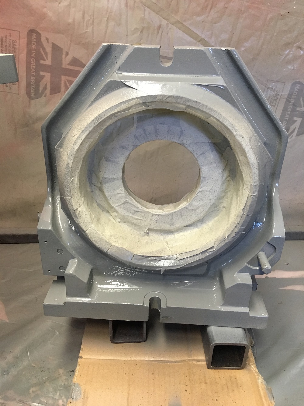

When painting large heavy items which are to heavy to hang up I use a rotary positioning table in the booth. This enables me to rotate components 360 degrees. The positioning table is positioned under the cardboard to protect it from over spray.

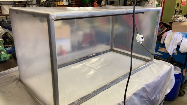

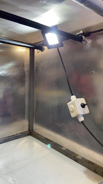

Hi All

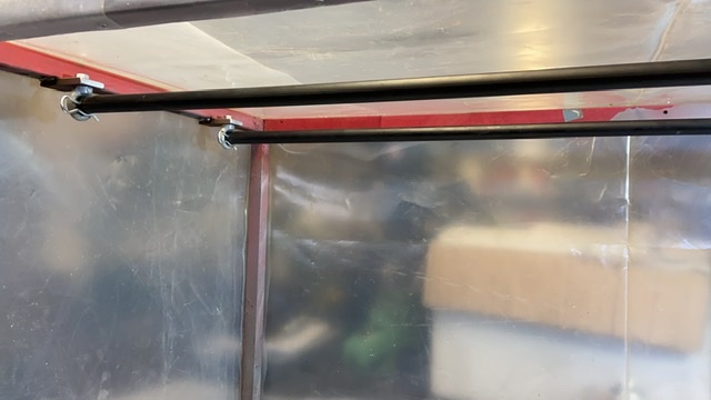

Today spent some time sorting my poor mans spray booth. I decided to replace the plastic sheeting and pop rivet rather than use gaffer tape. I also welded 4 brackets to support to hanging rails. The portable light also makes a big difference to the booth.
Attachment 34180
Attachment 34184
Attachment 34185
Attachment 34186
just need to find a suitable extractor fan.
All ready to paint the traction engine
Thank you for viewing
