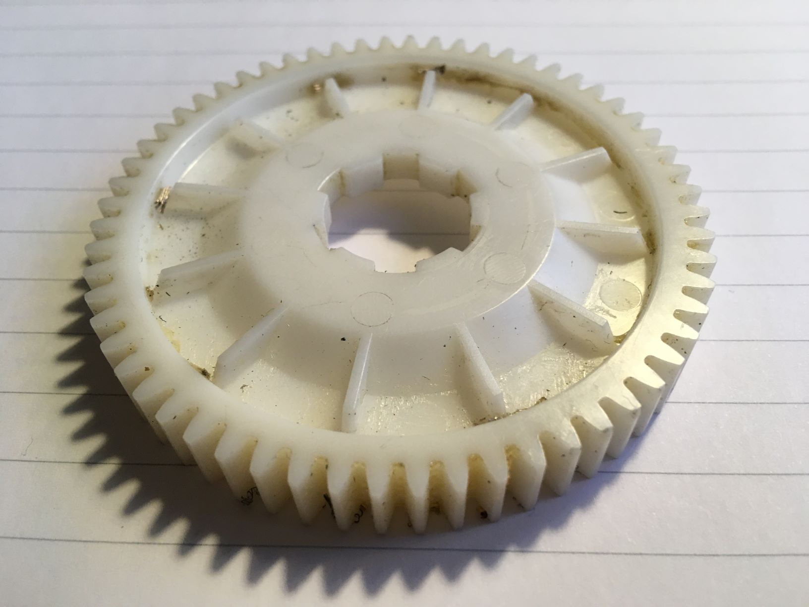

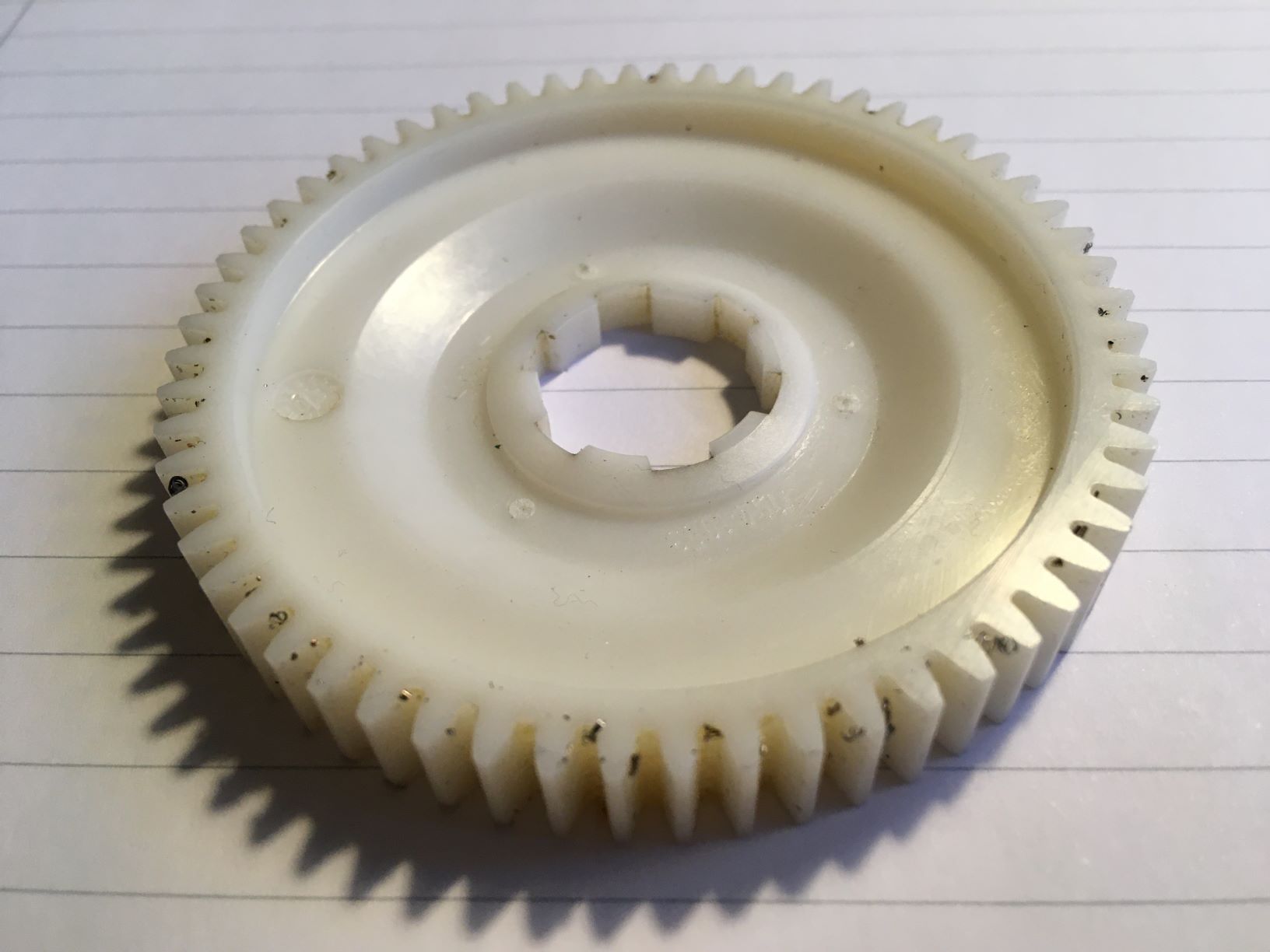

but when I finally found a few used 60 tooth 1.25 Mod 10 mm wide Delrin gears, I was off for a good start,
as you easily divide by 2, 3, 4, 5, 6, 10, 12, 15, 30, and 60 (and with a "forked" plunger even 8, 24 & 40 too).
Attachment 38616 Attachment 38624

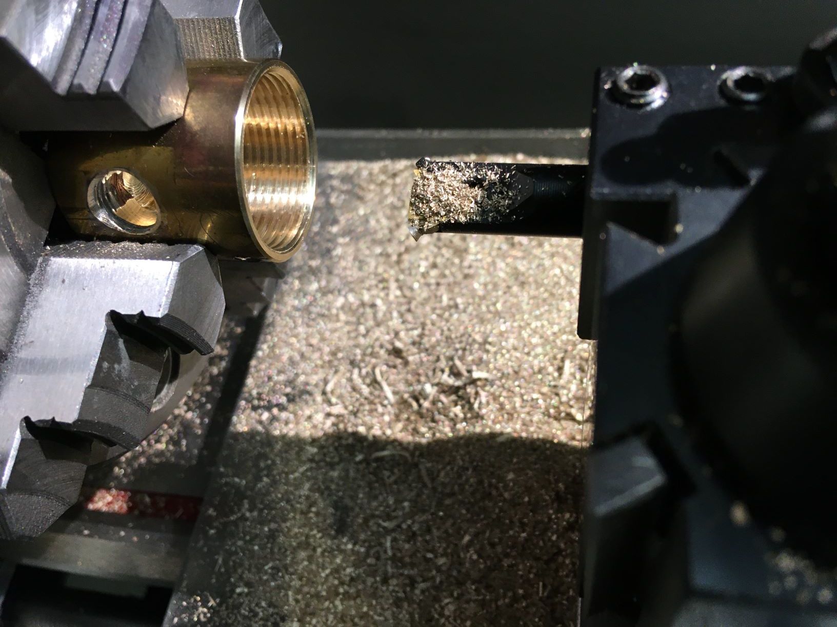

Odd thing with my particular 7 x 14" is that both its 20 mm spindle bore and the M27 x 1.5 outer thread is non-concentric by +/- 0.2 mm,
which I already noticed when making an expanding mandrel hand crank a few years back.
First is to get some sort of spindle thread adapter going, using a piece of 30 mm brass from a 3-armed lamp holder:
Attachment 38615
Tightly putting it on the spindle thread, indicating its awful wiggle, then chucking it with padding and skimming the surfaces,
it was finally true to the spindle center.

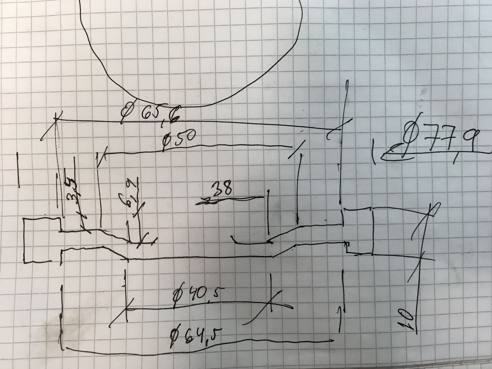

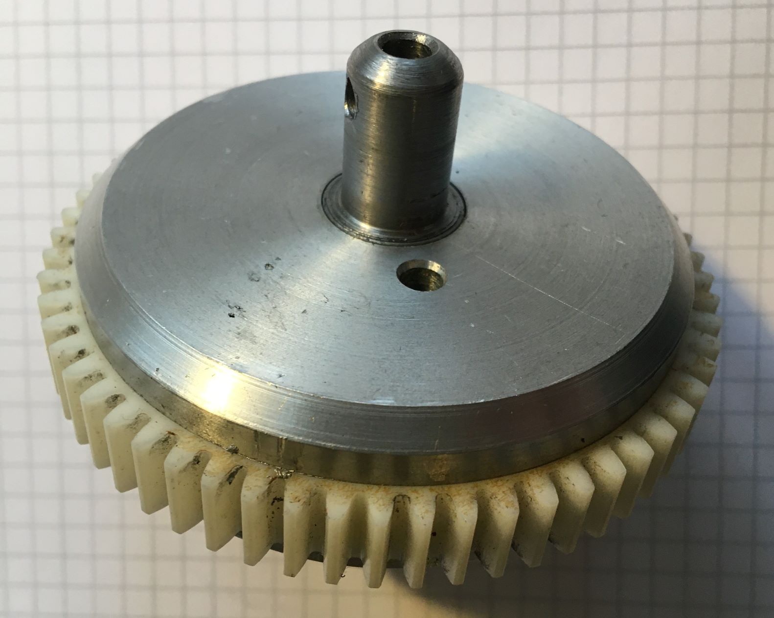

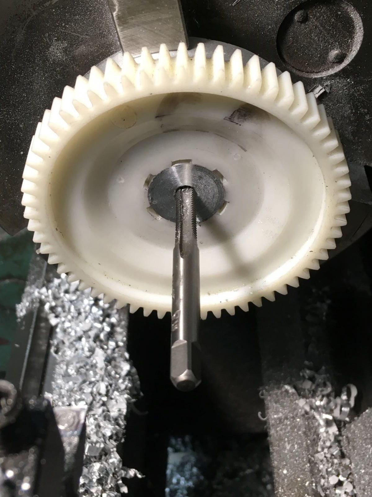

The plastic gear wasn't of the massive type either, so I had to turn a hub from this non-CAD sketch:
Attachment 38617

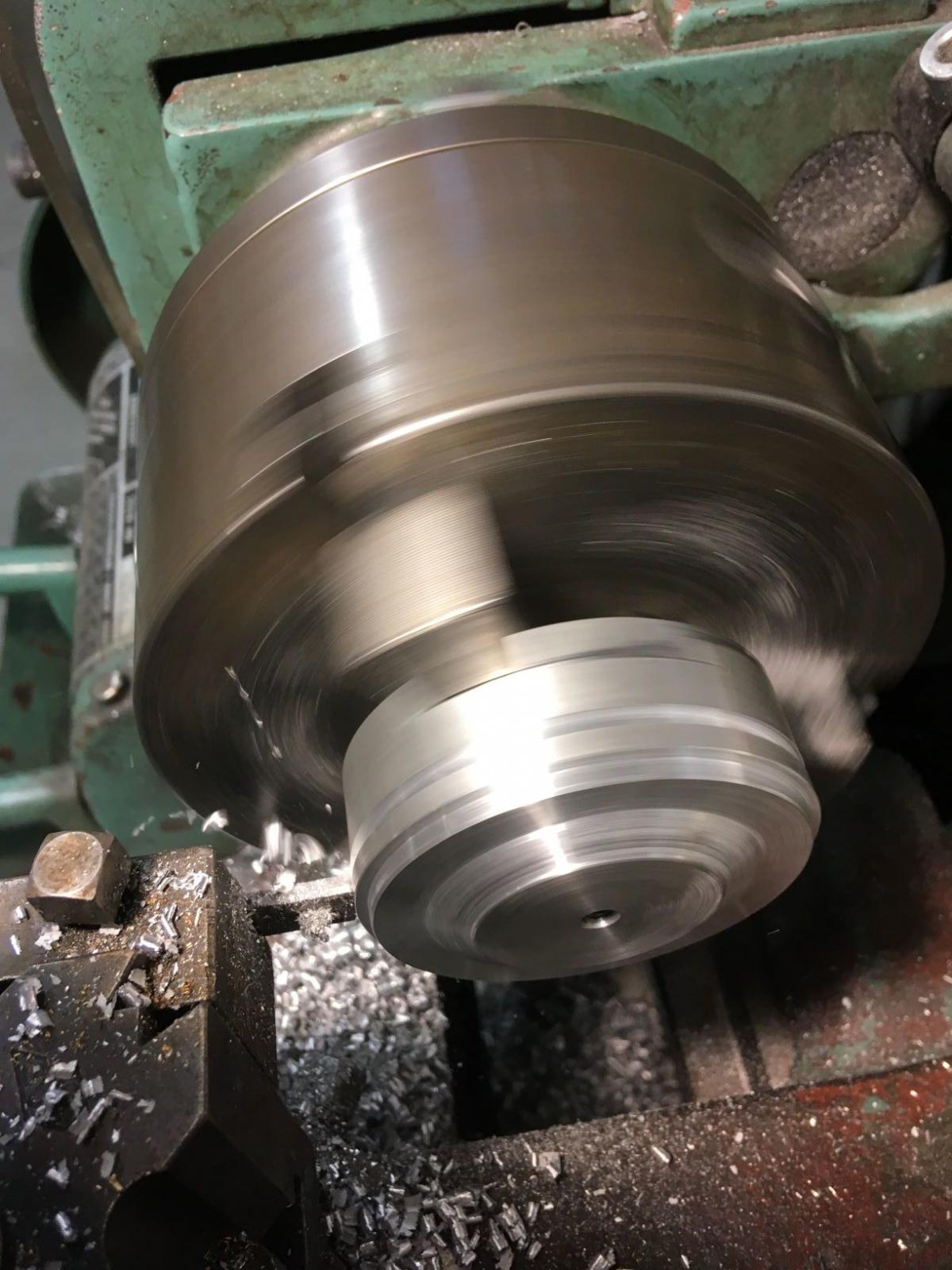

Turning some pretty bad 70 mm AlSi9Cu3Fe stock I made a few years back to a hub for the gear, threading the hub cap,
Attachment 38618 Attachment 38619

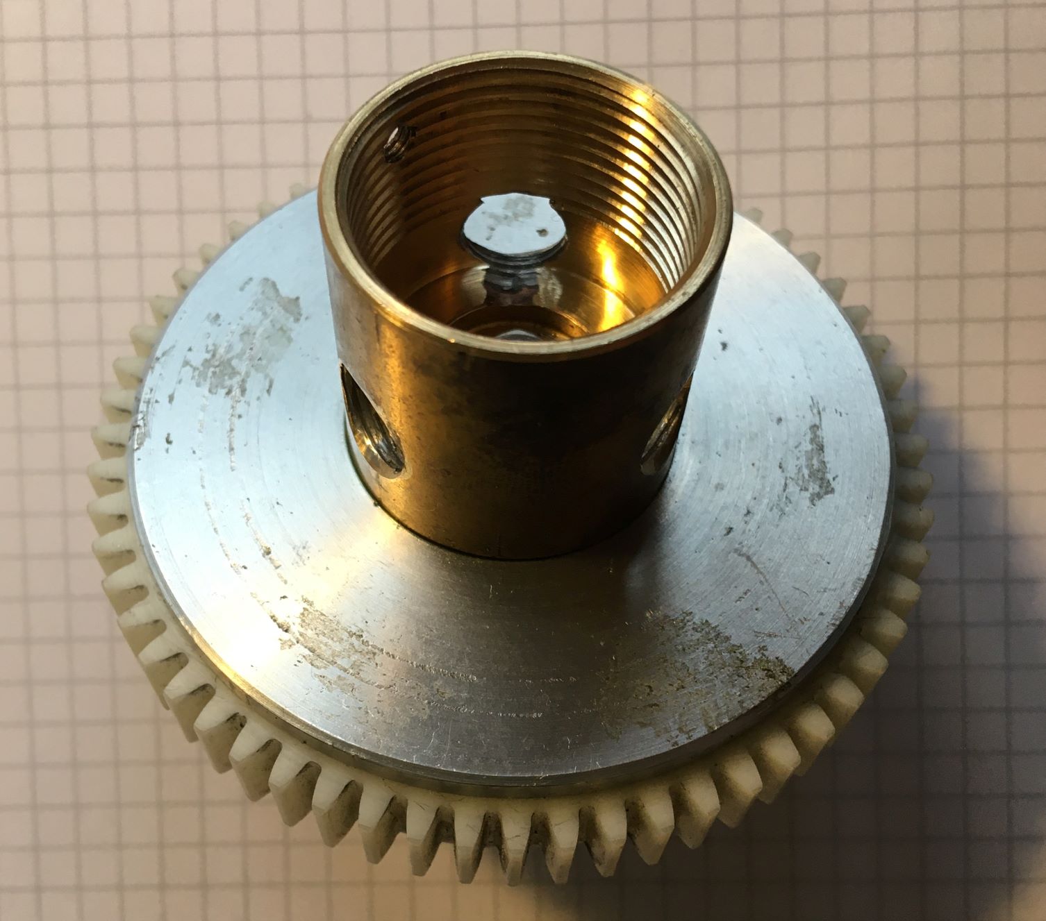

then smacking the whole shebang together with Loctite and a cylindrical nut (with provision for the handle):
Attachment 38620 Attachment 38621

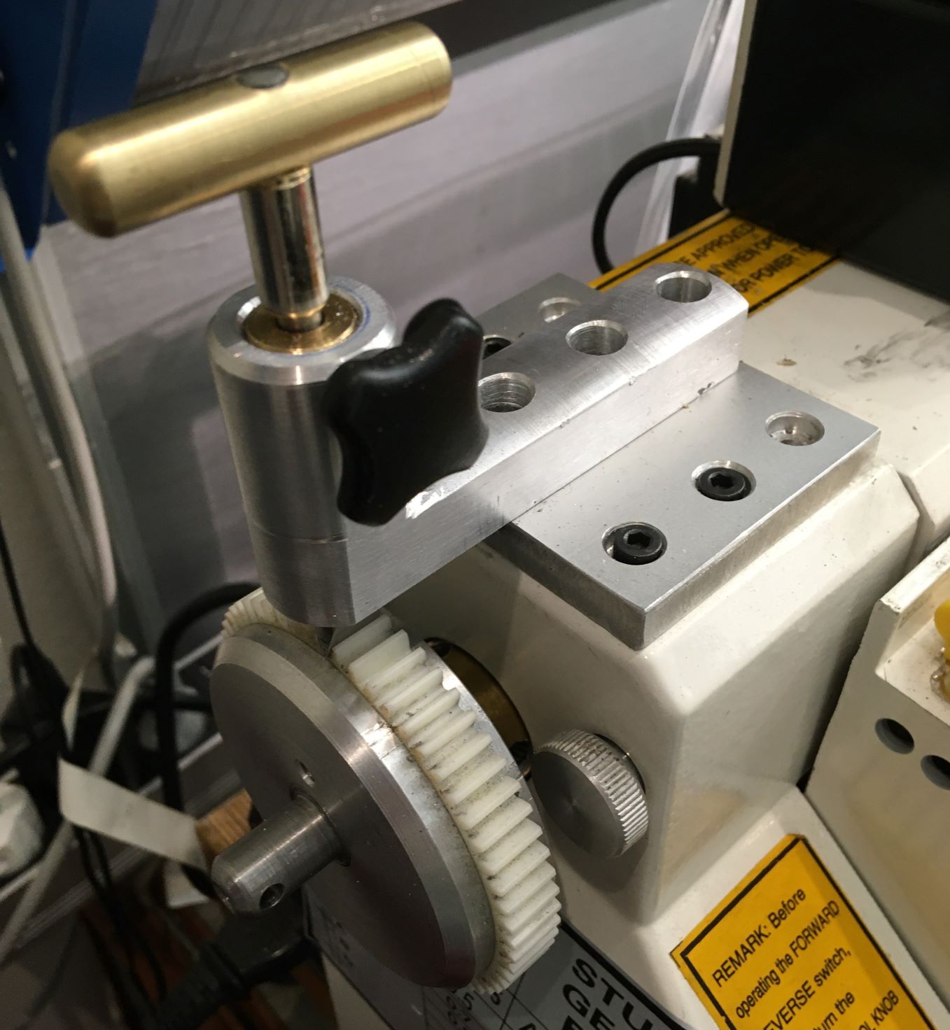

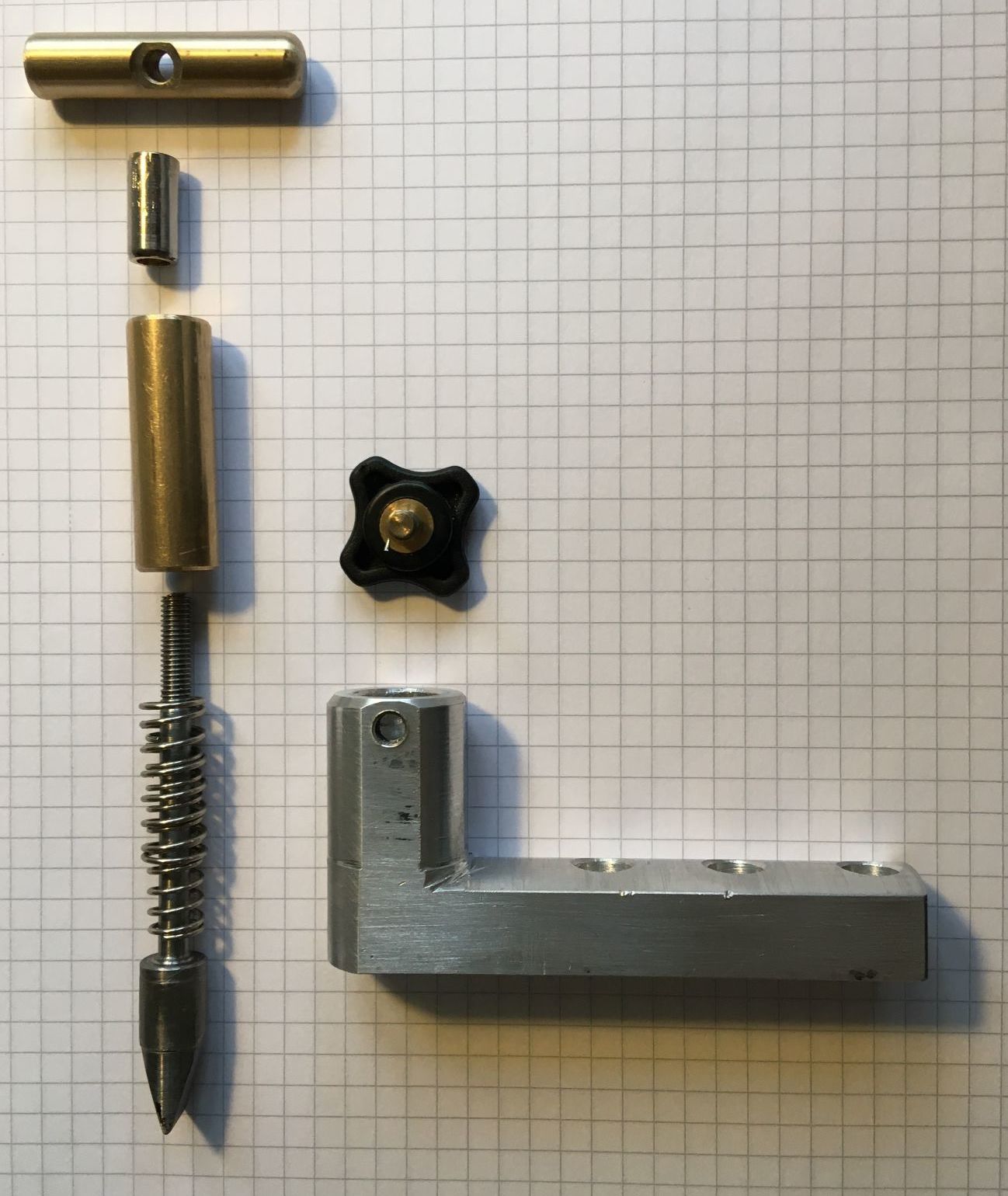

Next was the plunger and holder, which was cobbled together from 20 mm Al plate,
some 10 mm mild steel stock turned, tapped M5, and ground to a 20 deg chisel tip
and some brass from discarded hi-amp electrical plugs providing the holder sleeve and handle:
Attachment 38622 Attachment 38623

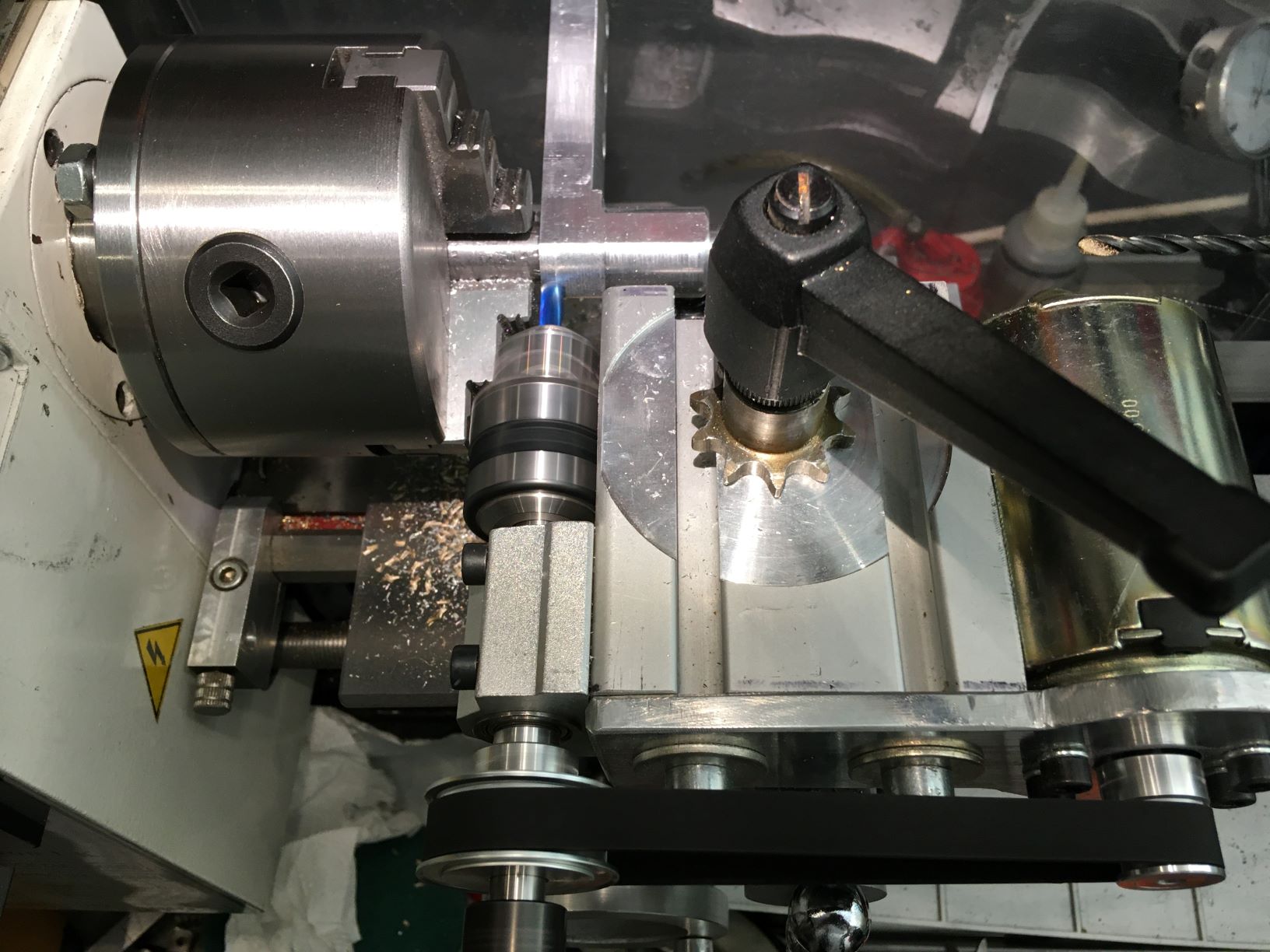

Bolted the holder on the change gear cover with 3 M4 bolts, the small knob providing a quick insert/release of the whole plunger assembly
(indexing gear wheel easily turned off from the spindle by a screwdriver thru any 2 of the 3 holes remaining from the lamp arms...):
Attachment 38625

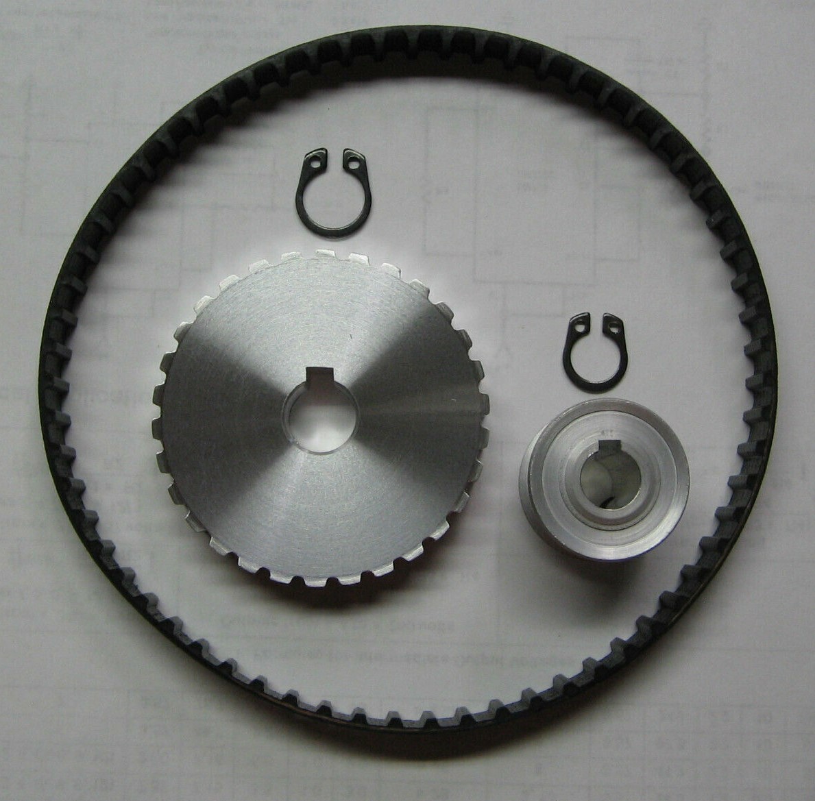

New drive pulleys for the 7 x 14": 30 & 10 tooth and a 210 XL 037 belt.
Lowered max revs, but higher bottom torque...
