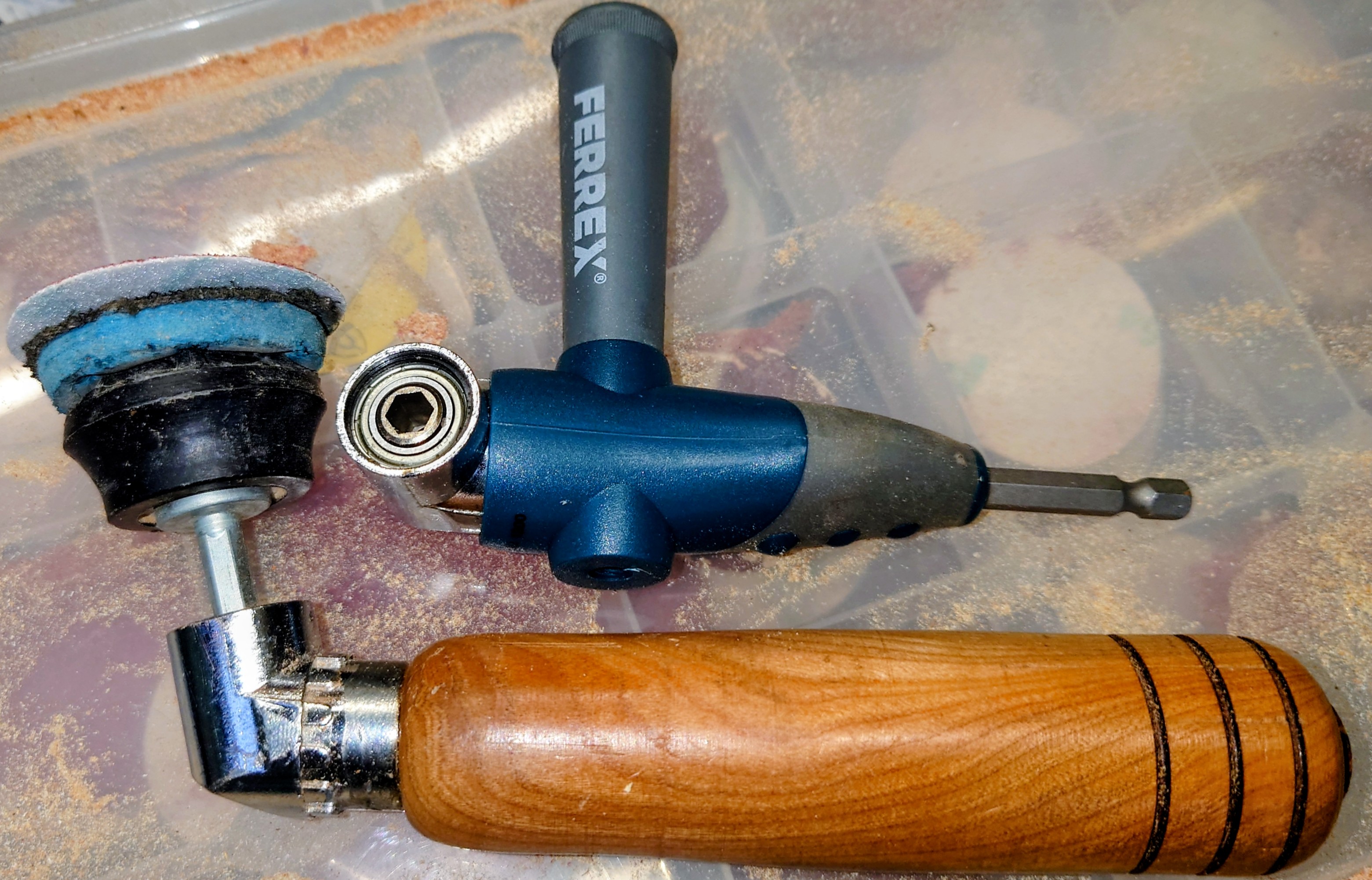

There are a number of commercial versions, though I like Tomislav's home made design I made mine using an angle drive adapter for a fraction of the commercial versions price, and it has ball bearings so it turns freely. It certainly has improved my surface finishing on
turned wood.
Attachment 50309 My version, and the angle adapter I used.
