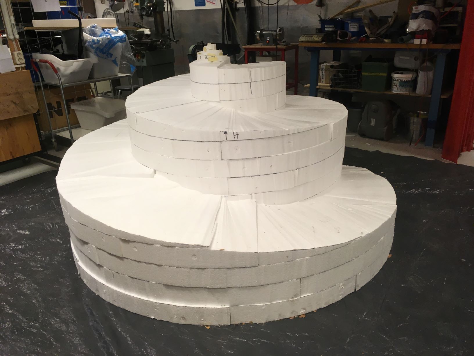

It's all in a (few) day's work: A Stage Design BA student at work comes up with yet another New & Creative Idea,
and a rough scale 1:10, 8" dia model: "Low Rent Tatlin's Tower 2.0" I smugly think.
Attachment 30010

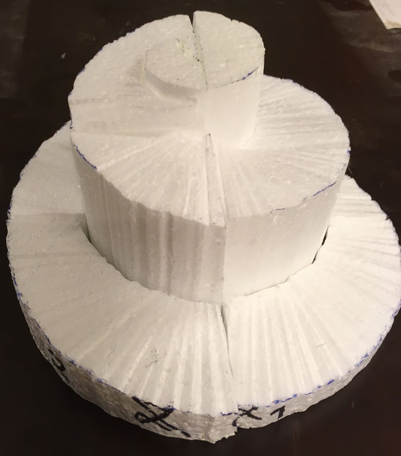

Generously given 6 cubic metres of 4 x 2 ft x 4" thick and luxurious EPS blocks, and this easy-how-to from the Artist:
"-How hard is that? Isn't it just gluing them together and cut away everything that shant be there?"
-Eeee-Right!
So: -After a few tests, realizing my old frames/ wires didn't really made the cut (-Yuk, yuk) to take this job on,

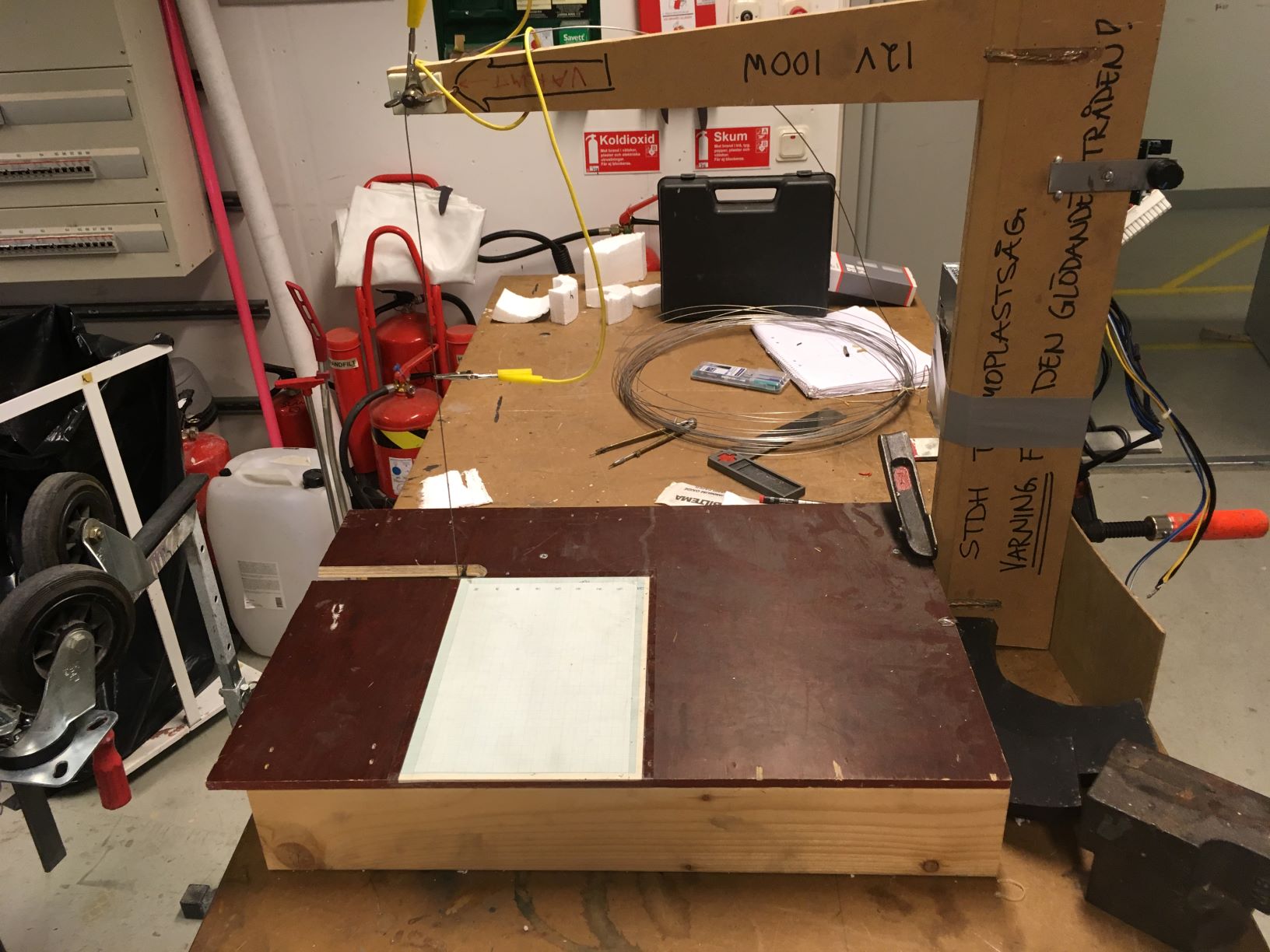

Method: Use the vertical wire cutter, by throwing in an 18" piece of 1.2 mm Kanthal A-1 wire,
just lying around waiting to be assembled into a 400 VAC 2 phase Electric Furnace.

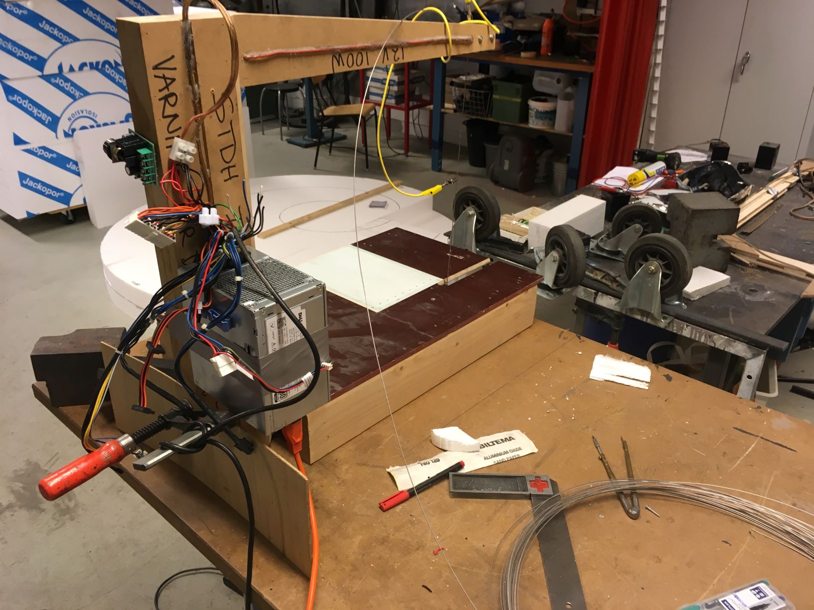

To feed these, I use a few of my salvaged PC & Laptop PSUs of different volts and amps flavors.
The sweet spot for cutting is not having the wire to glow, but just below that point,
so the 18" get fed by an ordinary old ATX PSU, that at 5 volts cranks out enuff amps to feed the 1,28 ohms/m wire.
Attachment 30007 Attachment 30008
That's about 10+ amps, and later a bit more, as I make an alligator jumper cable to slide from the top terminal,
to max the cutting speed, and just use the relevant lower part of the wire (Yellow test cable).
Also fit a foot operated on-off switch to keep my hands free for steering.
The horizontal cutter is also made from glamorous MDF, and a triangular spring thingy to keep the wire taut.

Fed by an old Dell DA-2 12VDC "Power Brick" this pulls some 10 amps of the available 18.
Though also remotely controllable, I don't bother to do that with the brick - just hook up and go, as I'm in a hurry.
All DC power cables are recycled old, 12 or 14 AWG loudspeaker cable,
and the wire's heat-proof terminals are salvaged from scrapped 5 kW flood lights.
Everything just merely holding together by screws, clamps, stage tape, hot glue -
"only good enuff" to get it done - no time for over-engineering - not today either...

Final results, before covering with glued cloth and final (White- of course!) carpet fitting & LED strips:
Attachment 30009
1 month later, after the show period's over- it'll just be cut up and thrown in the dumpster. "Much ado..."
-Just another day at the job for yours truly: - "Quick, Dirty, Cheap and Operational."

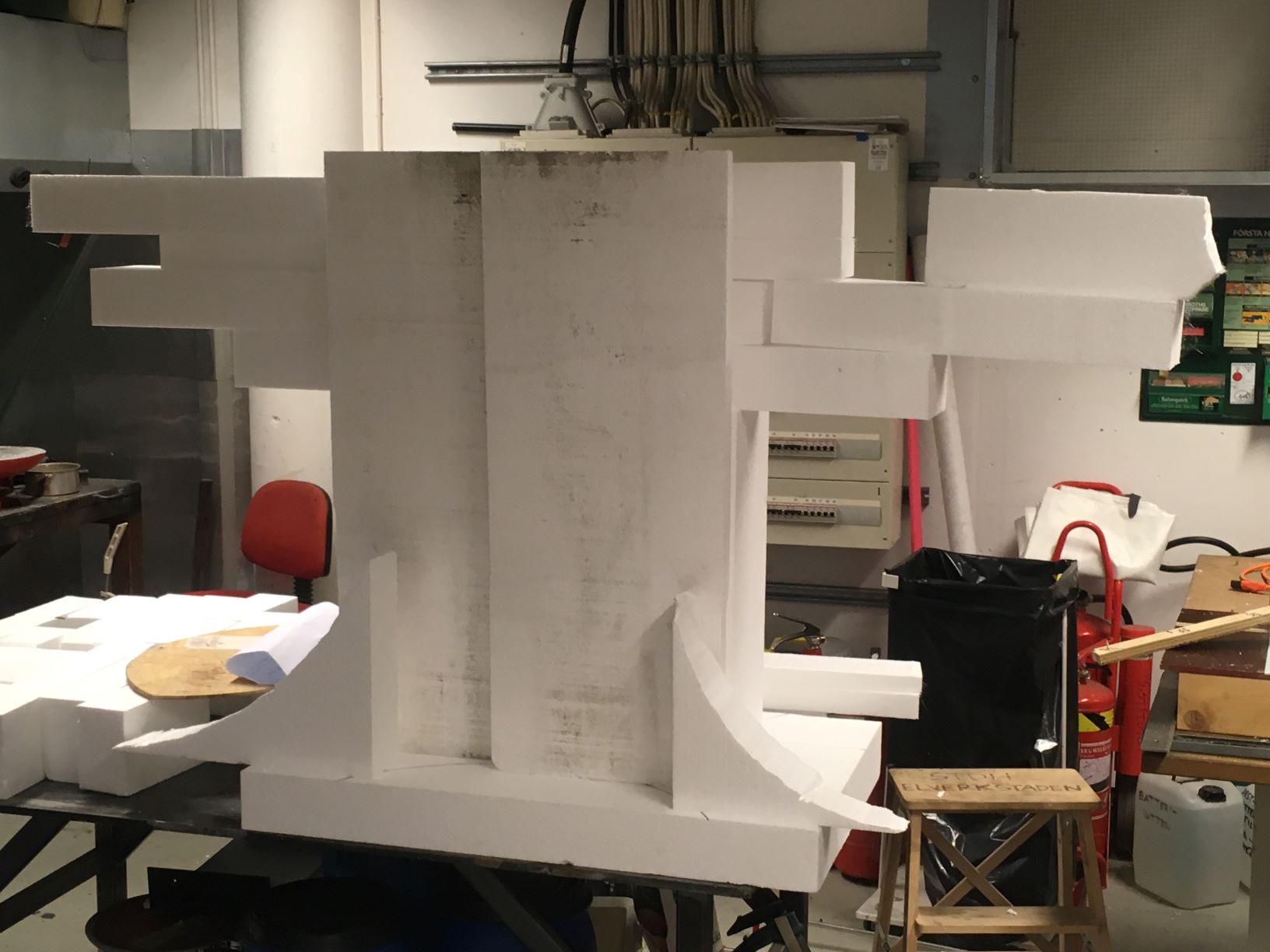

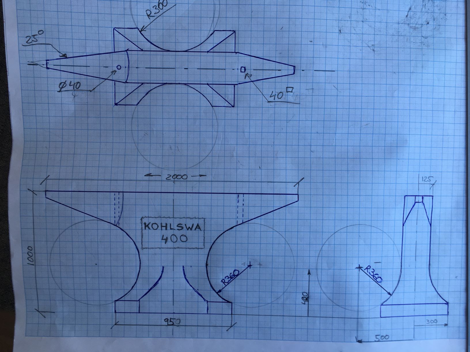

PS: Job only consumed 75 % of the delivered EPS boards - so now I've got the following idea - just for shucks,
using the offcuts for this: painted, rust-stained and weathered, by a thick rope suspended from the ceiling at abt 15 feet up,
A 2 meter long flying anvil with a 2 x 3 feet base - purporting to weigh in at 400 kg:
Attachment 30011 Attachment 30012
