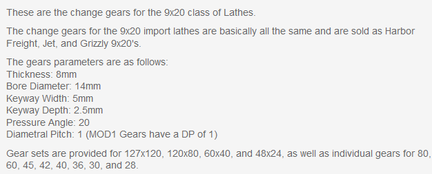

I am looking for the parameters for the involute gear cutter set to make all the gears for the 9x20 lathe?
I think the DP is 1 and the PA is 20 but I cannot verify those numbers? and I cannot find any cutters with those numbers?

Found this, may be of use.
Attachment 20741
Olderdan , Hi I found that one too but can't verify the DP any where else and can't find any cutters to match these numbers? Thanks Cap.
Hi Cap, I think one of us is missing something with this (could be me).
The data you have already states the DP (Diametrical pitch) or module is 1.

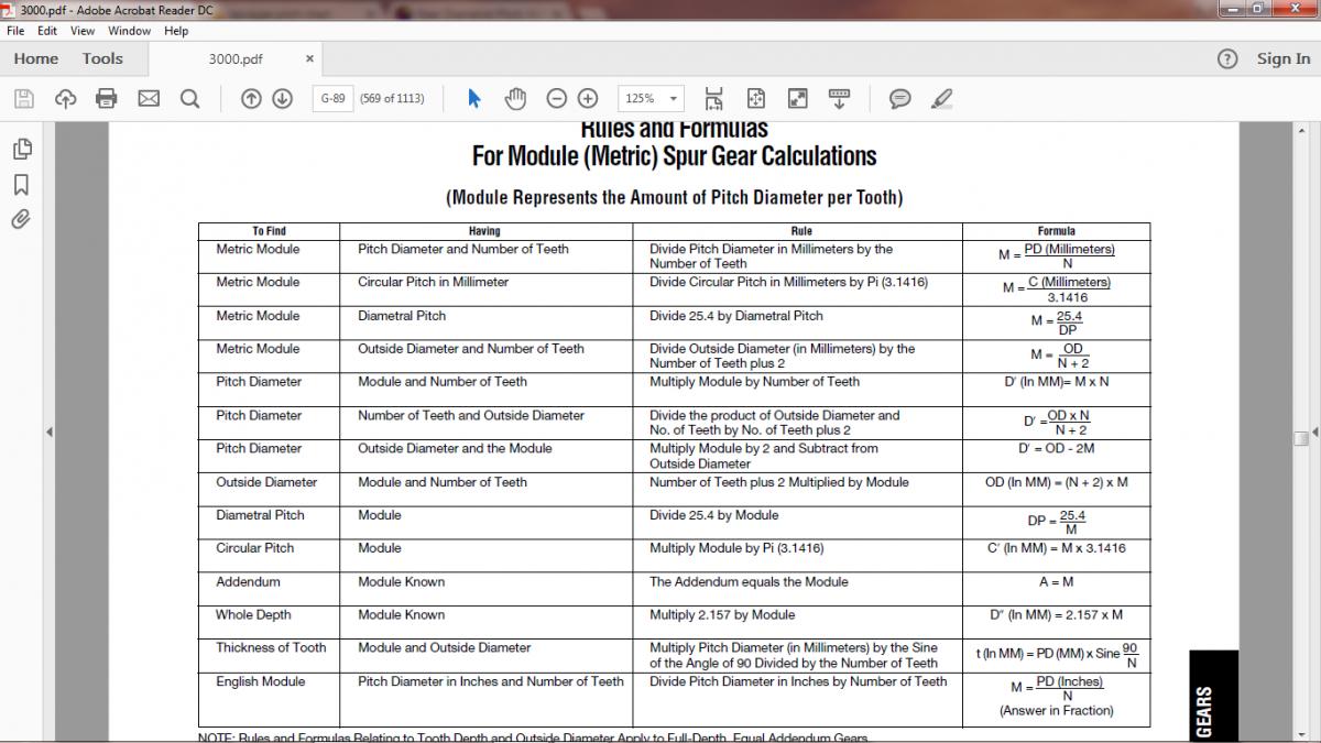

The data I have used for gear cutting is based on these pages
Attachment 20749Attachment 20750

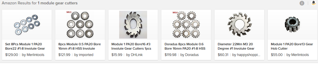

A full set of 8 cutters can be found
Attachment 20751

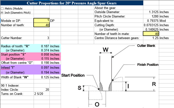

A bit expensive for a one of job, I have a spreadsheet for making your own cutters or a fly cutter or maybe you are hobbing them.
Attachment 20752
Wow Thanks for the info So do you think if I order the gears from amazon they will be the right ones for making all the change gears?
Thanks olderdan.. can anyone else verify making gears with these parameters for the 9x20 lathe??
I would have thought that any import lathe would have had modular pitch not diametrical

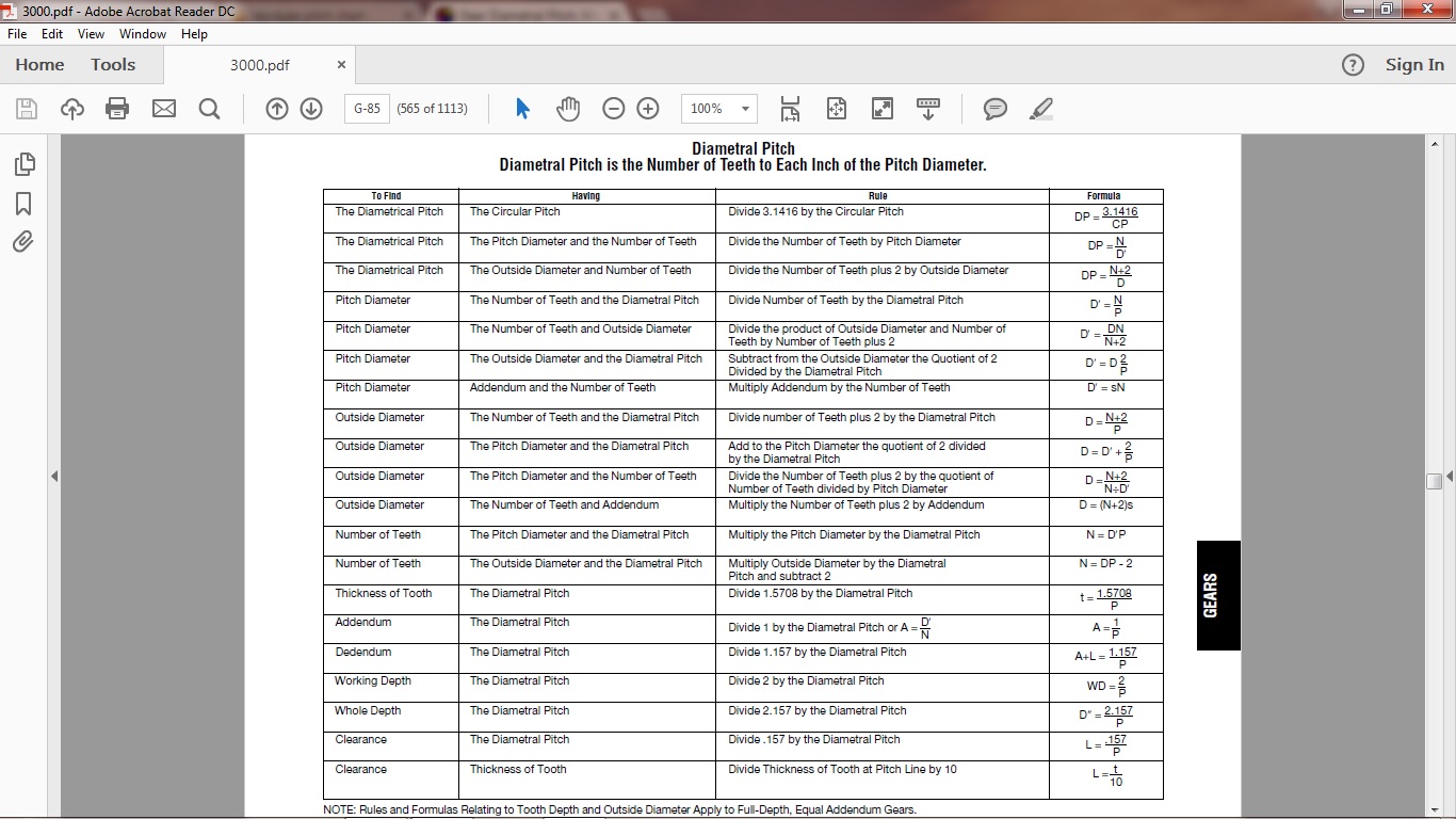

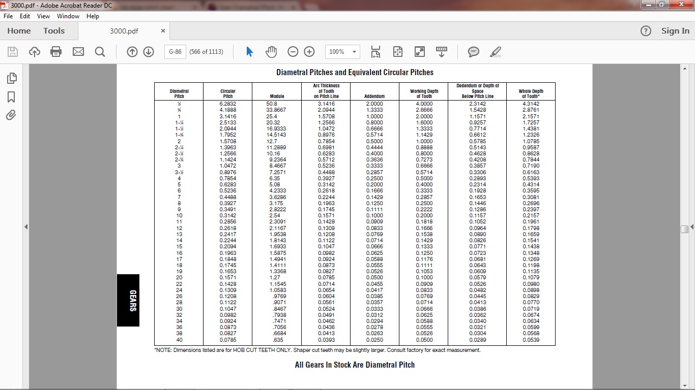

To find what dimetrical pitch you have try this chart
Attachment 20770

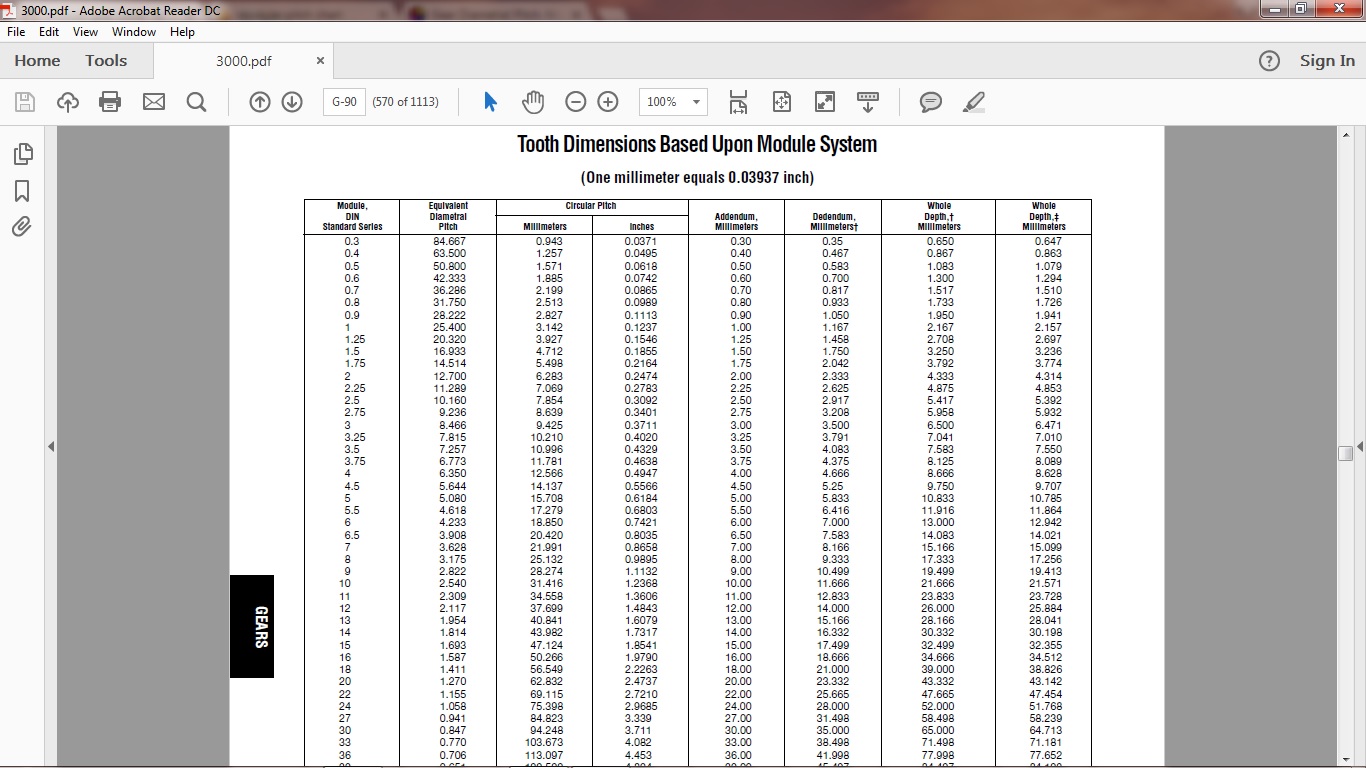

some other useful charts
Attachment 20771
Attachment 20772
Attachment 20773
the charts I posted were screen shots from the Martian Sprocket & gear catalog called the big catalog it can be found here free download but be warned it is 61,387 kb
so it will take some time to download if you have a slow connection mine took about a minute but there are smaller target sections which can be downloaded on the same page these can be found here
