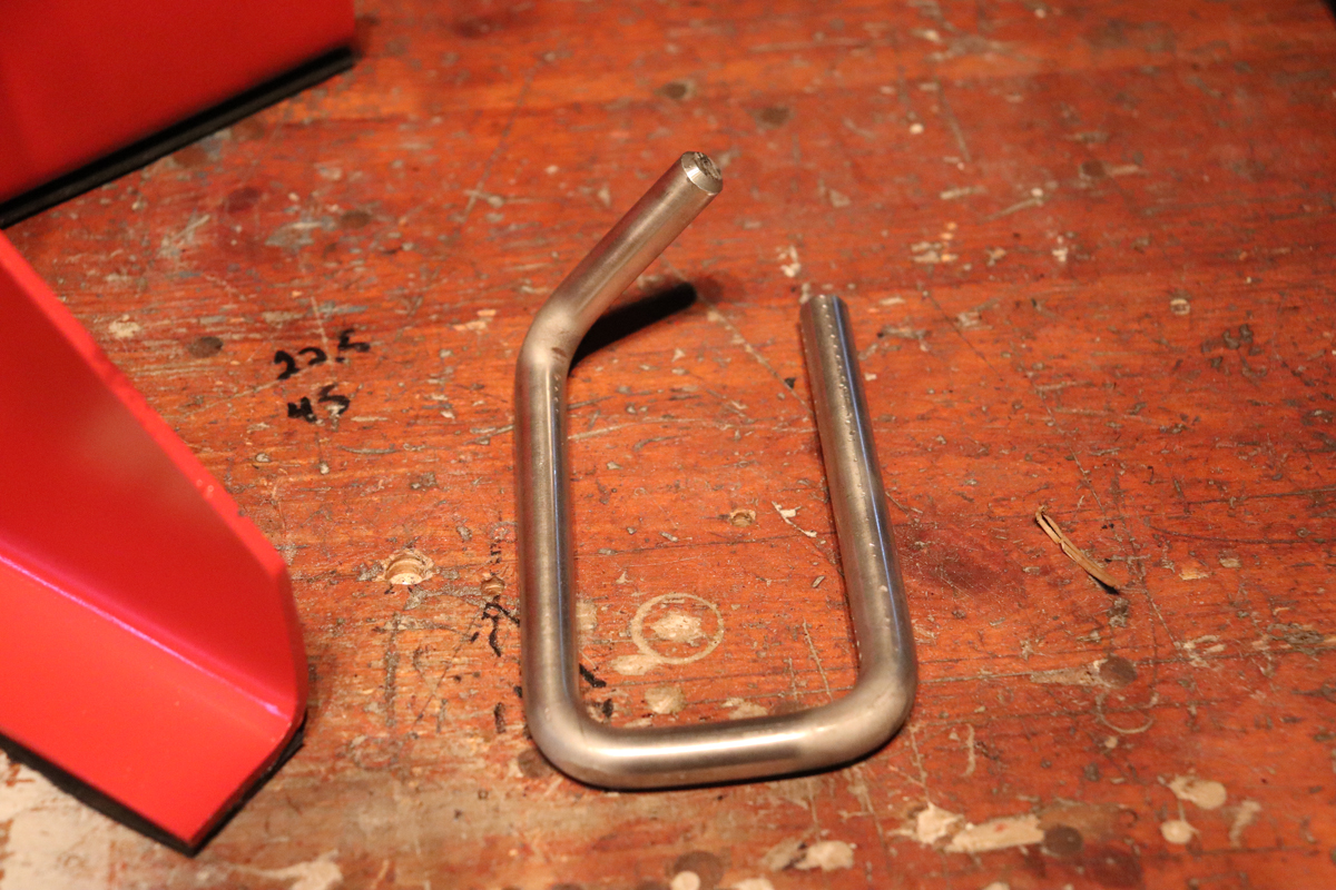

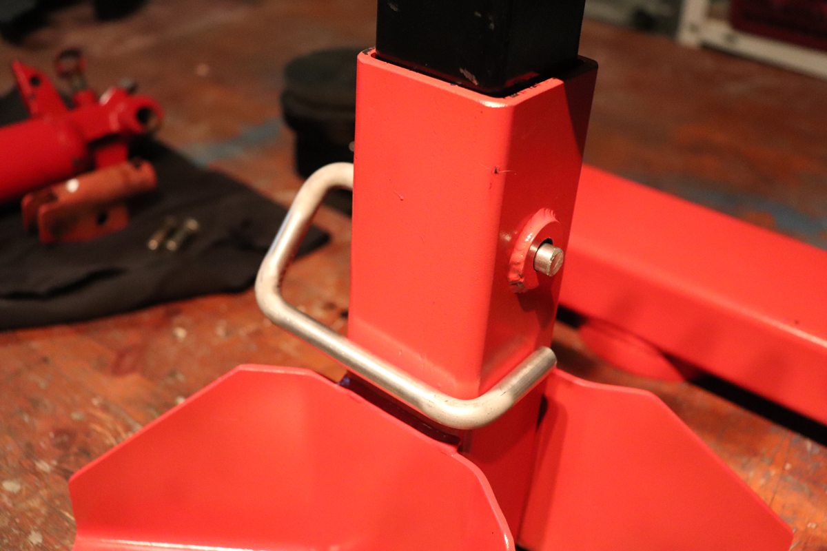

The Harbor Freight jack stands that we've all bought, borrowed or seen in our friends' garages are being recalled due to a risk of collapsing under load. Go check yours immediately.
In a recall filed with the NHTSA on March 20 of this year, Harbor Freight explains that certain 6-ton jack stands have the potential to disengage their support pawl under shifting weight, causing the stand to drop suddenly. A second recall, filed May 3, extends the recall to 3-ton jack stands. The defect is attributed to aging tooling at the factory that produced the jack stands.
Harbor Freight
The recall document says that the problem could affect more than 450,000 6-ton jack stands produced between 2013 and 2019 and nearly 1.3 million 3-ton jack stands produced between 2012 and 2020. These jack stands were sold under the Pittsburg brand name, and can be identified by item numbers 56371 or 61196 on 3-ton models, and 61197 on 6-ton models.
