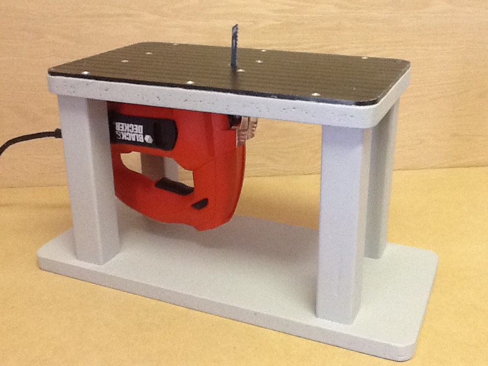

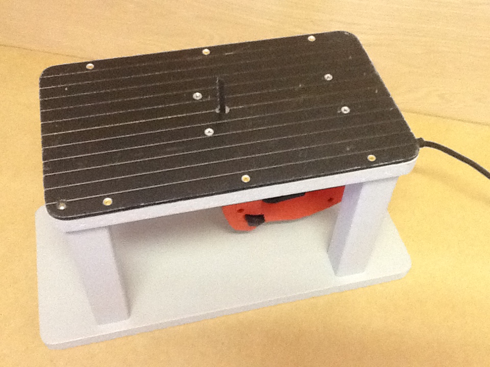

I made this simple jigsaw table out of an aluminum plate from the Goodwill and scraps of wood from my garage. Total investment $3.18, not counting the jigsaw itself. I have found it to be worth every penny of the investment. It makes cutting small pieces a bit easier since vision is not obstructed.
Attachment 12563
Attachment 12564
