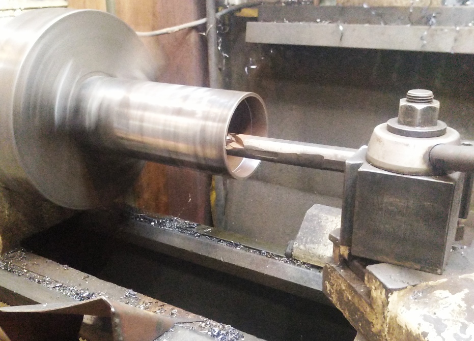

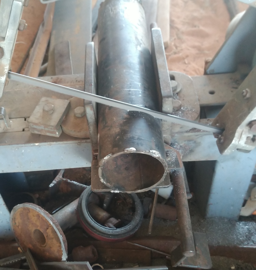

First I lucked out and found a piece of round tubing the correct OD
cut it squared the ends and did a slight cleanup to the bore
Attachment 43108
Attachment 43109

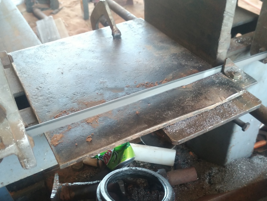

Next I squared a 1/4" Plate to 8x8"
Attachment 43110

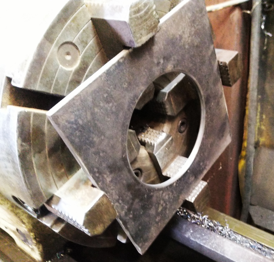

Chucked it in the 4 jaw and made the center hole
Attachment 43111

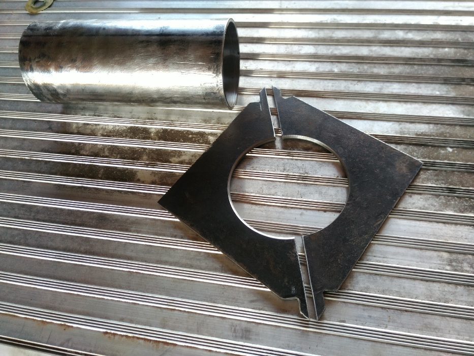

the finished tool
Attachment 43112

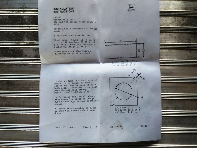

What the manual says
Attachment 43113
