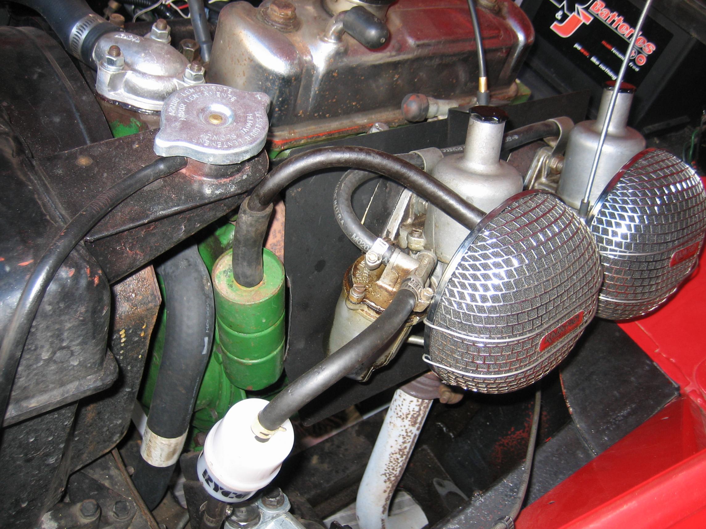

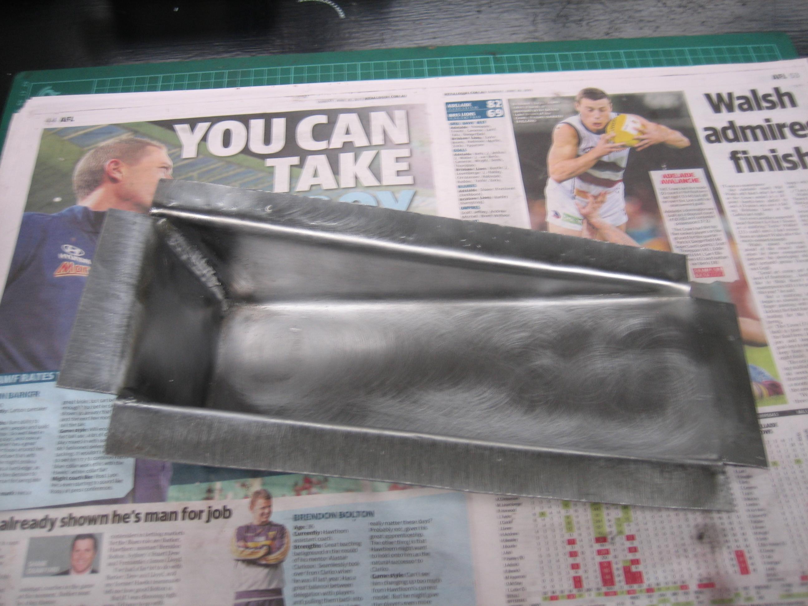

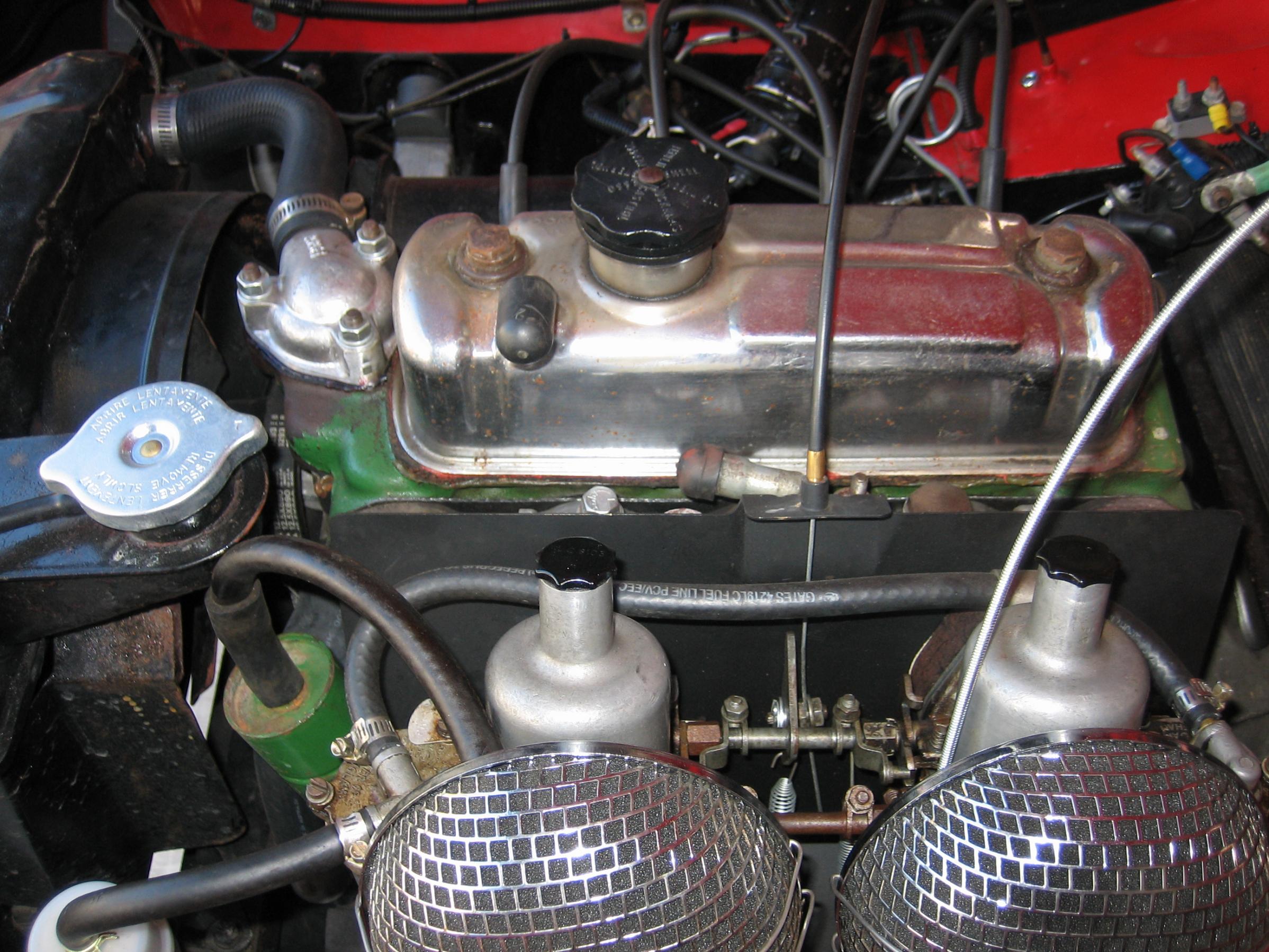

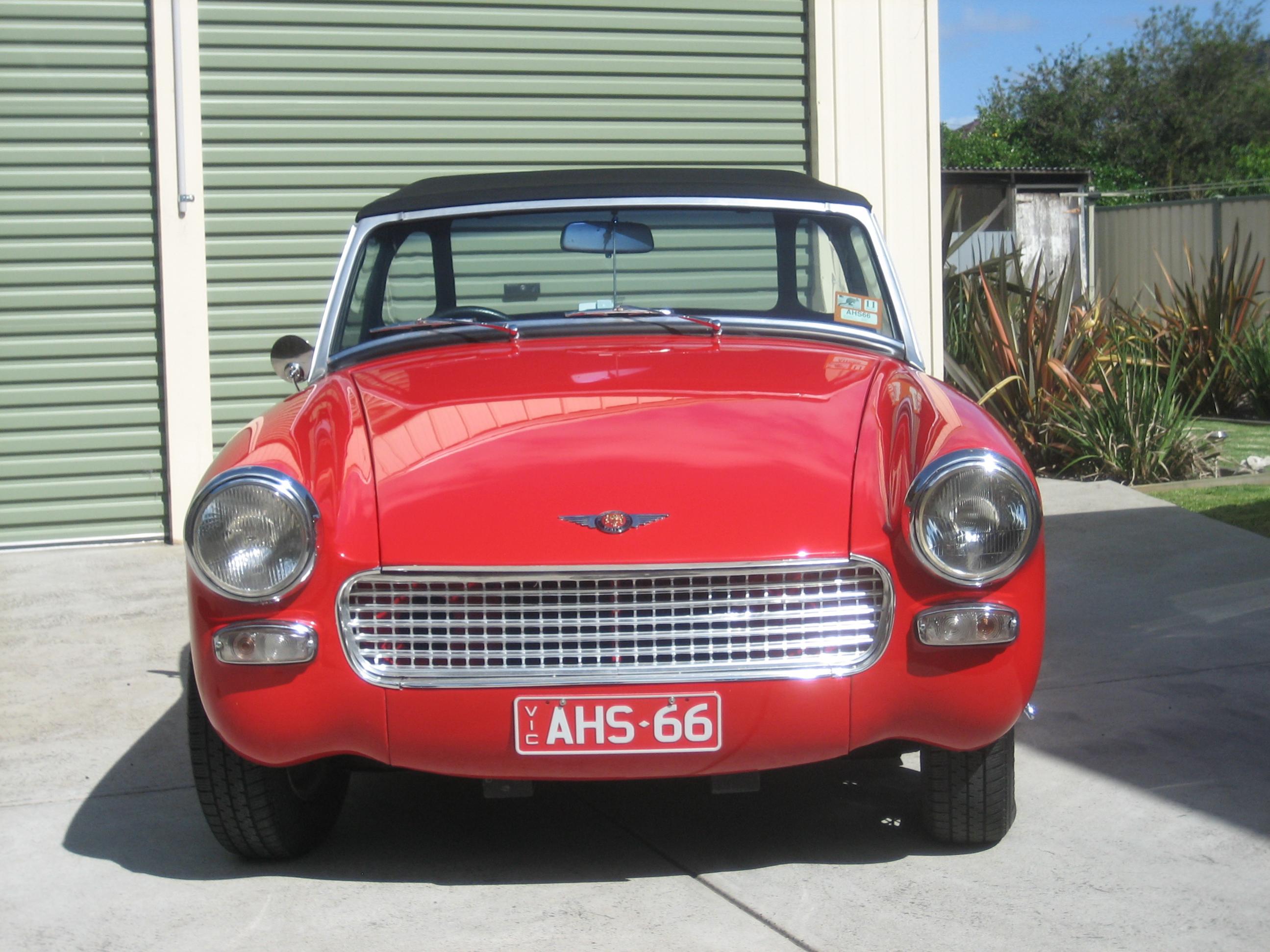

Thanks for the welcome. I've had the Sprite a few years now and just last winter I decided to take it of the road mainly because I wanted to take the engine out and repaint it. I also had a leak in the duel clutch/brake master cylinder (again) and wanted to improve the brakes. Anyway a long story short I removed the engine and decided to strip it, rebuild it and paint it, which I've just about completed. Just have to refit the head and rockers.

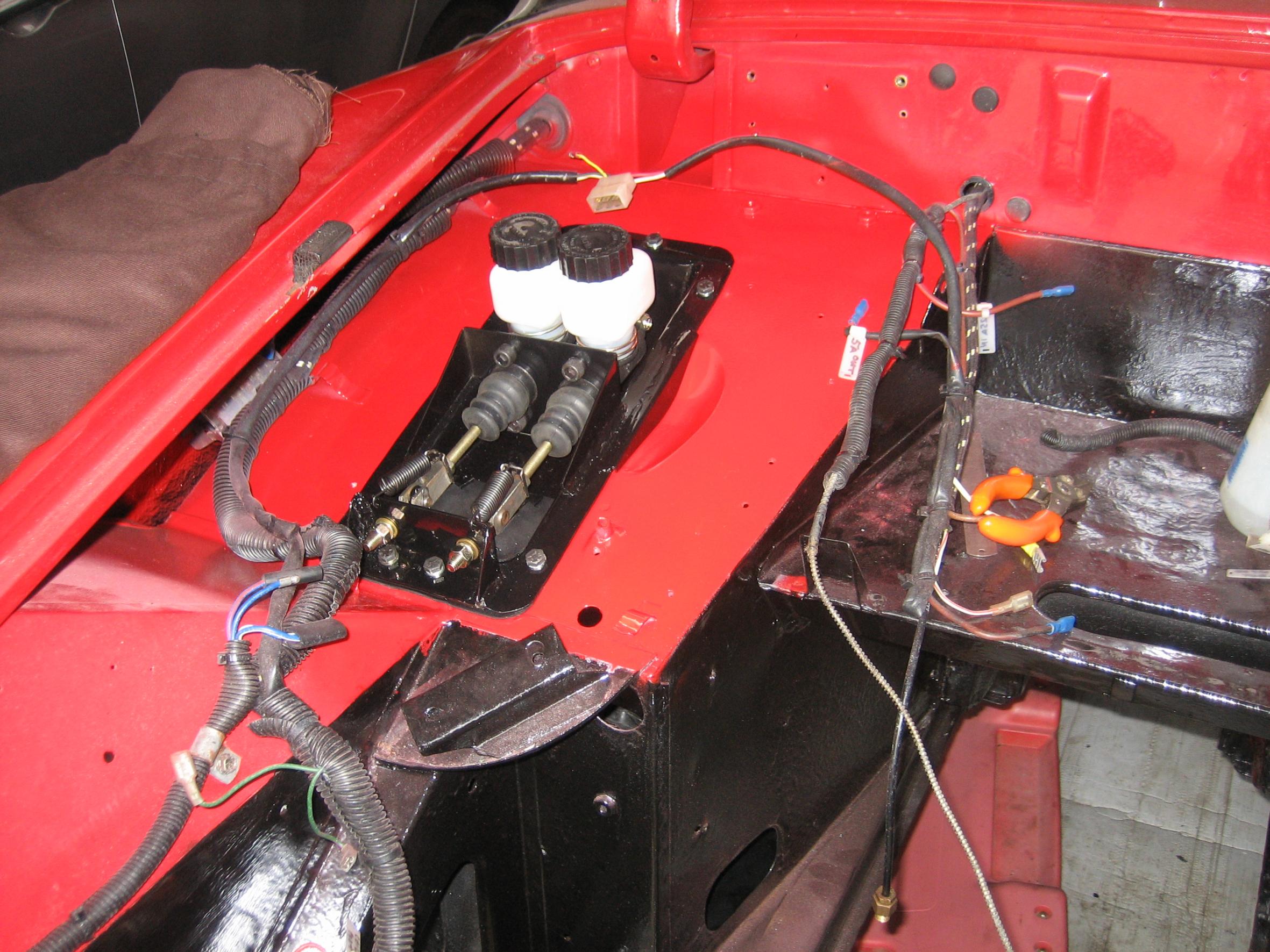

I have replaced the original master cylinder with two Tilton master cylinders, one for clutch and the other for brakes, I had to make a new peddle box for these, which I'm now happy with. I have also added the Frontline front brake upgrade and I'm going to fit the Frontline 5 speed T9 gearbox. So I have plenty of things going on to keep me occupied.
Anyway thanks for the welcomeAttachment 5703Attachment 5704Attachment 5705
Very, very cool! Nice work, too. :thumbsup:

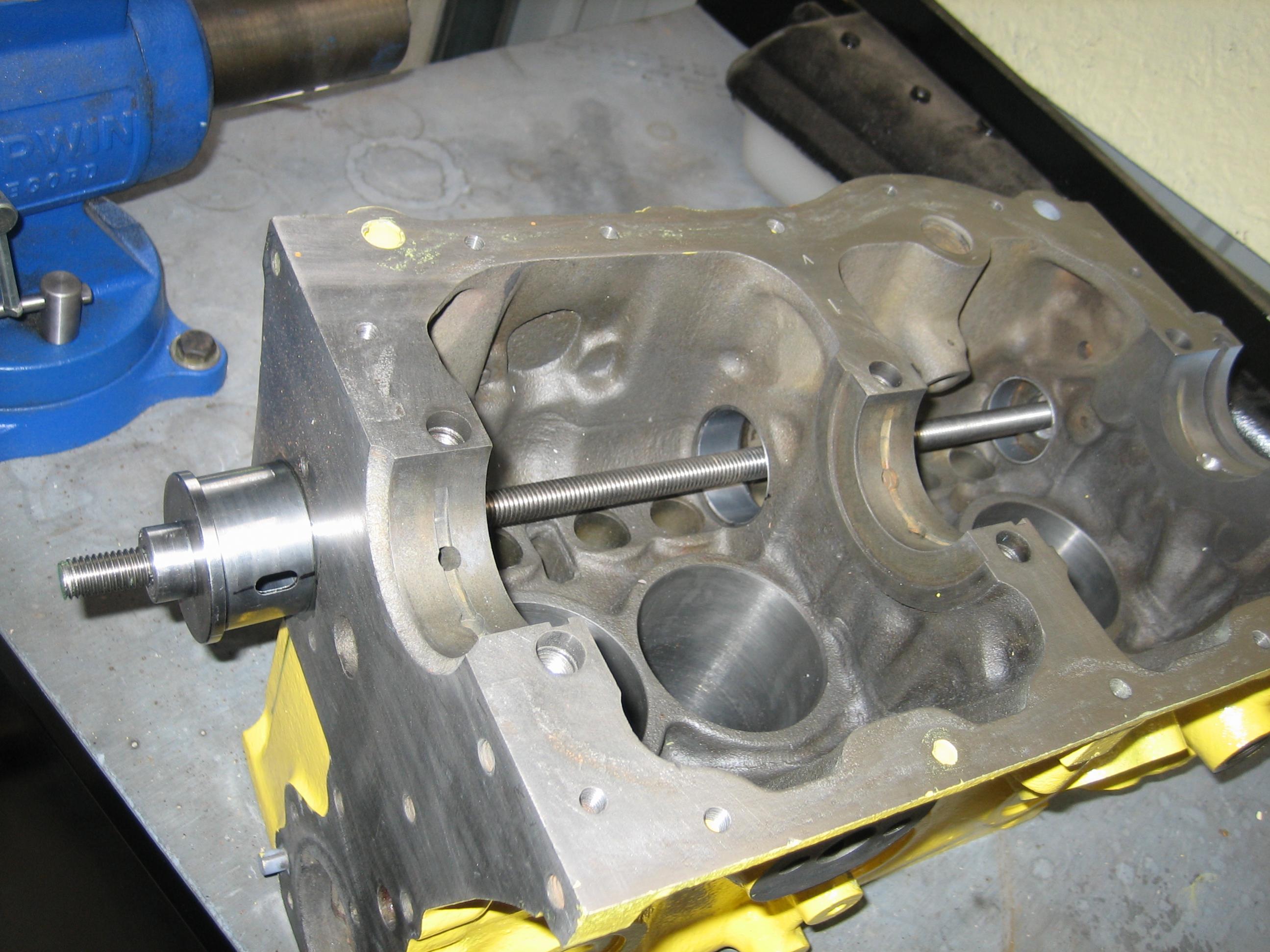

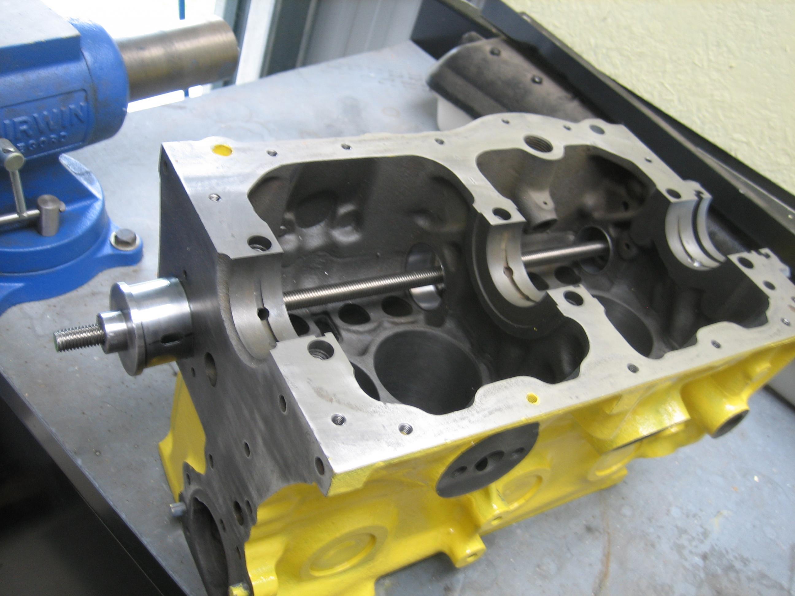

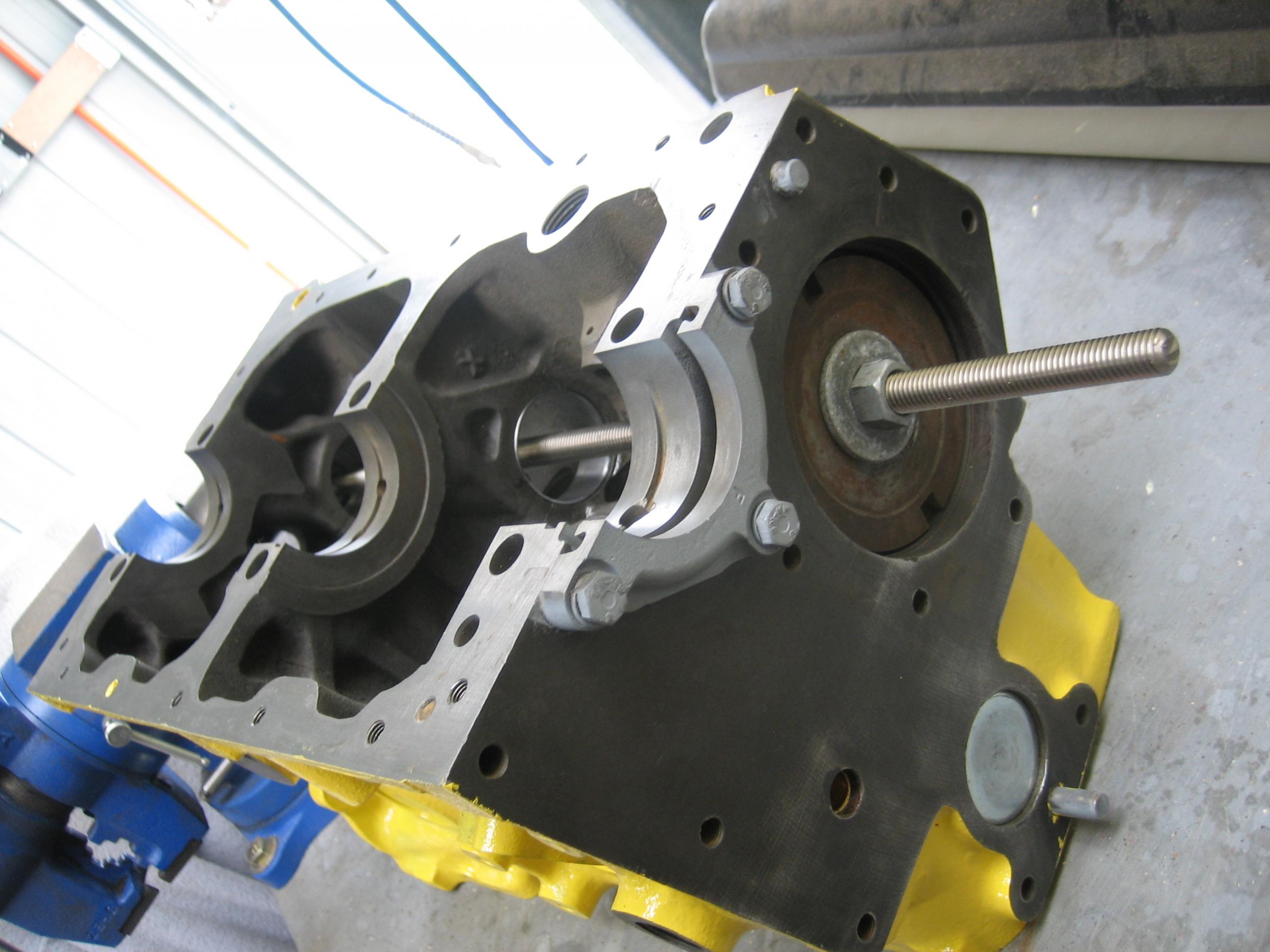

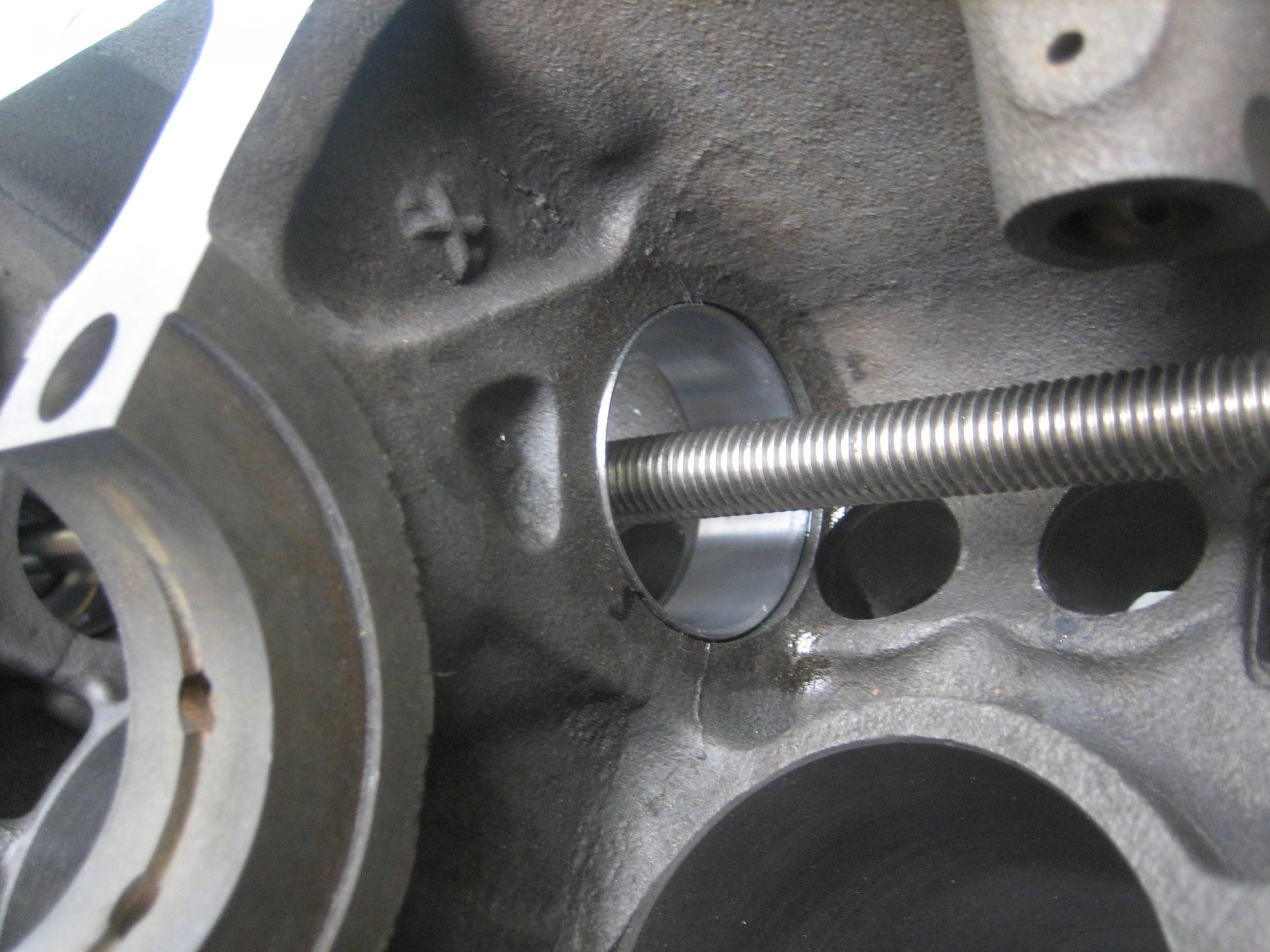

Thanks Ken, will post some videos when I get it running. In between times here is some picks of me installing new cam bearings.
Attachment 5722Attachment 5723Attachment 5724Attachment 5725

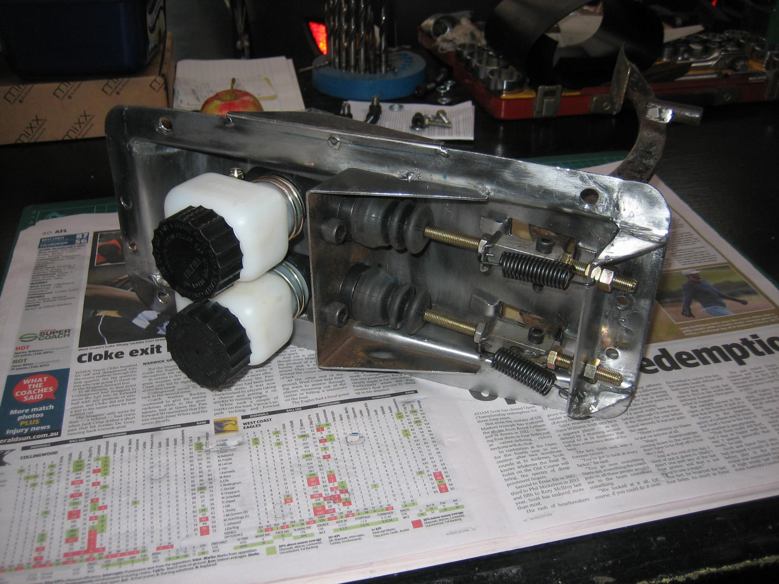

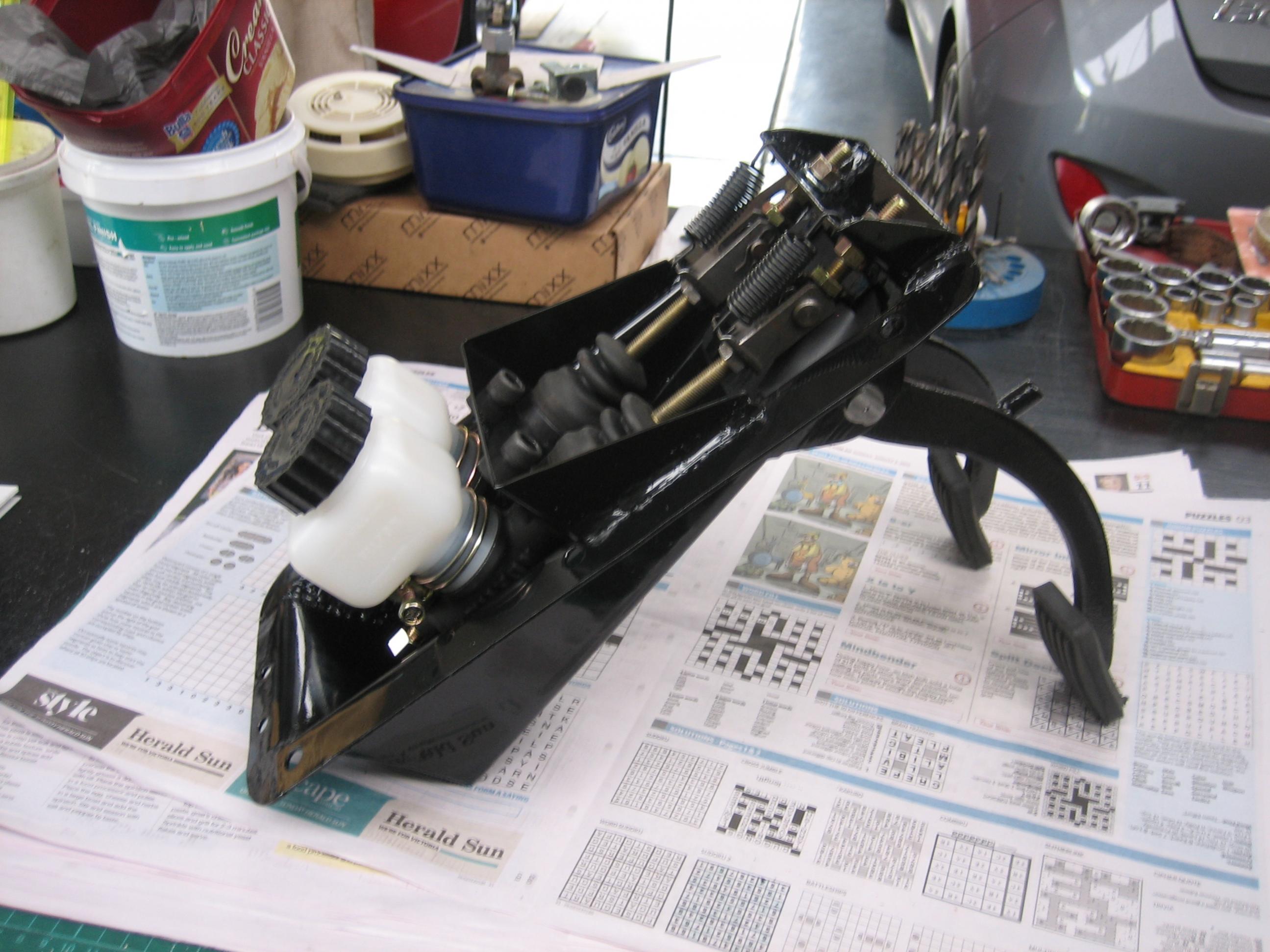

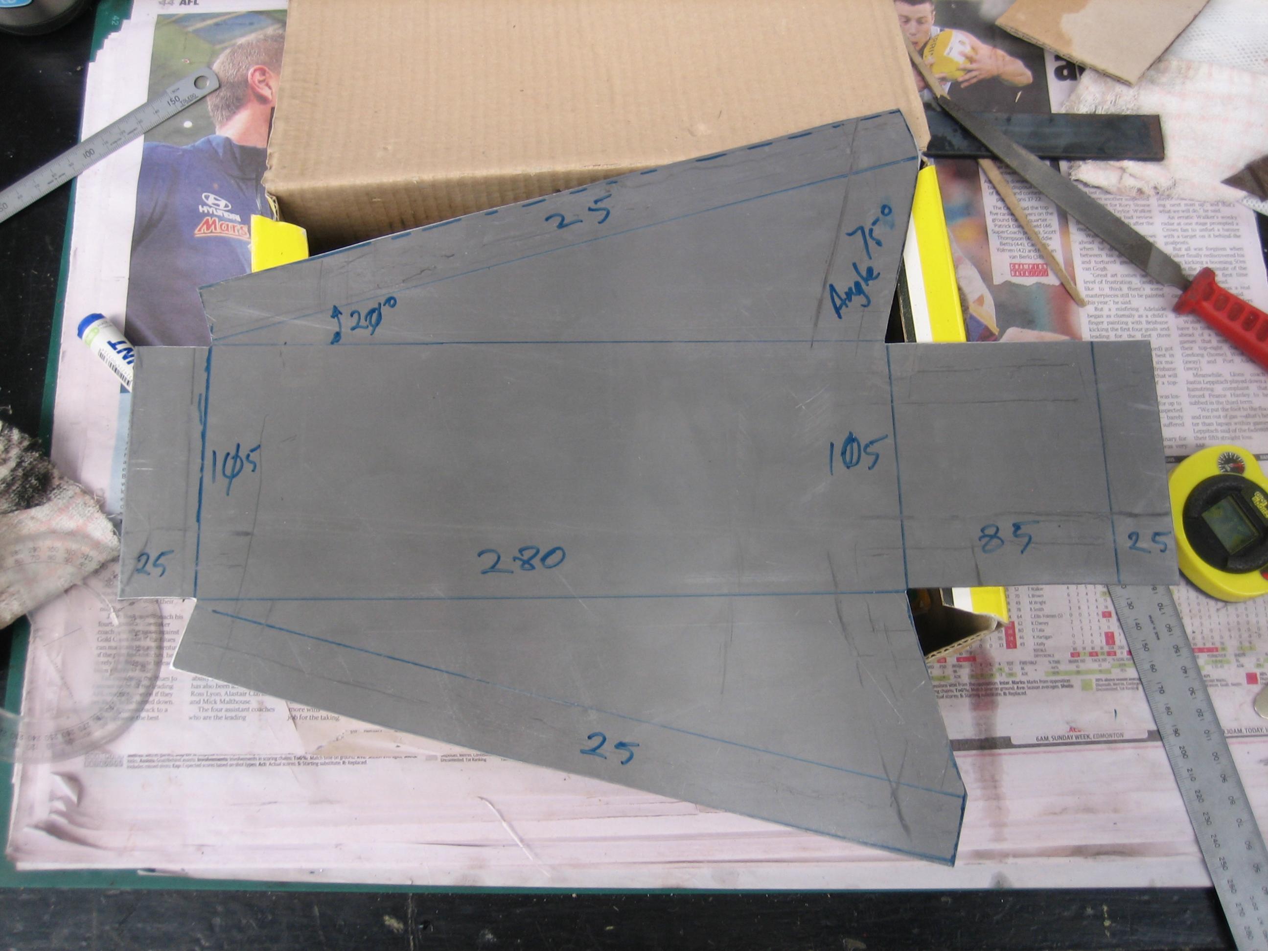

Hi DIYer, I agree, they do have a certain charm and they are much simpler to fix. Not only that there are thousands of people with the skills and interest to keep them running. Here are a couple more photos of the new peddle box I made.
Attachment 5762Attachment 5763Attachment 5764Attachment 5765Attachment 5766
Neat! Looks like you have enough mechanical and fabrication skills to keep that car running for a long, long time. :thumbsup:
