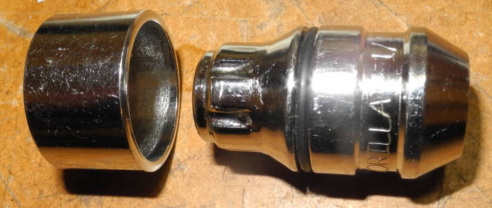

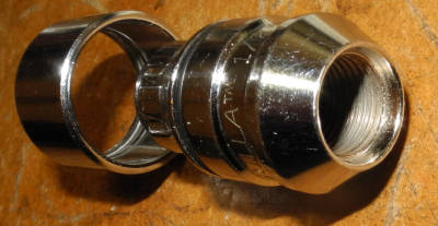

Ya can’t get hold of these things on the trailer with any common tools because the whole thing is in a close-fitting hole in the alloy wheel. I suppose one could stick-weld something on the end of the nut in-situ like some older mechanics and millwrights knew how to do, but that’d risk heat damage to the pricey magnesium alloy wheels.
Step one: in a scrap piece of steel, make a hole just large enough to clear the center post of the puzzle nut. Press off the outer ring using a 12-ton press. Probably only took about six tons, it didn’t put up much of a fight, make any loud noises or break any windows with ballistically busted bits. Then I mounted a small rotary table on my mill, put the puzzle nut in the little Palmgren drillpress vise that’s mounted on the rotary table with freedom to slide in two axes until locked down. A little 4-jaw chuck would be nice and I recently acquired one that would fit nicely, but I’d not gotten around to mounting it on the rotary table. I seldom use that little rotary table, but it sure is handy when its needed. The shop-made sliding drill press vise kludge works OK for now.

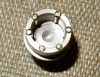

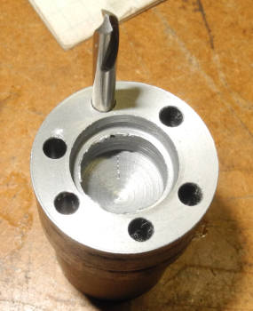

Next step was to make a blank at the lathe, put that in the little vise on the rotary table, check for alignment with table axis and mill spindle axis, and drill and ream a series of .1245” dia holes. The idea was that after the holes were made I’d bore out the center hole to clear the post in the nut and press in bits of 0.125” dia rod to grab the grooves in the nut. Less than half of each .1245" hole would be cut away by the center-hole boring operation, so the rods inserted after boring would be captive. Then I’d turn down the OD to fit in the hole in the wheel, weld on a bit of hex stock for a wrench to grab. All went well – until I compared my blank with the six holes to the puzzle nut’s six grooves. They didn’t all quite line up. WTF, over???
Attachment 10293
Ohhh… I’d made a mirror image of what I need. I’d measured the angles with the puzzle nut facing up, drilled the holes with the blank facing up – but the finished tool would have to face the puzzle nut so I got the angular sequence mirrored. Well, that was pretty easy and the rotary table was still set up on the mill, so it was easy enough to make a new blank – and this time I’d get the radius of the hole circle right as well. I was off about 13 thou, probably would have worked but may as well get it right. It didn’t occur to me until later how to measure that using a micrometer and a .124” dia center drill. I used Excel to figure out the mirrored angles.

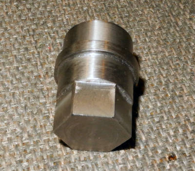

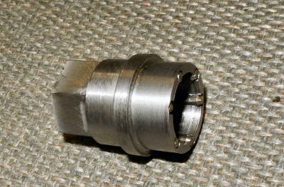

After making a new blank, correctly this time, I found that the holes did indeed seem to align nicely with the grooves in the puzzle nut, so I made some little rods out of .125” welding rod and pressed them in. Instead of welding on a nut I just milled a hex on the other end.
Attachment 10294Attachment 10295Attachment 10296
I tried it on the puzzle nut. It fit perfectly, better than factory. Phew!
