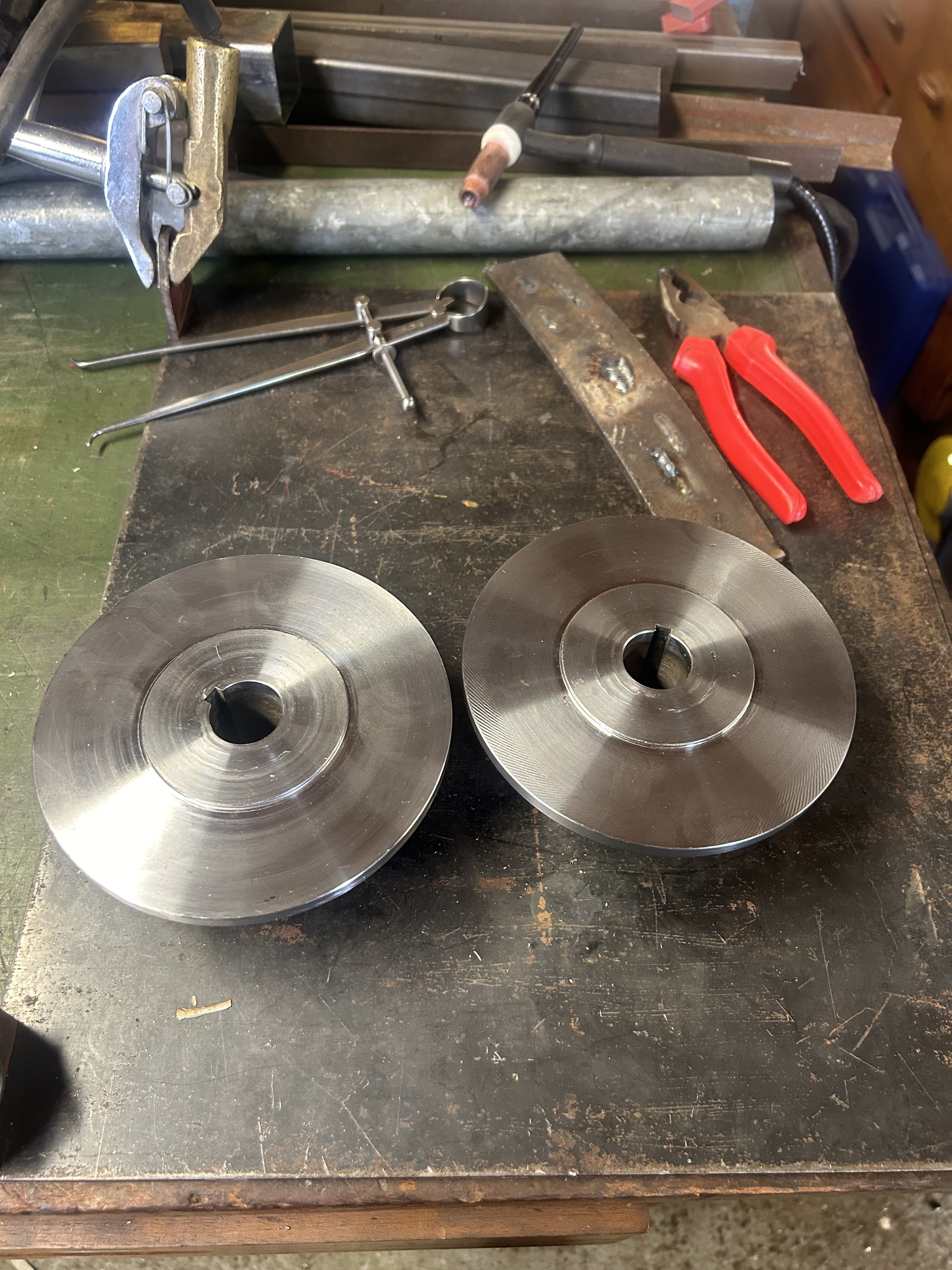

The wheels I purchased for my trailer mover build were new old stock. The steel rims had the paint flaking off in places so a good excuse to remove tires and repaint rims.

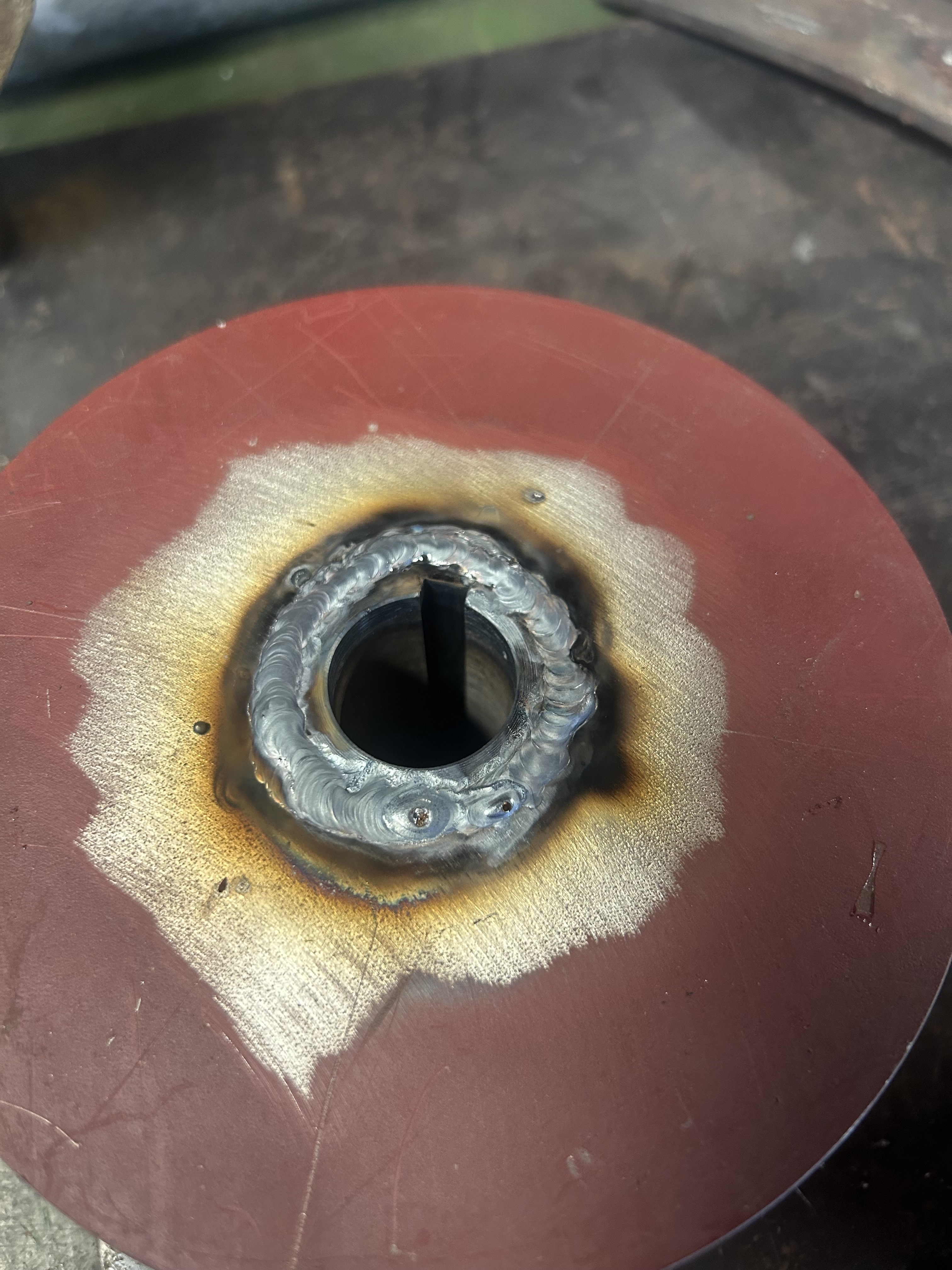

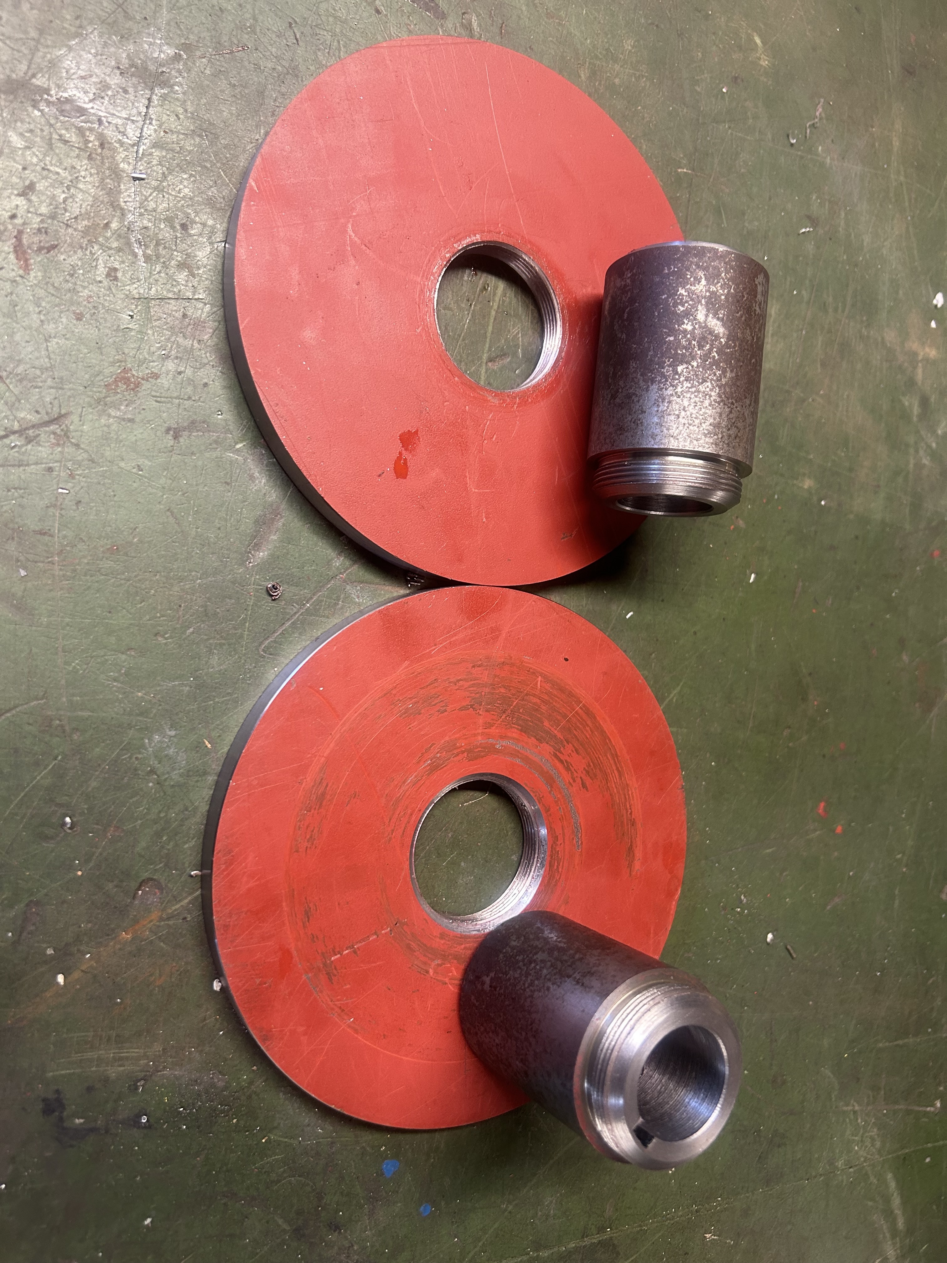

I decided to fabricate the hubs from some old 10mm plate bought from a scrap yard and some 45mm bar. The plates were pressure turned to diameter and the bored and screw cut. The 45mm bar was then turned to suit the plate bored and the keyway broached. A decent chamfer was cut on both parts for weld prep. So the weld could be machined back. Threaded and welded I am confident this will be very strong joint considering the weight I am hoping to move.
The bolt holes are on a 4” PCD

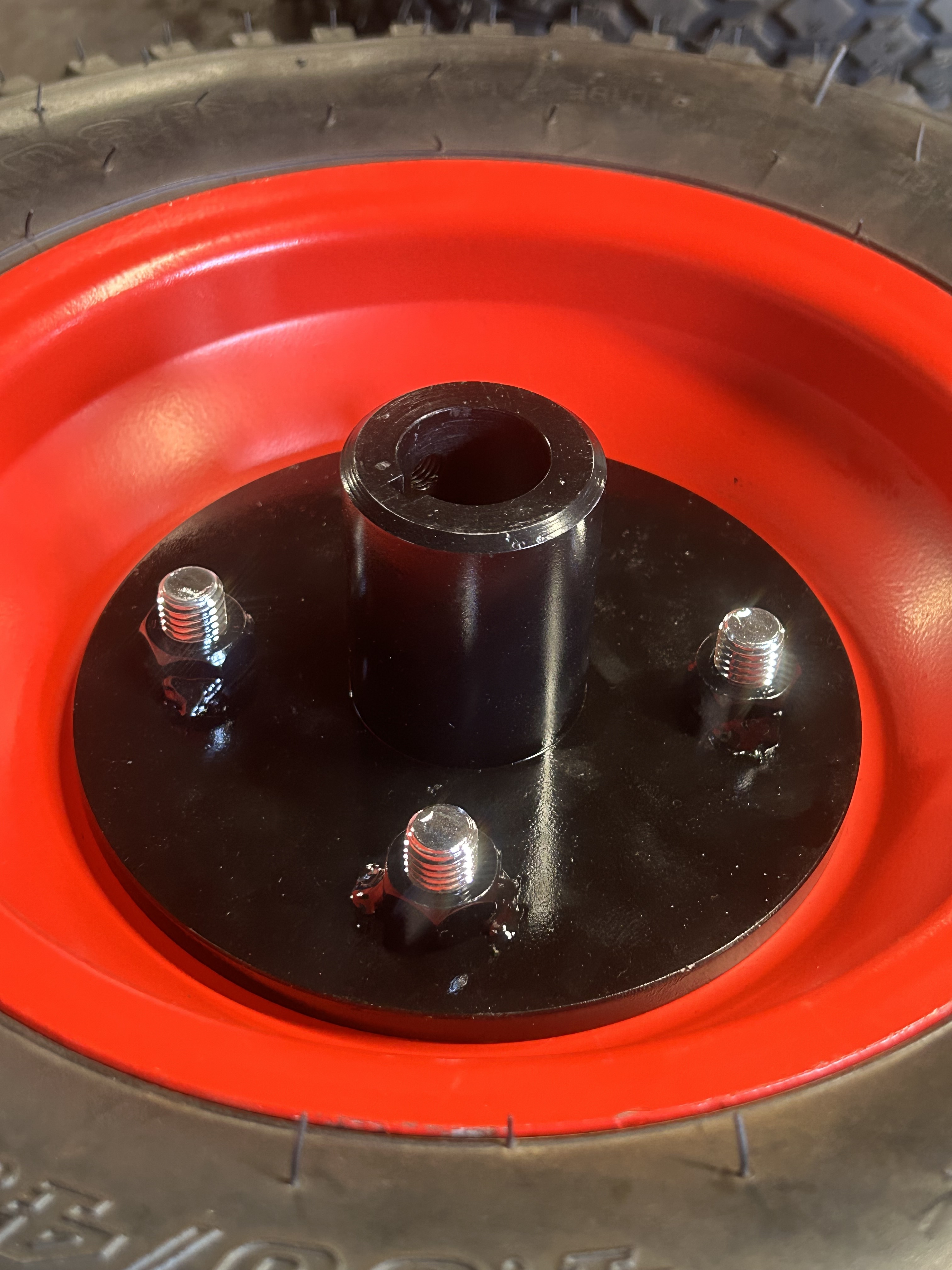

Once finished a coat of paint.
The wheel bolts were commercially purchased at a pound each and plated. So not worth considering making at that price.
Photos below show build.

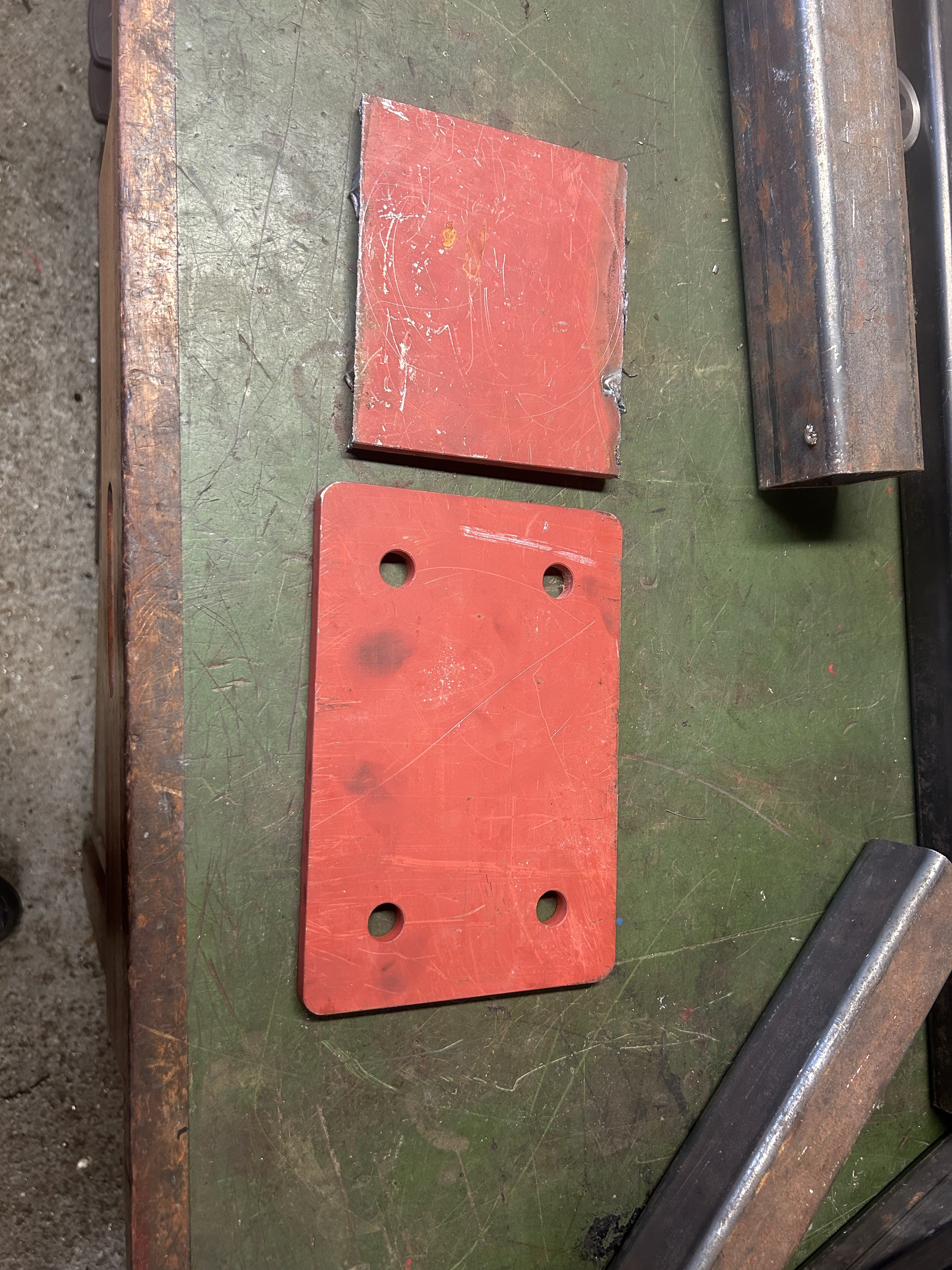

Attachment 47683 10mm plate
Attachment 47684 Two parts ready for welding
Attachment 47685 Weld ready for finishing turning.

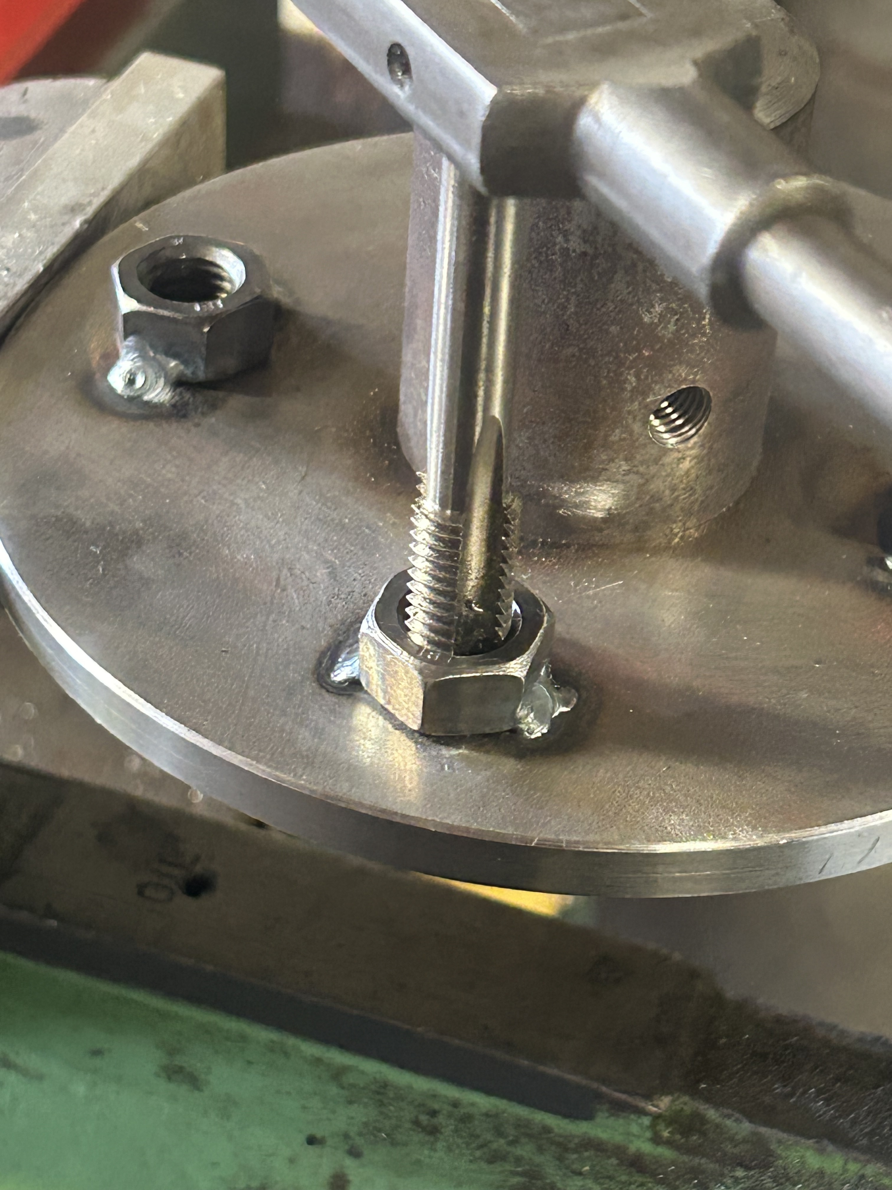

Attachment 47686Ready for drilling.

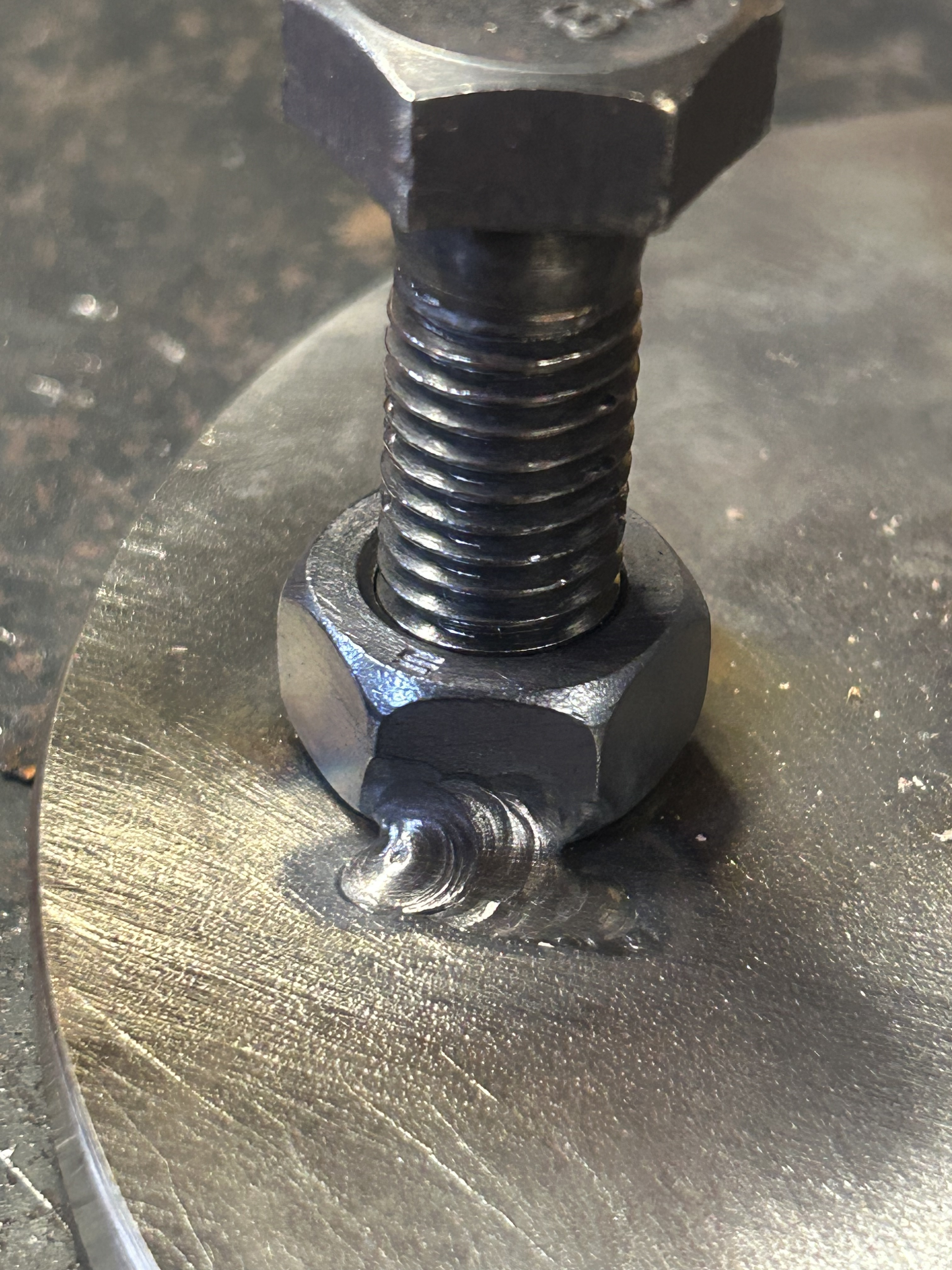

Attachment 47687 Attachment 47688 M12 standard nuts welded to hub.

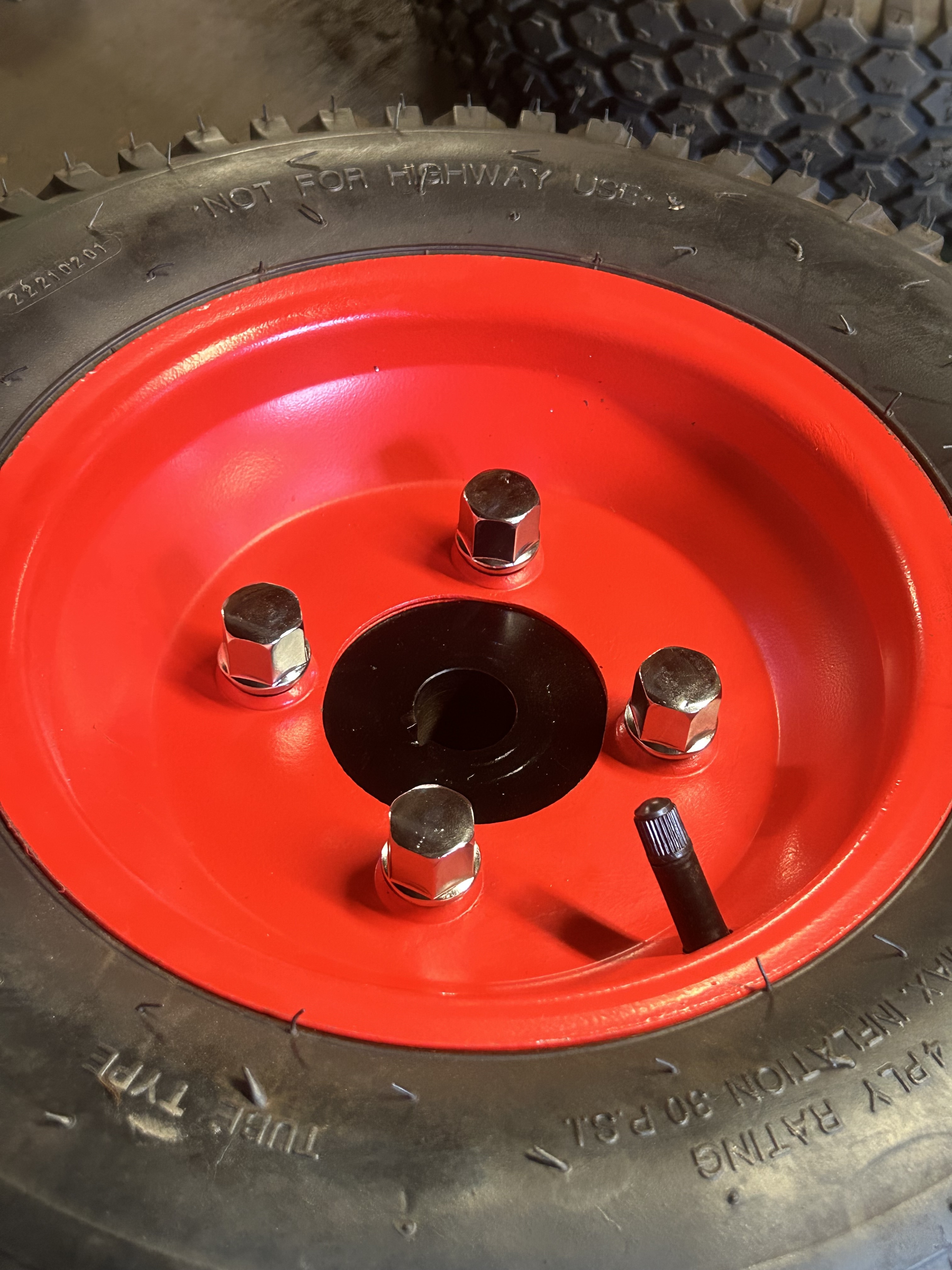

Attachment 47689 Attachment 47690 Hubs fitted to newly painted wheels.
The driveshaft will be 1” diameter and the hubs keyed to the shaft with 1/4” key. The hub is drilled with two M8 holes to lock hub in place along shaft with grub screws.
