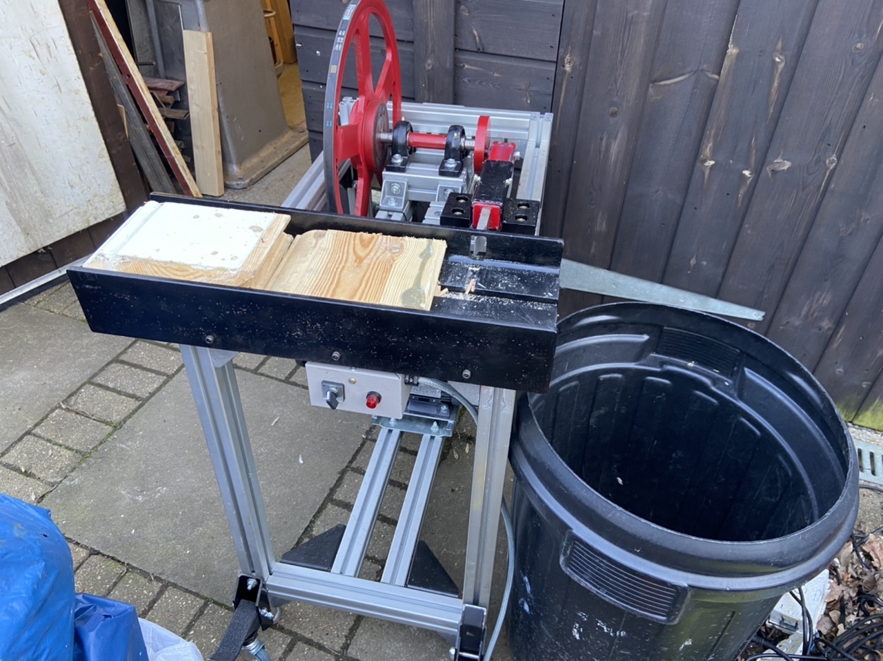

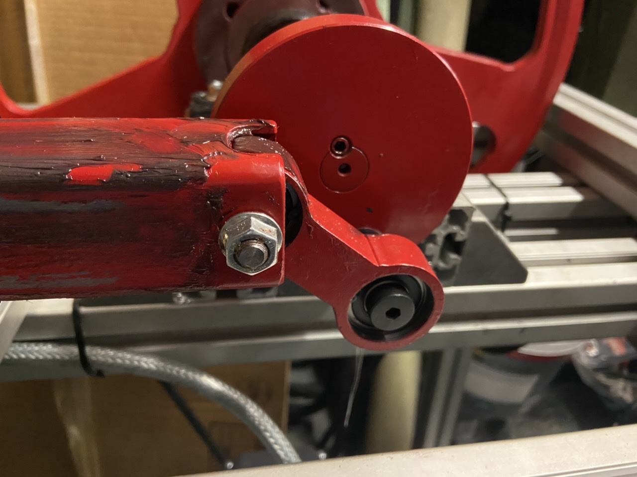

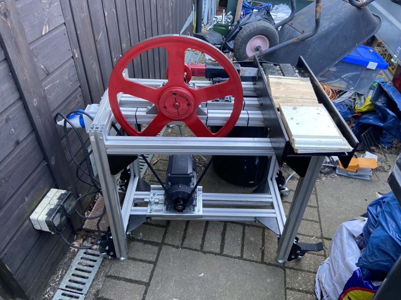

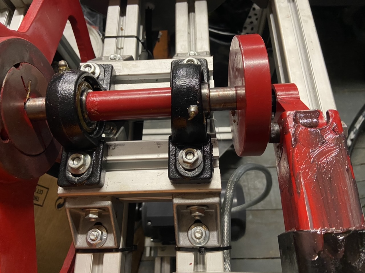

Hi All
Recently I finished building a kindle cutting machine.
The main frame is made of Bosch extrusion salvaged from two frames rescued from a skip and ♻️.
The motor is single phase 1HP eBay purchase which came with the motor frame and taper lock pulley. The large pulley taper lock pulley, vee-belt and crank bearings are also eBay purchases. There is a foot operated switch from Amazon and the rest of the machine is made from materials lying around the workshop.
The retractable castors are also homemade which I have posted on HMT

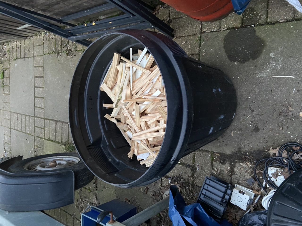

This has made chopping kindling so quick and easy, after 20 minutes a bin full ready to use.
Thank you for viewing
Attachment 39021 Attachment 39022 Attachment 39023 Attachment 39040 Attachment 39041
