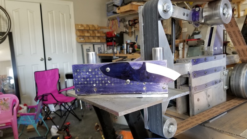

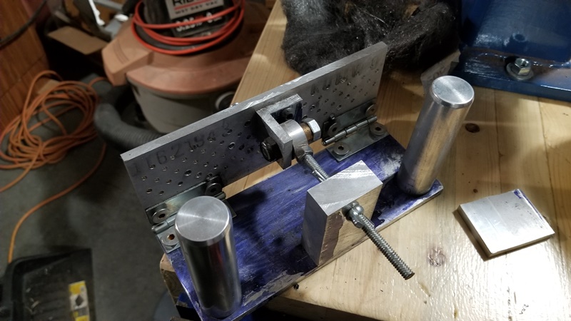

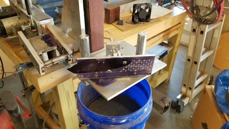

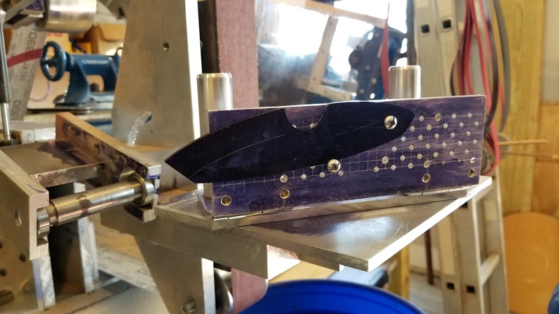

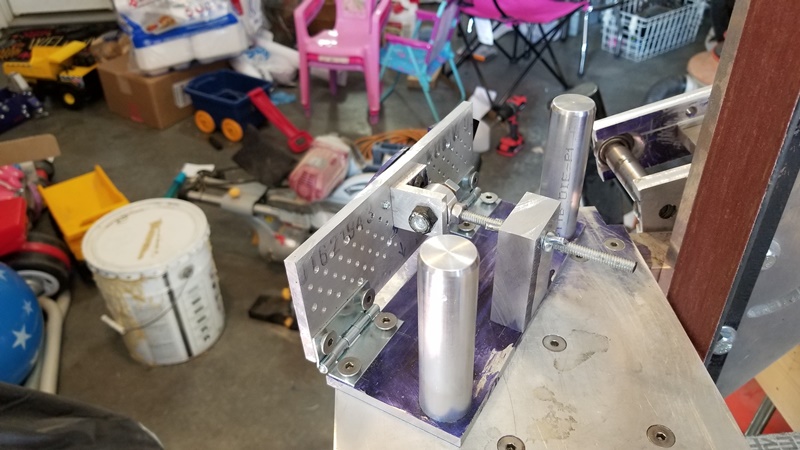

This is a knife bevel grinding jig that I made for my 2x72 belt grinder. It is adjustable. It is made from (2) 1/4" sheets of aluminum. The front plate is drilled and tapped to hold knifes in different orientations. The angle is set with 2 wing nuts that jam against the rear vertical.

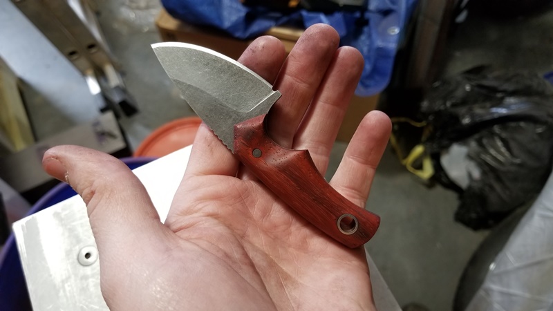

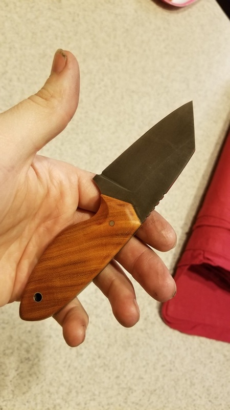

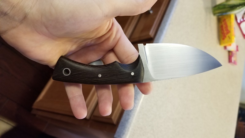

Very nice. I've had quite a few old hand knife makers tell me OH I never just a grinding jig I can match grind a set of knives before you can set up a jig,those contraptions are for beginners. then the next time I visit one he has a set of 8 knives that he is making for someone and he si standing there grinding away with a blade locked in a jig. OH WELL this is a production run and I wanted to make sure that they were all exactly alike and I don't have a lot of time to spend on them.
DUH!
Nice build mr95gst! The vertical pallet gives you plenty of places to lock your work down. Really nice Plunge line and relief! Thanks for sharing. :hattip:
Clever Idea, thank you. Well photographed.
