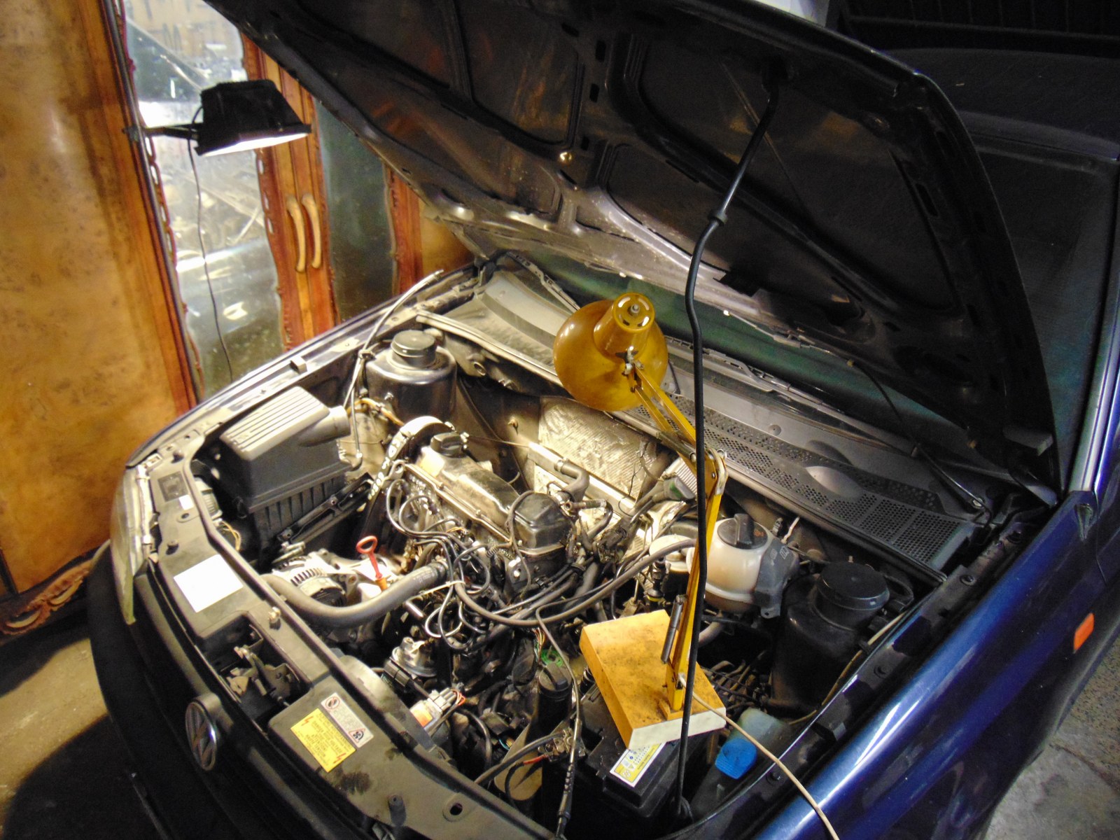

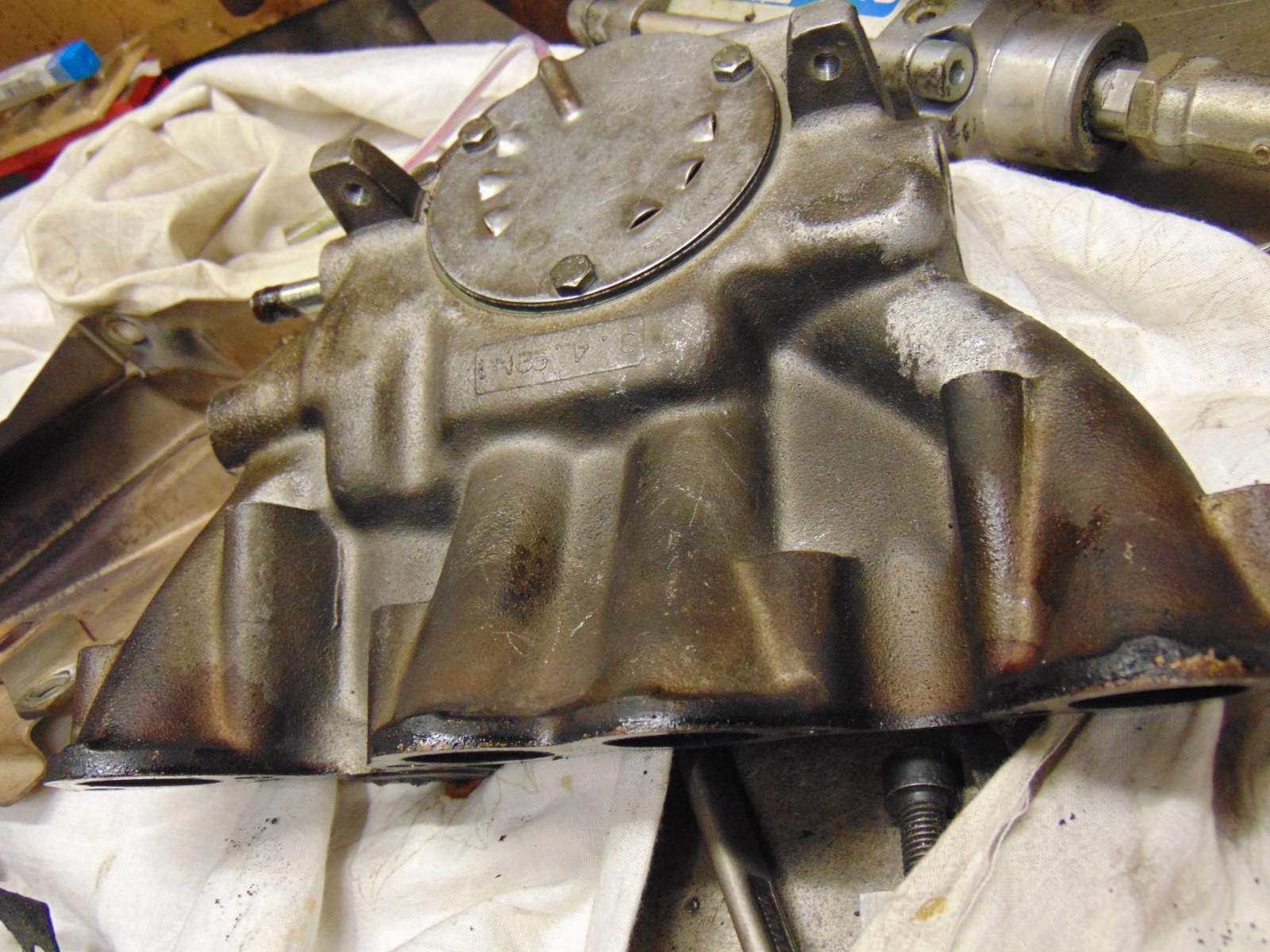

Hi all and happy Holidays!

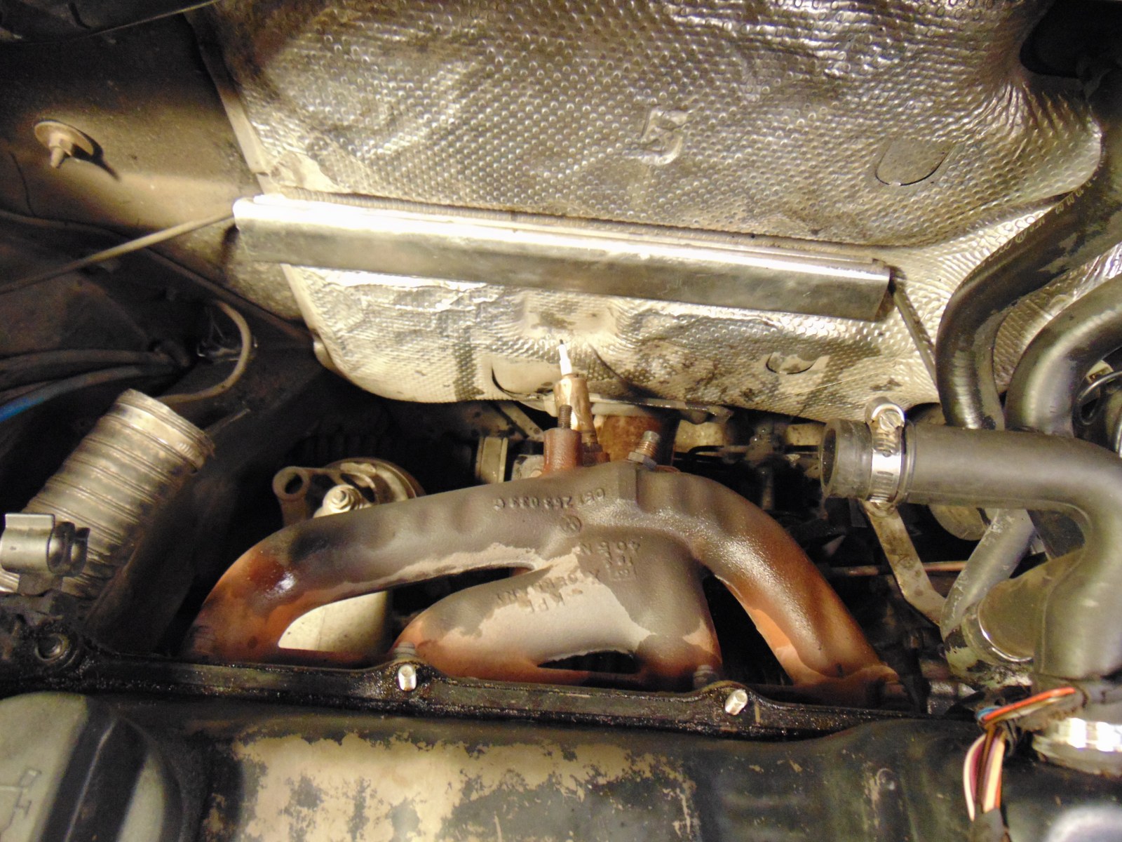

This night, 26 dec, I decided to change my lambda sensor of my Golf mk3, having bought a new fresh sensor from Bosch Germany (made in Usa :D ). Big trouble: 18mm thread (long about 5mm) welded to exhaust manifold!

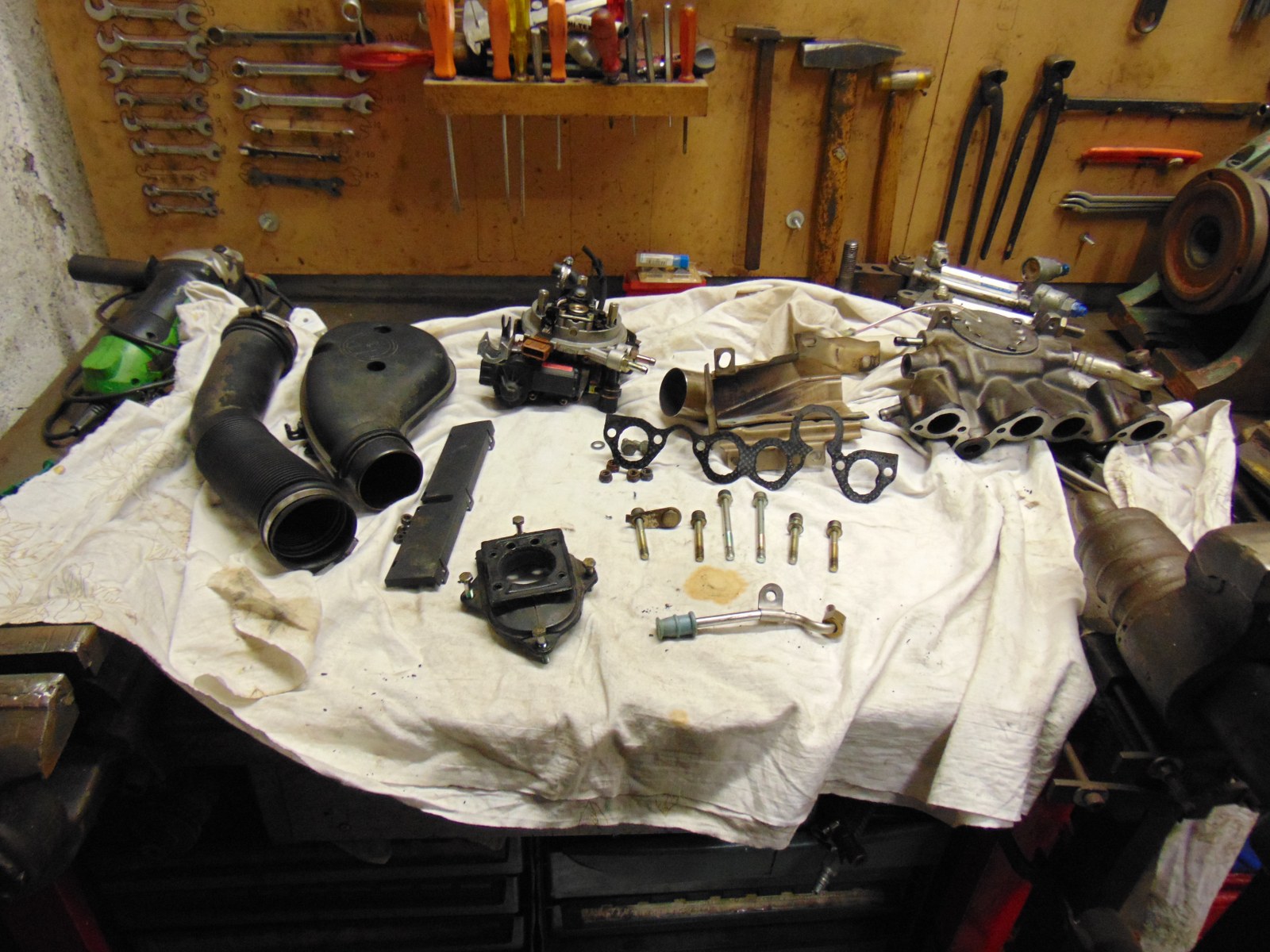

I tried svitol, long poligonal wrench (22mm), nothing! So I decided to dismantle fuel manifold in order to gain some space over the sensor. Unluckily manifolds are close to windscreen, with no chance to work under the car or use an hammer or impulse screwdriver.

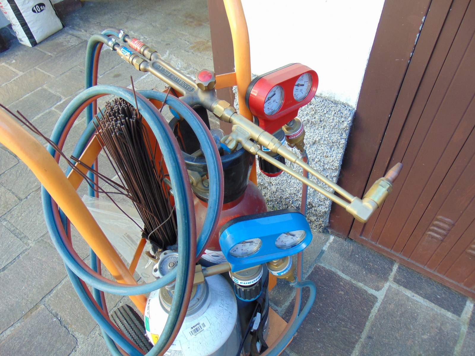

I'm thinking about warming manifold area with oxigen torch (cutting torch can be useful instead of welding torch 500lt\h?). There are some cooling system tubes around, maybe I can shield area with aluminum plates.
Last chance solution I think is to demount exhaust manifold and try bad things on the table... but I really don't want to do this :flame:
Any other good idea to disassemble the lambda from old manifold?
Attachment 15693 Attachment 15694
