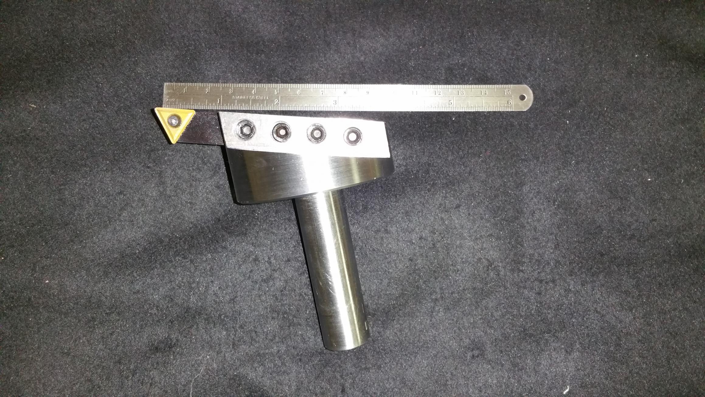

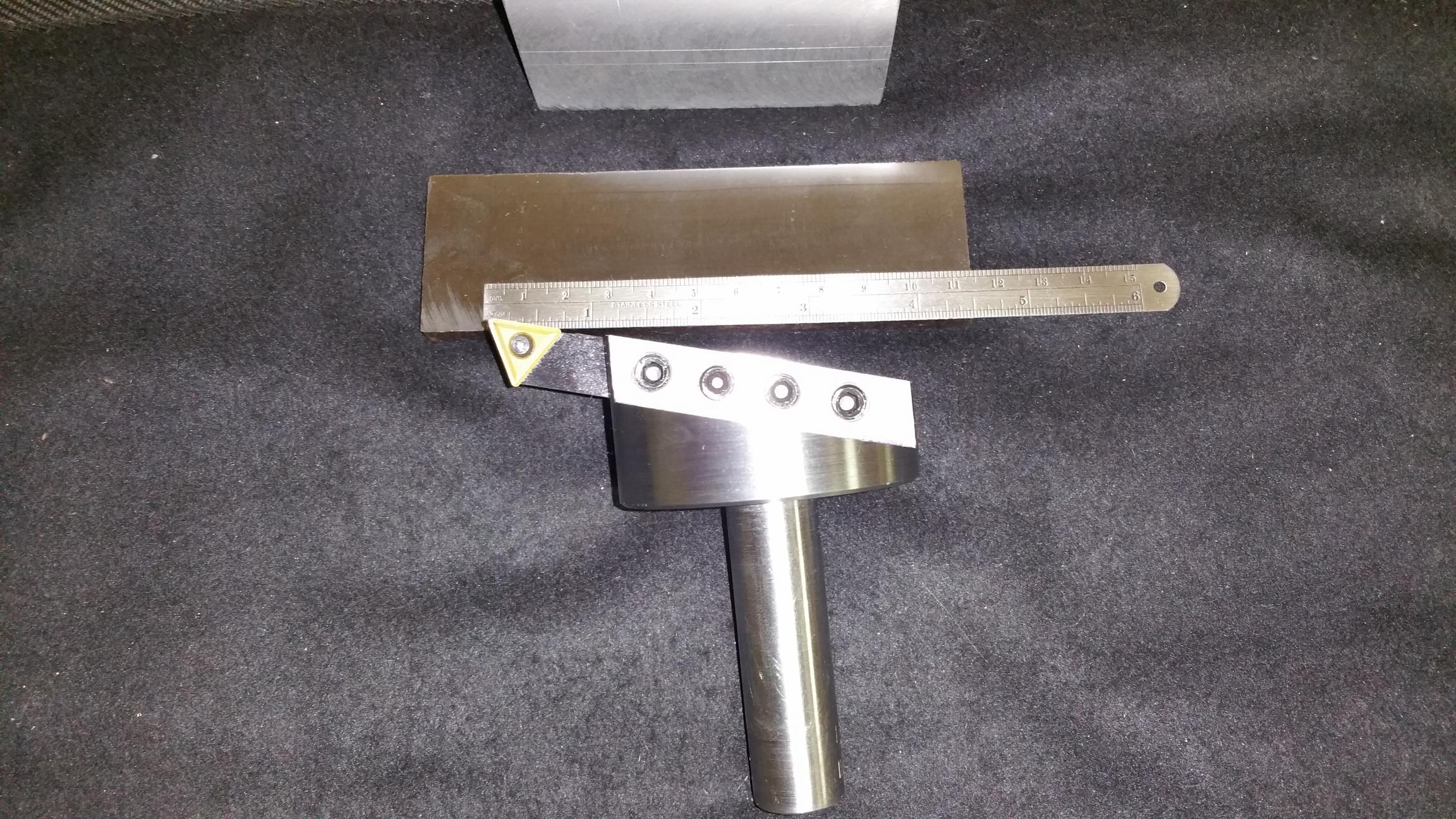

    Here are some photos and a link to the Youtube video of the build.
    The finish was as smooth as glass, I ran it at 320, 420 and 800 rpm
    the scrap in the pic was the test piece . More info in the Video

    Brian,
    That is a monster fly cutter and very well made. It produces a nice finish and for its size, it must throw chips way across the room. The 1144 SP is good choice of material for this type of tool. I also like your use of a lathe carbide insert holder and you can swap the carbide inserts with the T15 HSS equivalent sized inserts made by AR Warner (these only need sharpening on the top surface) if you need HSS.
    Thanks for the video, it really helps with the build techniques, Paul

    Hi bstanga. The fly cutter is awesome. The use of a lathe insert holder is very clever. LyleD
