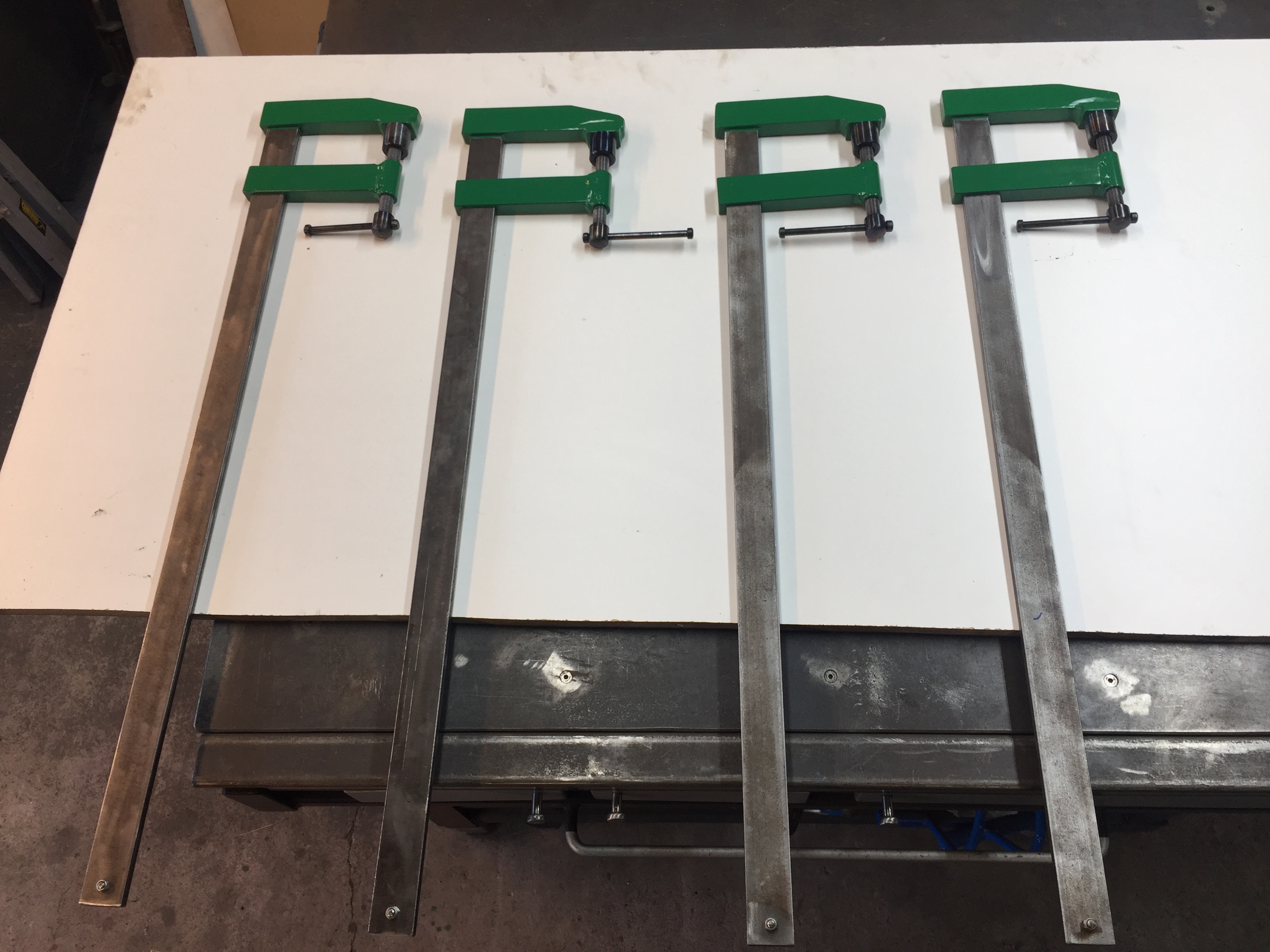

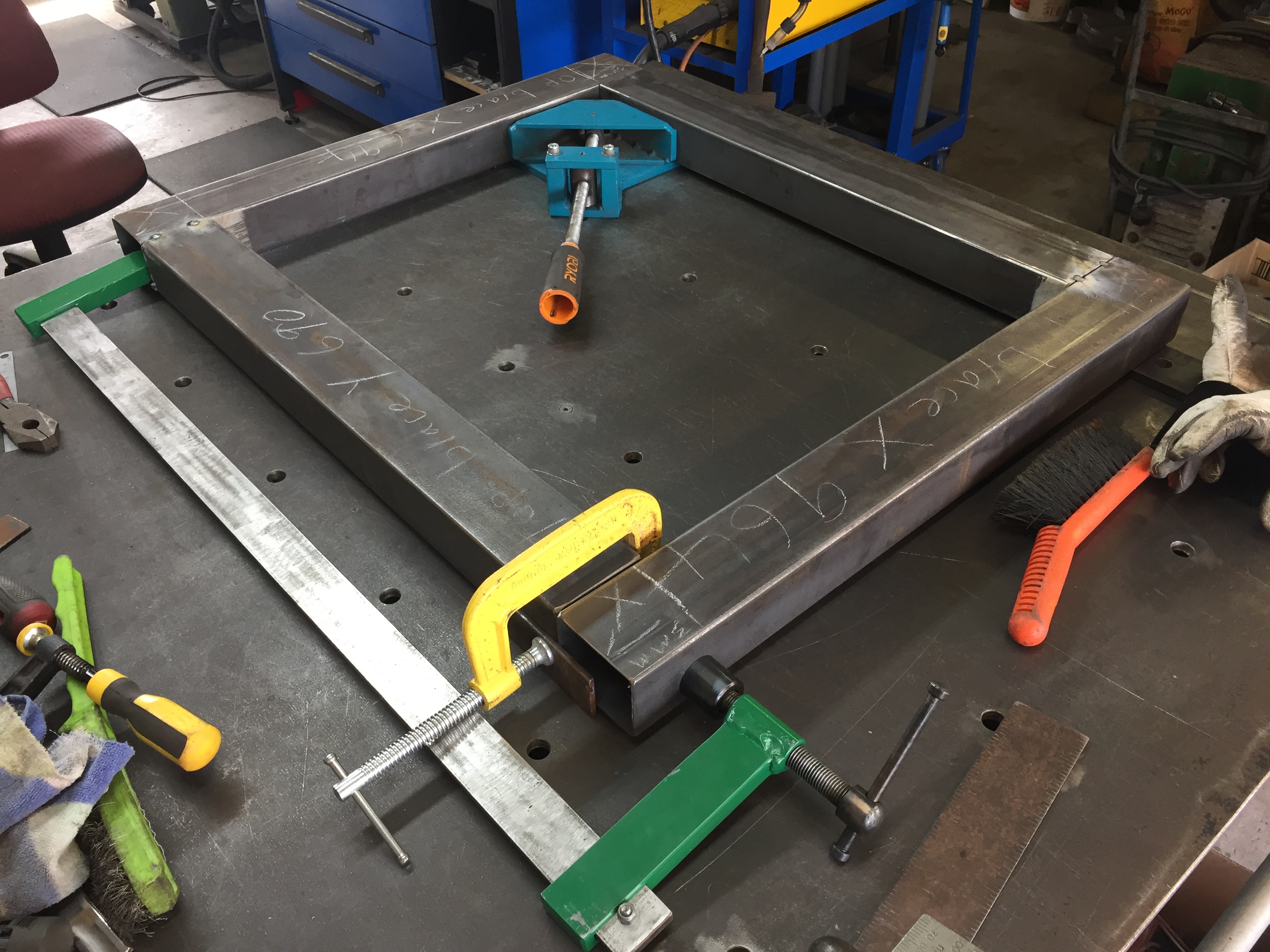

Large Solid F Clamps

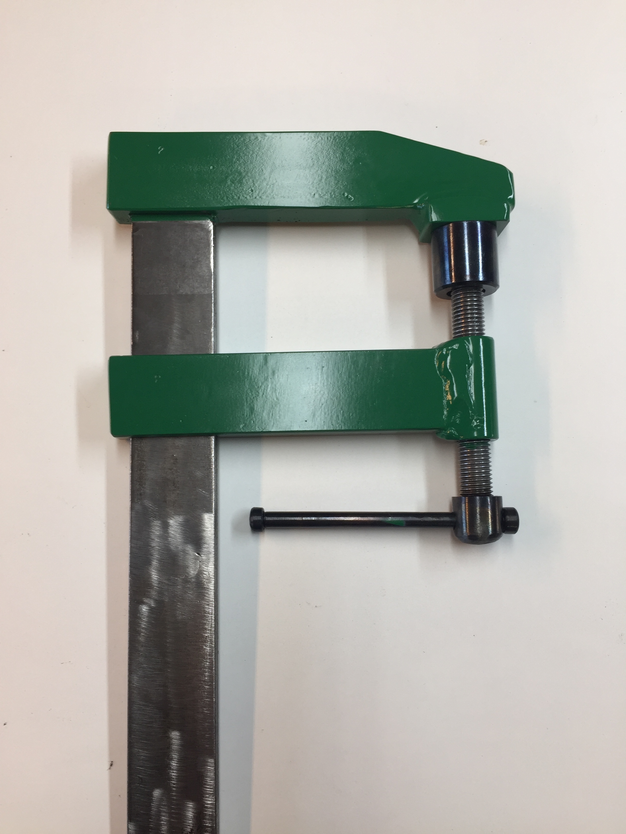

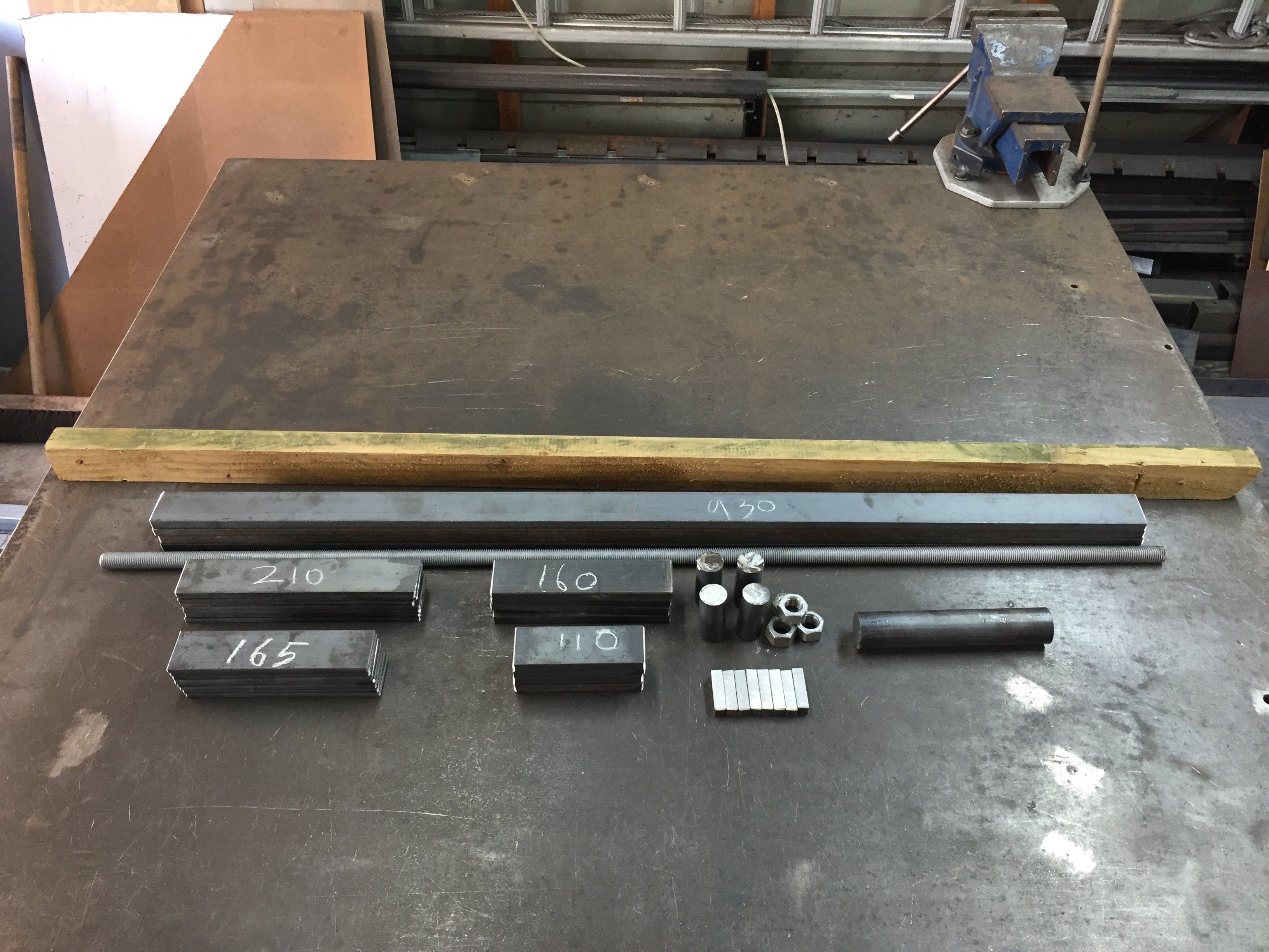

Question!
For the sliding member, is the hole is just a straight rectangular hole? It maintains position during clamping by virtue of opposing corners catching (digging in) on the long bar?
Hi, thanks for your question. Yes, that is how it works with these F clamps.
