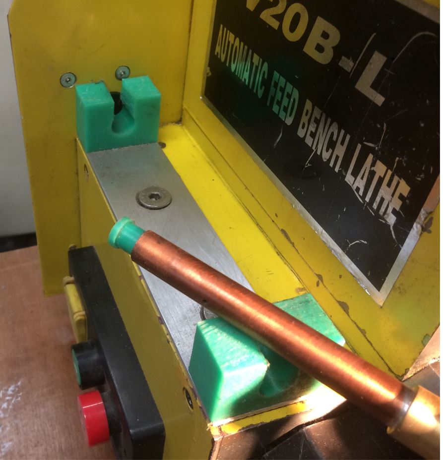

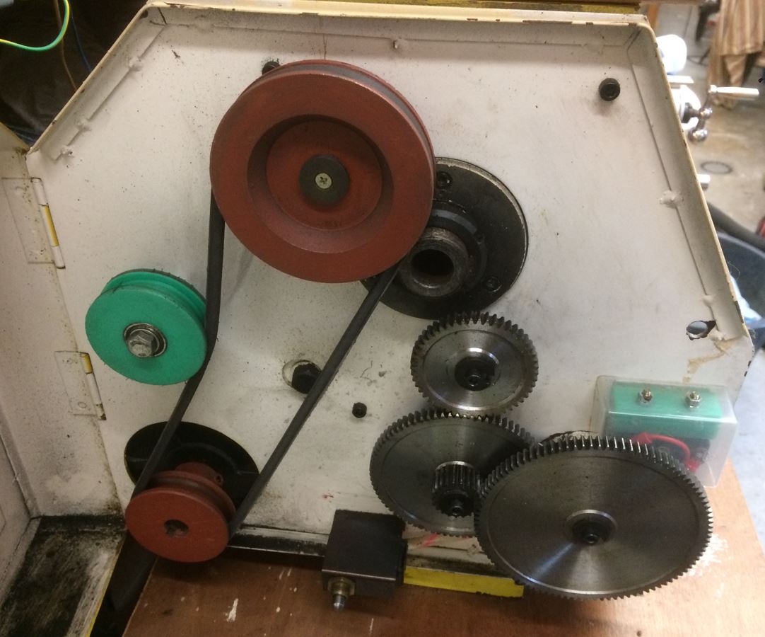

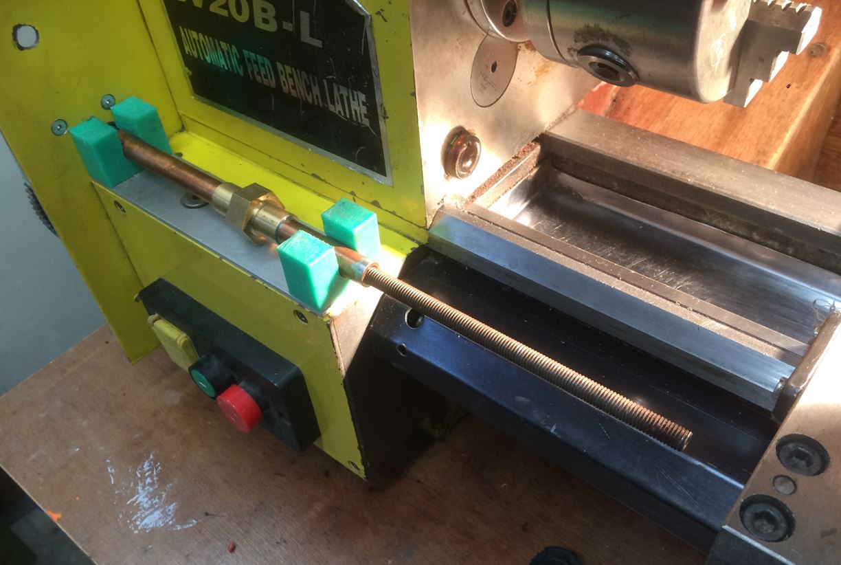

To protect my lathe and myself from crashing the tool against the front of my workpiece or chuck I mounted a second microswitch in series with te existing microswitch that switches of the lathe when opening the gear cover.
This second switch is operated by an adjustable spring loaded pushrod after making contact with the carriage.
I hope the pictures and movie explains it all.
