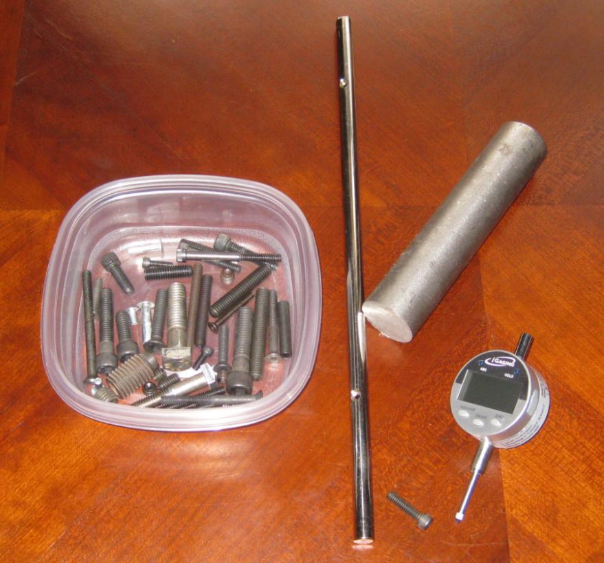

As with many of my ‘Scrap Metal Engineering’ projects ~ Try to use what items and material I have on hand in the workshop.

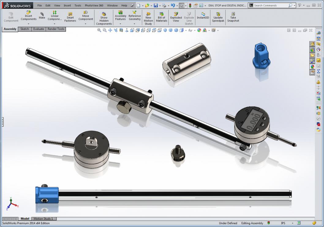

Attachment 2551

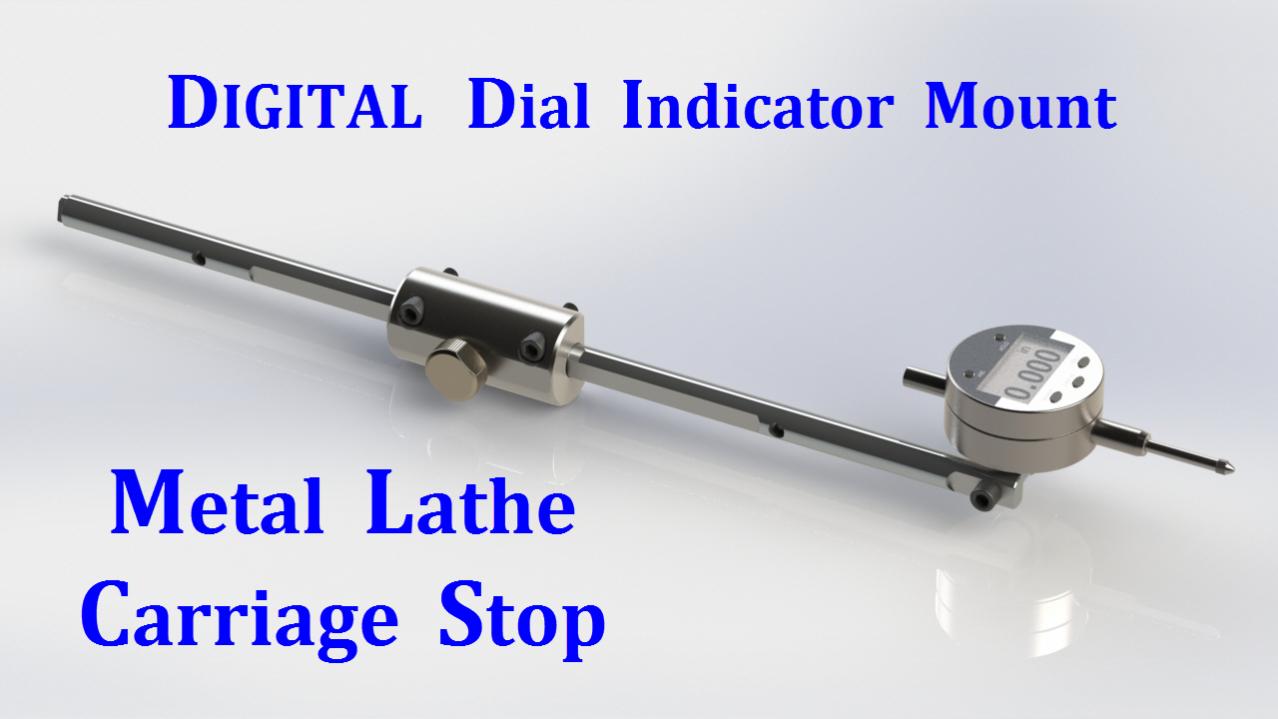

Designed the Lathe Carriage Stop & Digital Indicator Mount in SolidWorks using the available materials.
Attachment 2552

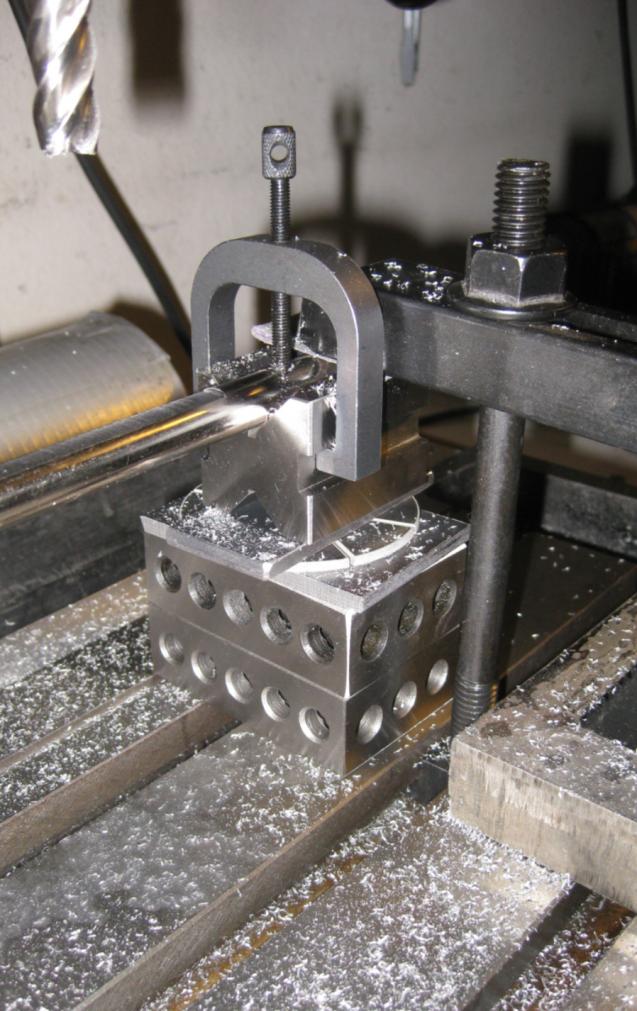

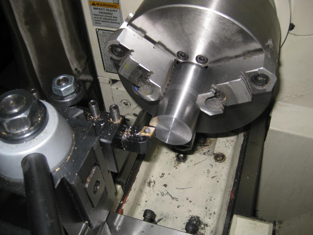

Used the Lathe and the Milling Machine to make the Parts ...
Attachment 2553
Attachment 2554

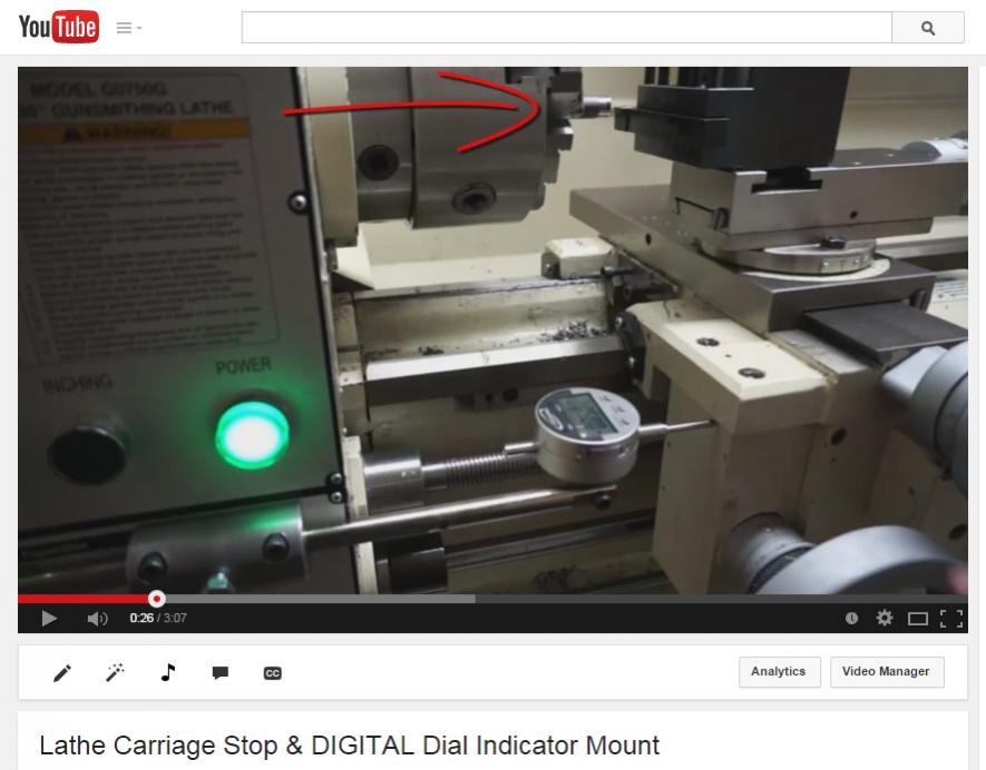

You can see the finished item's first Lathe cuts on YouTube:
http://youtu.be/eqaovH9EijI

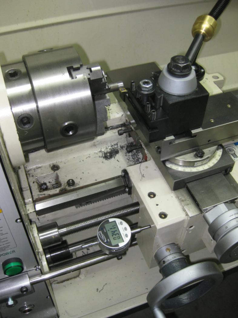

Attachment 2556
Nothing Fancy but it will work for my Projects.
