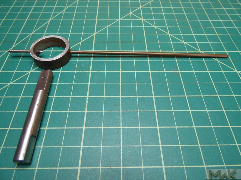

The punch mark is first roughly centered using the tailstock center as a reference. If the punch mark isn't perfectly centered, it will describe a circle when the chuck is rotated. As it approaches centered, the diameter of the circle gets smaller and smaller. Early machinists decided that they needed to magnify the circle so they could more easily center accurately. Thus was born the form of motion magnifier (I call it a "wiggler") shown in this photo...
Attachment 48932
The steel rod with the small hole in it is mounted in the tool holder and adjusted so the hole is close to the lathe centerline; the tailstock center can act as a reference tor locating it. The point inside the circular piece is placed in the small hole and the point on the left in the picture is placed into the punch mark in the work. With this arrangement the point on the long rod on the right will describe a magnified circle as the chuck is rotated. The chuck jaws are then adjusted until the magnified motion is eliminated as the chuck is rotated.

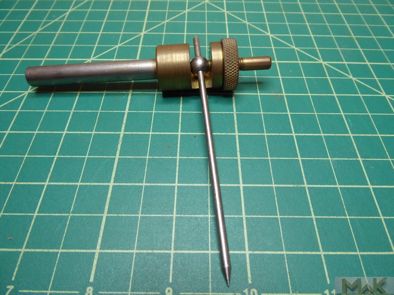

I built this device early in my amateur machinist career. While it had the advantage of not needing a then expensive DI, it quickly revealed its shortcomings. It is beyond fiddly to set up. Having seen the Starrett version of this tool (No. 65) by this time, I decided that if the indicator rod was supported by a sphere free to rotate in two axes, the device would be a single unit that wouldn't fall apart at the slightest disturbance. Thus was born wiggler version 2...
Attachment 48933
Definitely easier to set up. However, if you want the wiggler indicator end to point to the tailstock center when the punch mark is centered, the wiggler pivot point must be on the lathe centerline. That and the fact that neither wiggler is useful for centering holes means that we haven't yet achieved perfection.

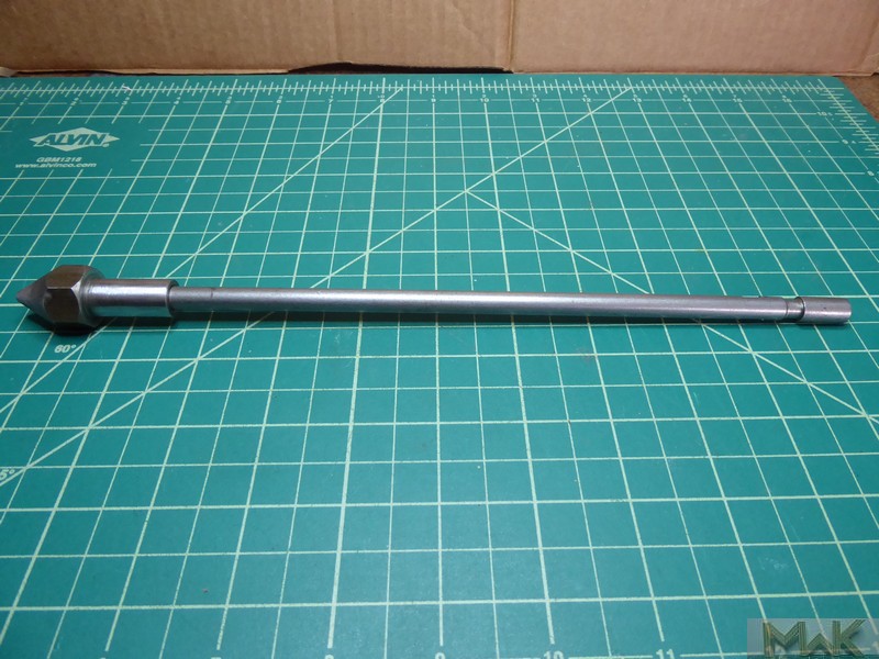

Then a retiring "real" machinist gifted me a pump center. I quickly realized that it, with the addition of a DI, solved all these problems. Easy to set up and the spring-loaded end kept it in place. Its pointy end tracked the punch mark and the DI, mounted on the tool holder, measured the motion of the punch mark.
Attachment 48934

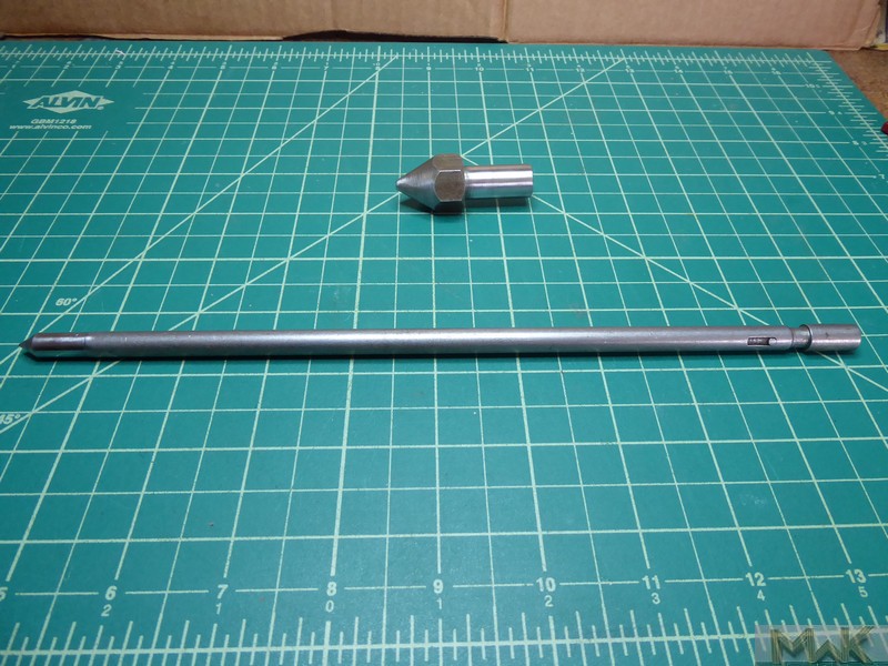

And, with the addition of a turned cone that slipped over the pointer end, it could be used to center holes.
Attachment 48935
An inexpensive import DI is fine for this use since it is only acting as a sensitive motion sensor, not a measurement device. That said, I always recommend the pump center approach to this problem. Nevertheless, motion magnifying "wigglers" have applications elsewhere so keep them in mind.
