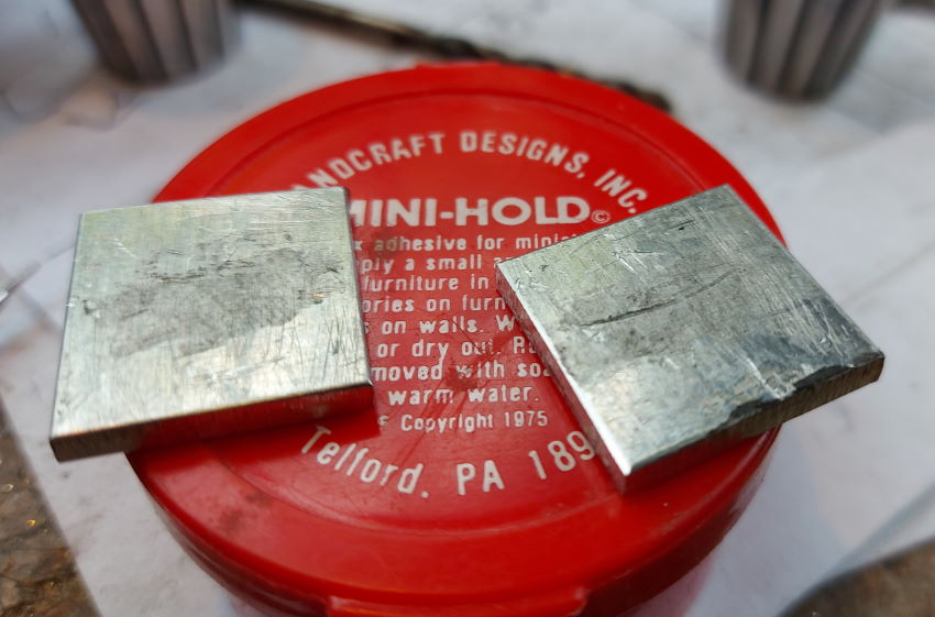

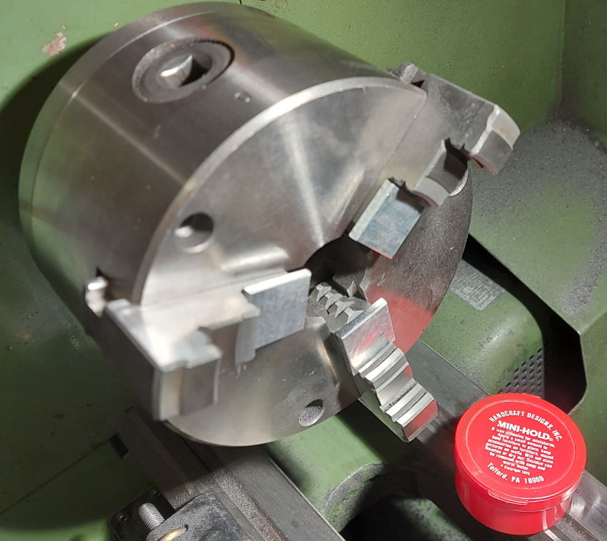

How many times do you use lathe chuck spacers? How do you keep all of the spacers in place whilst aligning the workpiece in the chuck?
Attachment 38526
My solution was to use a very thin layer of wax, I used Mini-Hold designed for the dolls house world.
I think this is a neat solution for lathe chuck spacers.
