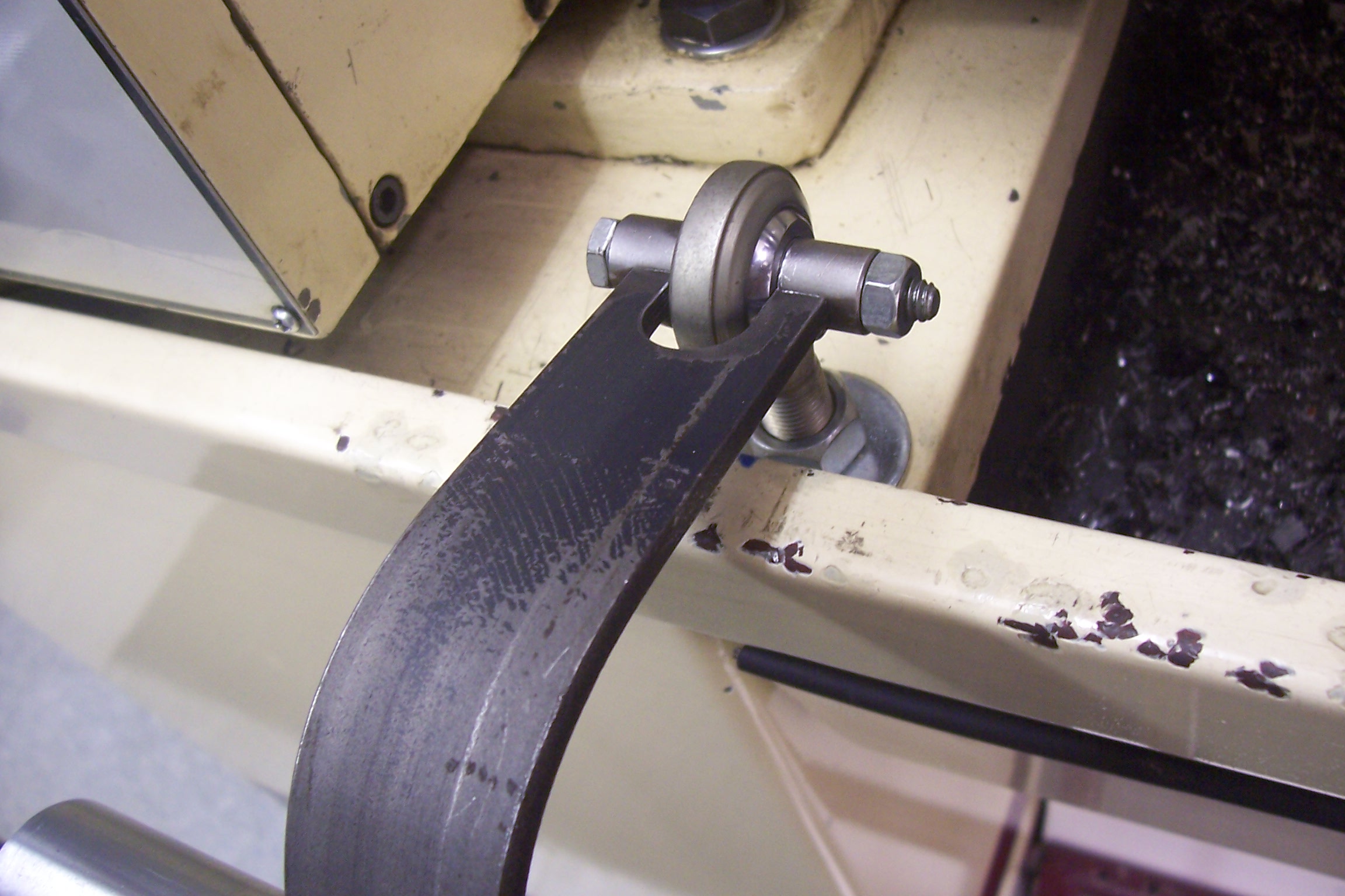

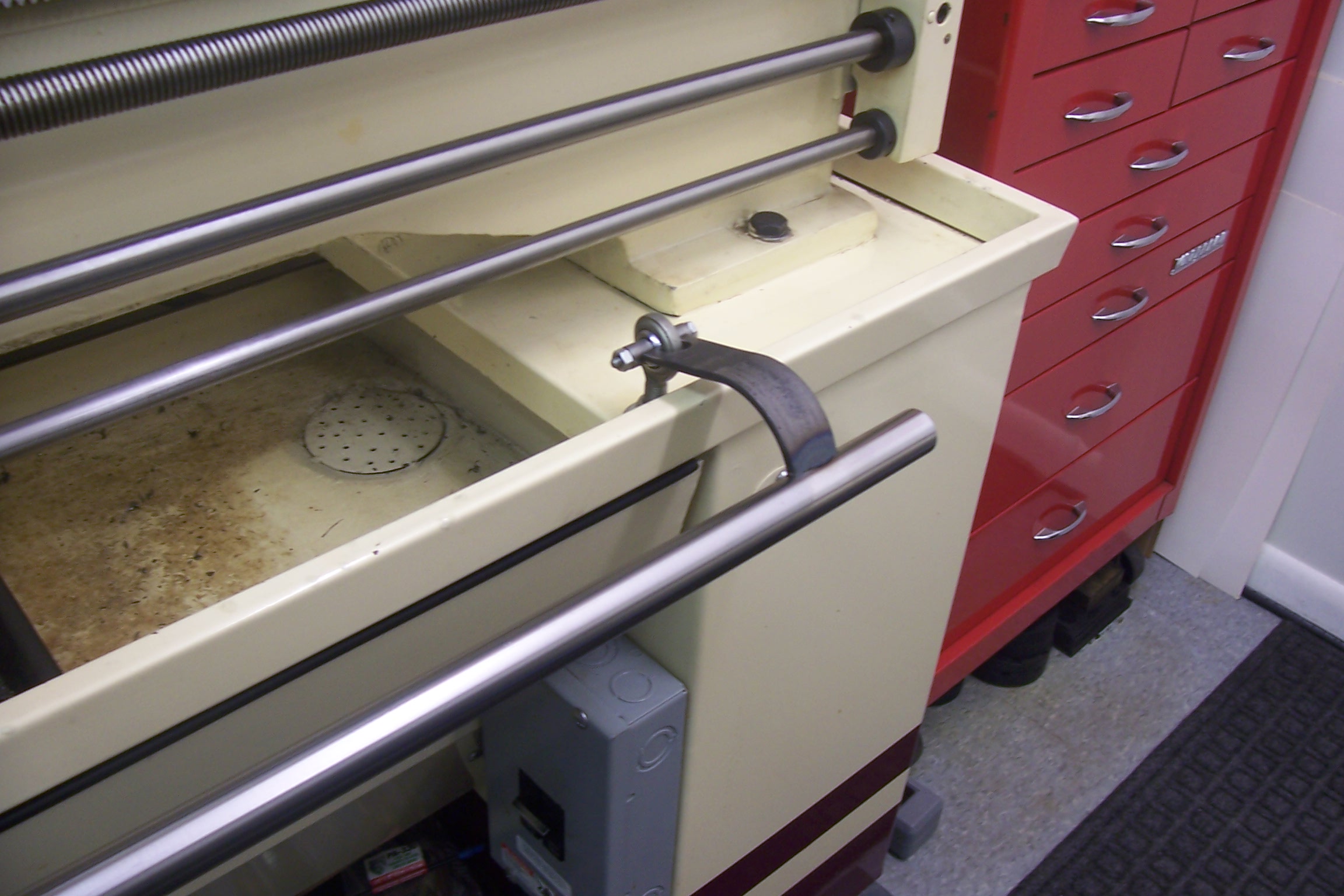

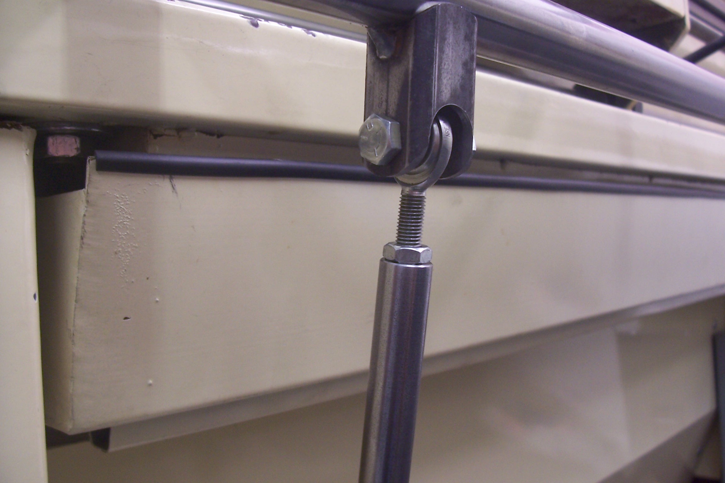

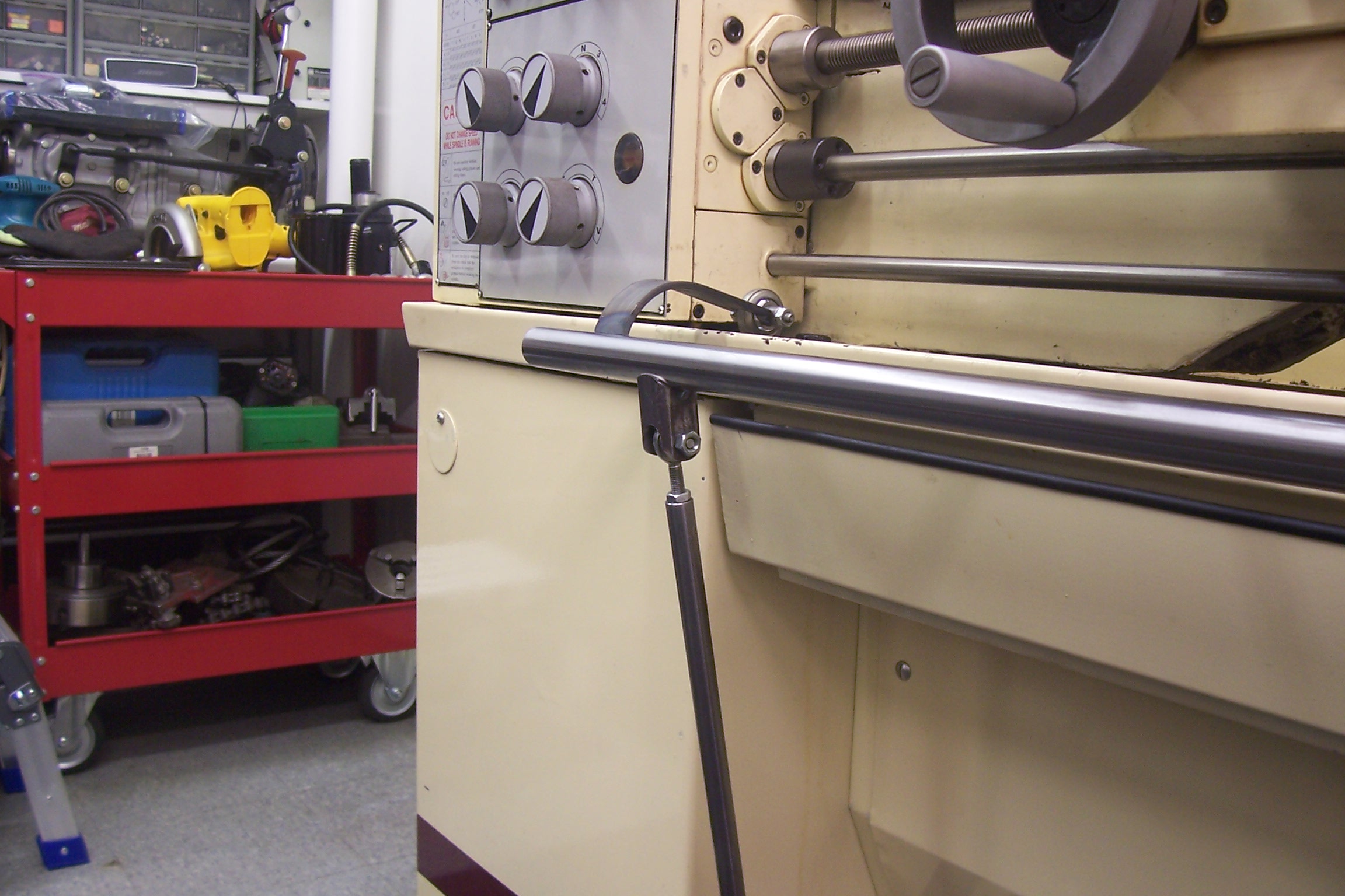

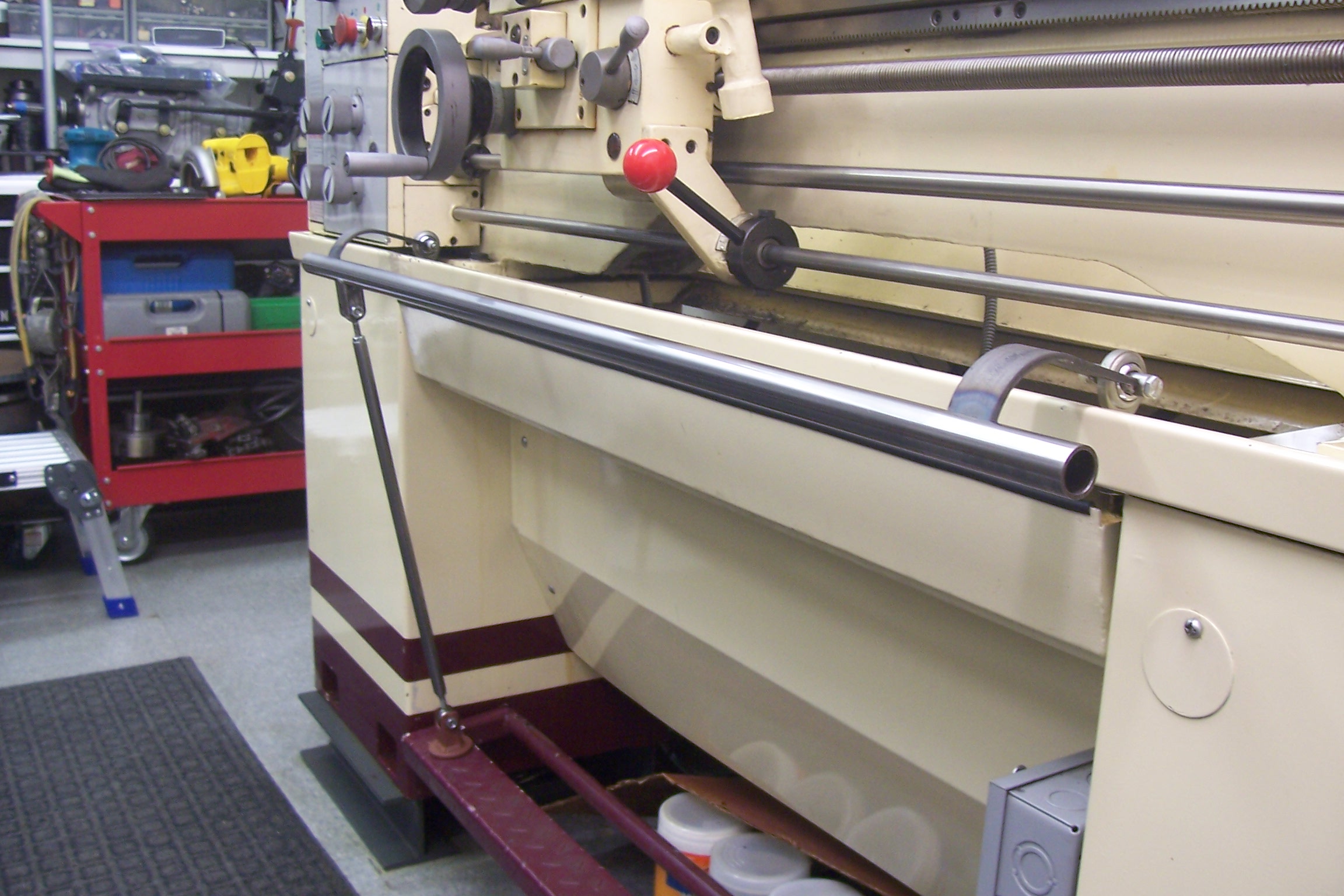

Hi, I would like to show you a mod I did to my lathe foot brake. Sometimes I just wasn't in the right position to stop my lathe by foot quickly so I added a hand bar above the foot brake that is much easier to apply. This has made it so much faster and safer to stop my lathe. Thanks for looking.
Attachment 43977
Attachment 43978
Attachment 43979
Attachment 43980
Attachment 43981
