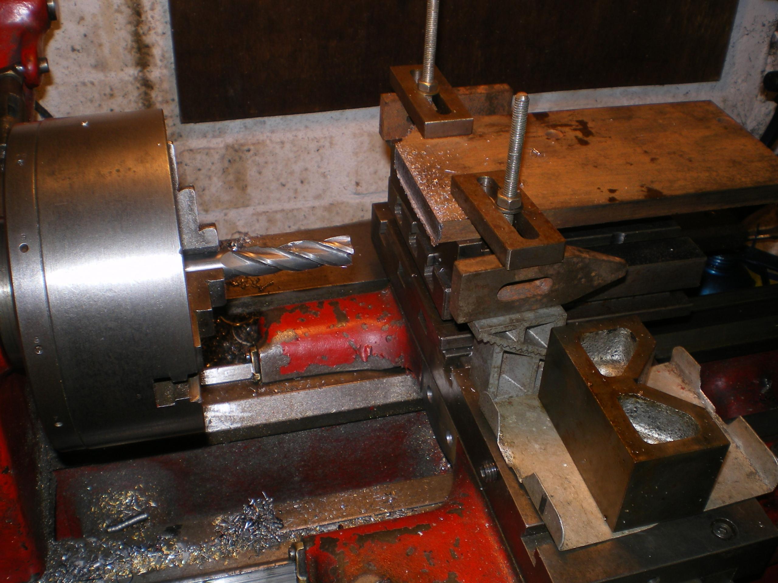

A milling height extension table for a lathe cross slide made from mild steel.
When using a lathe for work it was not designed for I think it needs a bit of help, this brings the work nearer the centre height and reduces the need for packing pieces, it also adds some useful weight to resist cutting forces.
It has enabled me to do some quite heavy milling work, my largest cutter being a 1.5 inch shell mill.
Attachment 13937
Attachment 13938
Attachment 13939

Like all your other projects I like this a lot olderdan. this could possibly be the way to get a project done that a horizontal mill would be more appropriate for. My burning chicken or the egg question is did you mill this on your lathe? Any pix?

While lathe spindles have all kinds of rigidity; 3 jaw chucks on hardened shanks I'd question. Just like never run taps in drill chucks, jaw faces too difficult to restore, especially if serrated.
If a chuck MUST be used, invest a little time on mild steel bushing; collared to sit on jaw face, bored to size, [not just drilled and reamed] tapped for setscrew(s) to engage Weldon shank flats and split one side for compression - almost a collet. Close up jaws, then setscrew. The collar will aid retention of concentricity at far end of cutter. If a Set-True chuck, dial in un-ground shank for runout. 4 jaw even better.
Fact there is HP for shell mills pretty much validates it.

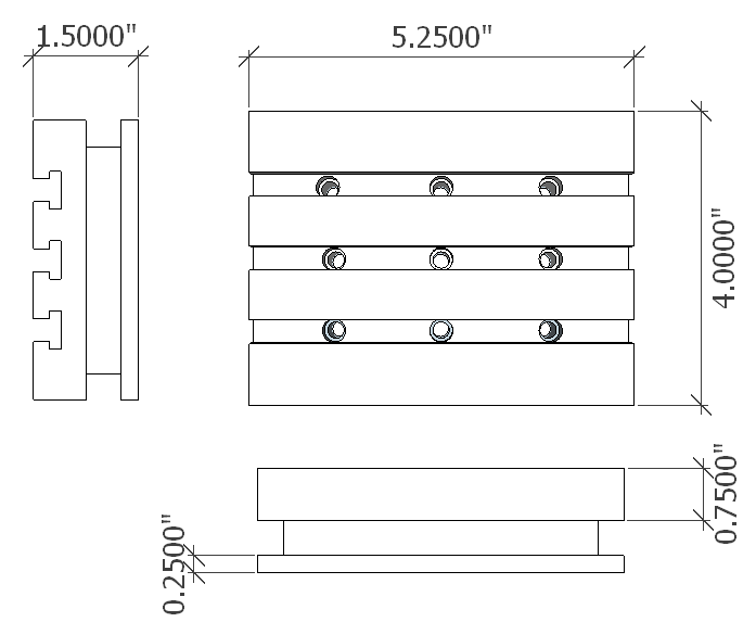

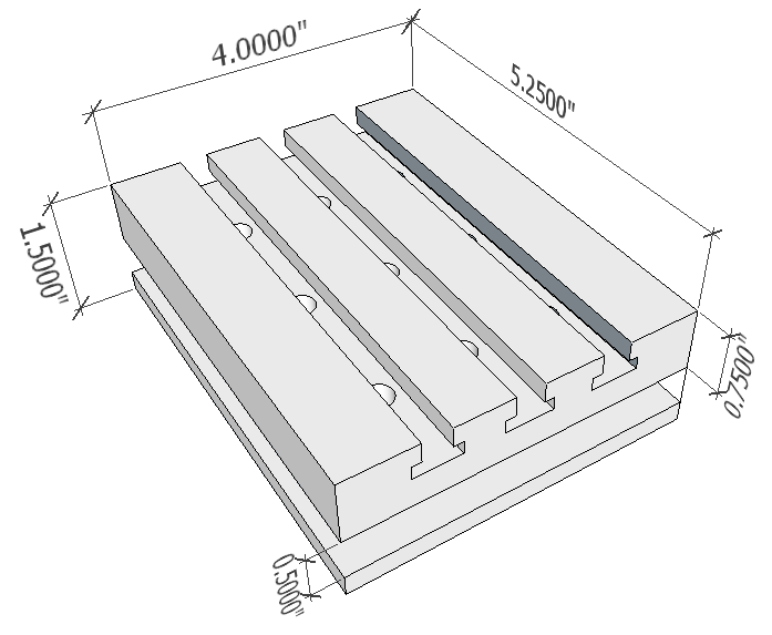

If anyone wants a drawing, please respond so.
Thanks to all for the interest,
The picture was a bit posed, I use a drawbar collet for milling up to 1/2 inch and a 4 jaw for larger cutters.
Yes a mill is ideal but I have never had one hence milling in the lathe.
This was made in the lathe using an angle plate on the crosslide which now has 7.5 inches of travel on full length gibs with a longer feed screw, afterwards I had it surface ground locally.
My lathe is a South Bend 9 inch flat belt with with auto feed from the leadscrew keyway, now driven from a variable speed motor.
I have asked a lot of over the years it but do keep it well oiled and it is still in good shape.
Regards
Olderdan
