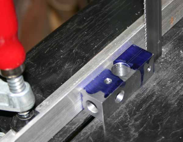

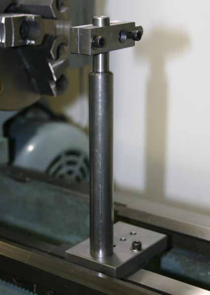

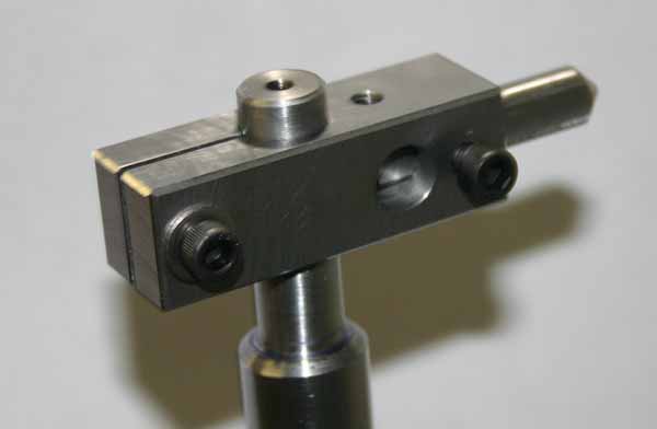

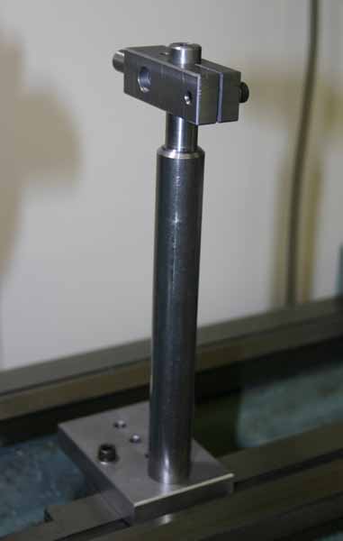

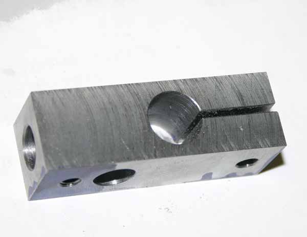

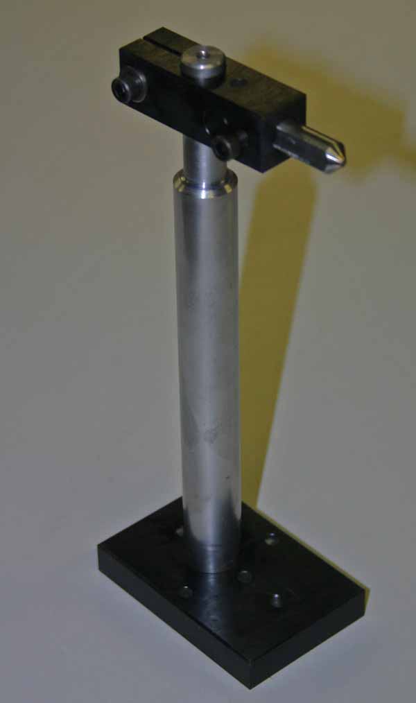

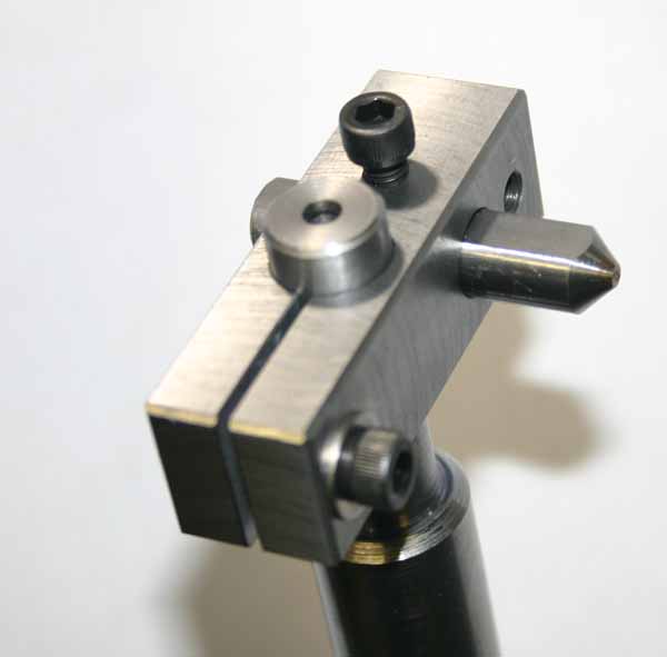

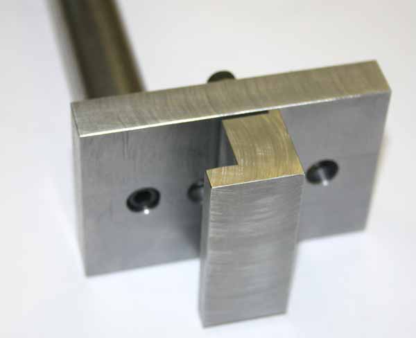

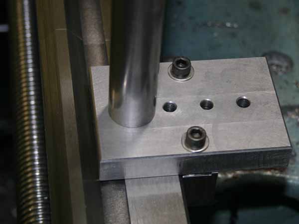

I wanted a quick set & knock down tool for dressing tool post grinding wheels of different diameters & orientations. Just made from on-hand materials. I made the slit for clamp block on the band saw, worked well.
