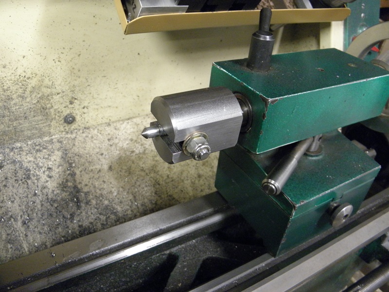

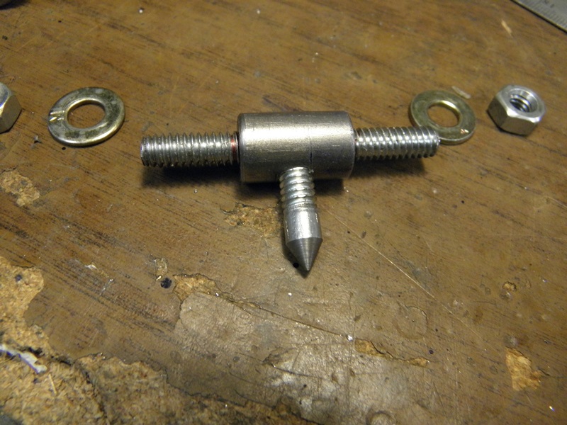

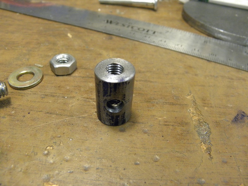

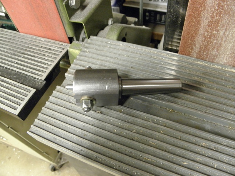

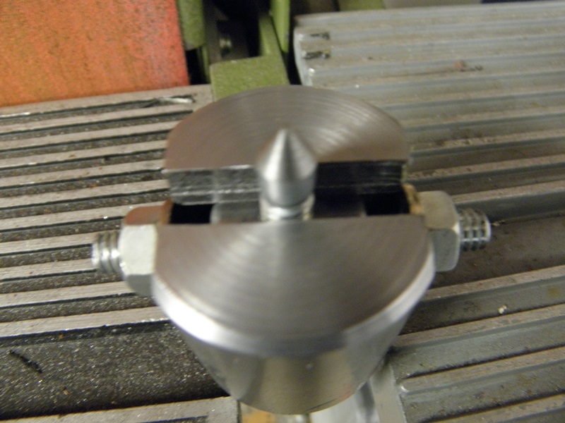

Lathe offset tail stock uncenter. This is a dedicated off center tail stock for making # MT2 Morse tapers. once its set no more messing around. The morse taper is a store bought one with threaded end 3/8-24
