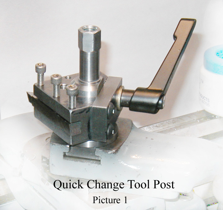

I must totally agree that the first thing for any kind of work is that the tool post must be as solid as possible. Of course this is specially true for parting. The idea of a tool post that keeps the tool in line with it's own center is interesting but, having designed a QCTP myself, I do not know how that would be accomplished. The lantern style does that, but it suffers a lot in the process and leaves a lot to be desired in terms of rigidity.
I also do not like the design of the tool posts that use a dovetail to fasten the holders to the post. These dovetails, in addition to having the tool offset to the side of the post, rely on a couple of relatively small areas of contact between the post and the holder. The piston design is the worst in this regard. In either case, the total area involved is well under one square inch. And the post itself must have a mechanism inside it to provide the clamping/release action so it is hollowed out to a certain degree. All of this allows a certain amount of movement of the holder and even the post itself during heavy cuts.
I believe my design provides the most rigidity of any QCTP that I have ever seen. It uses a solid steel post where the only material that is missing from the interior is the central hole for the mounting stud. And this central mounting stud places the post itself in compression mode of stress, much like pre-stressed concrete so it actually adds to the rigidity of the post. Then the holders are held in place with a complete, 360 degree wrap-around design. When they are tightened in place, they are in intimate contact for their full height as well as for the full 360 degrees of wrap. This provides many square inches of contact area and there is little chance of the holder moving on the post.
Attachment 22426
In short, the post and holder with this large contact area between them, become much like a single, solid piece of steel. On top of this, the repeat-ability of the tool's position when changed is excellent in all directions, well under 0.001". And it really lives up to the "Quick Change" part of it's name. The tool holder can be unlocked and removed with ONE HAND in a SINGLE, FLOWING MOTION. No tools are needed to remove it. And the new holder is installed in much the same manner, again with NO TOOLS. No wrench or Allen key, just your ONE HAND. The design of the post with a generous chamfer at the top literally guides the holder onto the post. I can not see how any manually changed tool holder could be faster. In a production environment that would save valuable seconds at each tool change.
To answer the most often asked question about this tool post, YES there is a height adjustment. It is hidden in the hole on the top of the tool holder. And it does not require any locking nuts or screws, it just holds the adjustment on it's own. Another time saver: just adjust and go.
The plans for this holder are available here on this board in the Tool Plans For Sale forum. In addition to complete drawings, they discuss the construction in great detail. Oh, and the design is for an 8 to 10 inch lathe, but it should easily scale for larger or smaller machines. So if you have a 14" or 16" lathe, just multiply the numbers up and perhaps make the post a bit longer.
http://www.homemadetools.net/forum/q...st-lathe-52118
I have included a cutoff tool holder in those plans, but it is not a spring type design. It relies on the rigidity of the post and the lathe for proper cutting action. It is good, but not perfect. After reading this thread I want to try to make a version of this cutoff holder for my QCTP. If that is successful I will post the results and drawings in the discussion at the link above for all the users of my post to use.
Valid observations Paul Aliciatore. I am torn as to the wedge issue. Imports have details that make them seem second rate. A set is on lathe at work. I can feel a lessened positive action and clamping compared to ancient Aloris on my personal lathe. It is very consistent, making an easy job of presetting for the DRO.
The import's different story. I'd rate +/- maybe .002 of all it's tool holders. I don't even like the set screws, the elevation screw, nut and female hole aren't very well executed, closing the wedge feels indefinite. Import is 250 size BX, mine are 400 CA's, roughly double the mass and locking area. Import also doesn't have equal quality insert and HSS tools.
All told and IMHO no commercial set equals double vee'd style mentioned. They are not common here at all, never been in a shop using them. Bought first block and a few holders out of curiosity; using them best advertisement possible.
Your design is excellent, addresses every fault of conventional QCTP's. Had I not invested so much on holders the plans would be in my library.
