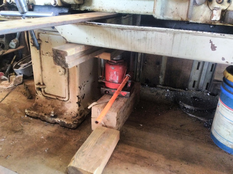

I blocked between the chip tray and the bed then blocked under that and a hydraulic jack to lift the power end up a few inches then the off end as well

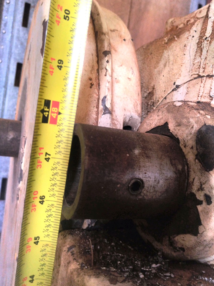

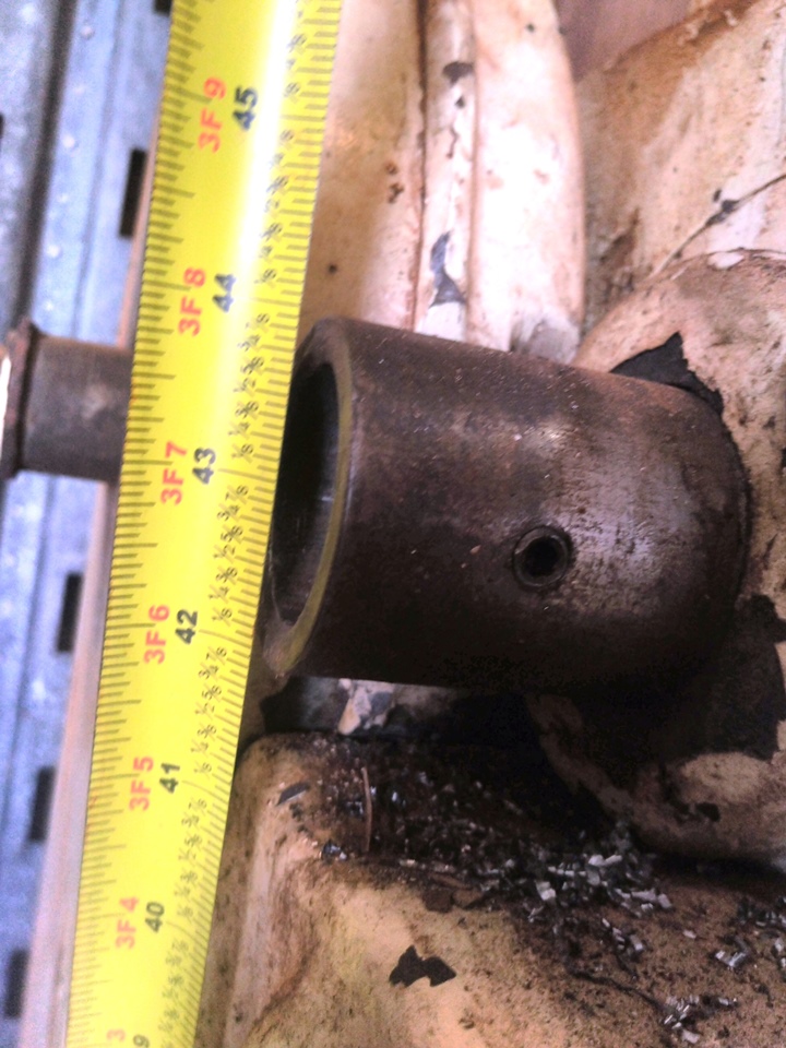

Spindle height before

Spindle height after
Attachment 40881
Blocking and jack

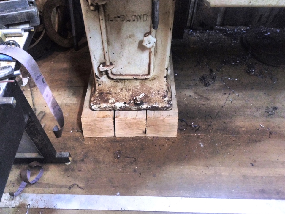

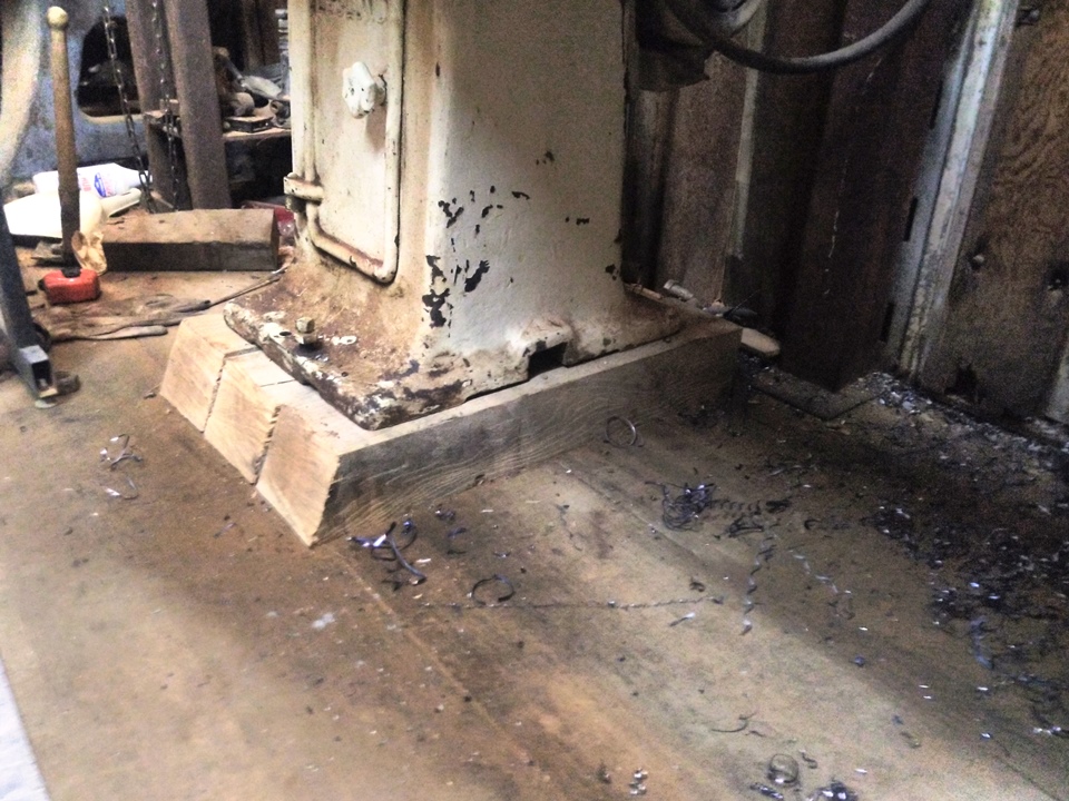

riser blocks 4x6 OAK

After 3 days of running the lathe at least 4 hours per day I can say this. It is all about comfort. even where the chuck key is kept is more comfortable to grab as it is just above fingertip height, so using the socket as a handle puts it square in my hand with no bending or reaching.
The feed rate change levers are easier to reach, the carriage handwheel is now high enough that when the handle is at the bottom of rotation I still don't have to stoop down.
All in all I like just about everything that goes with the change in height, now I just need to find the time to elevate the other 3 lathes in the trailer
