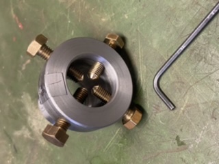

I have finally got around to making a lathe spider, rather than using rags or pieces of wood jammed into the back of the headstock spindle to stop long pieces of material flailing around.
I wanted it to be quick and easy to install and remove. So based the locking method on my lathe spindle backstop. Link to backstop:https://www.homemadetools.net/forum/...ack-stop-66400.
Both the main body and the locking wedge are made from mild steel off cuts held with a M6 countersunk screw loctite in position. To jack the wedge a M6 grub screw is used. To ensure a good slide fit in the spindle, both pieces are machined together.
The spider is fitted with 4 standard M8 brass screws turned down to 45 degrees at the end to enable small diameters to be supported.
I wish I had made one years ago but it is one of those jobs that you will one day get around to. But now I have it there is no more making do with rags and wood etc that you never know if they are going to stay in place.

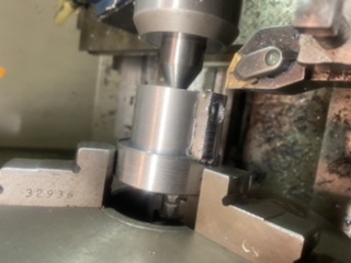

both body and wedge being machined together.
Attachment 43941

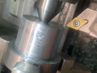

machined to diameter
Attachment 43942

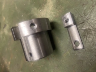

Taken apart to clarify design.
Attachment 43943

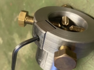

Grub screw used to expand wedge.
Attachment 43944
Finished ready to install.
Attachment 43945

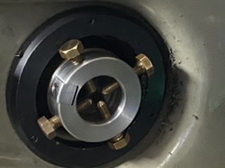

Fitted to head stock spindle
Attachment 43946

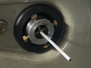

Supporting 1/4 diameter aluminium tube
Attachment 43947
