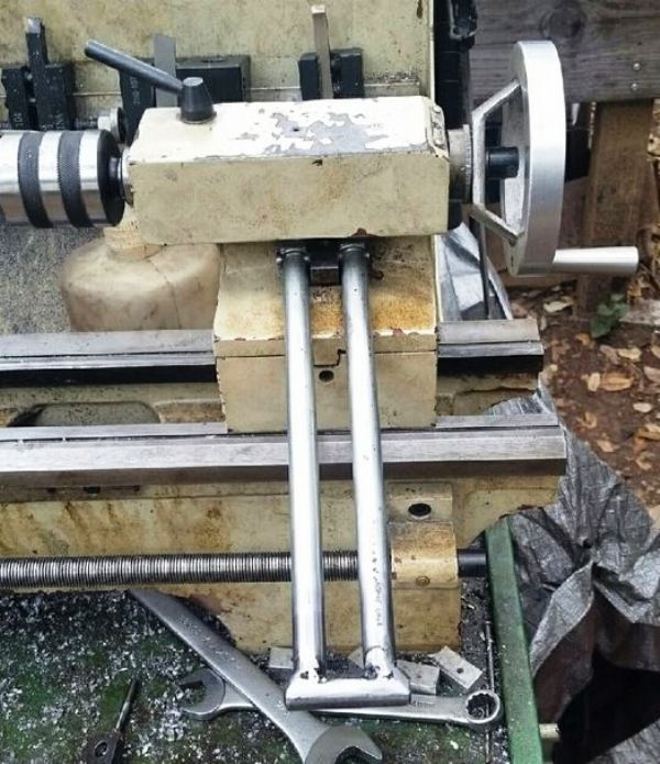

Lathe Tailstock Quick Lock
Since I've been on a jag getting around to things I've been meaning to do I made a quick lock for my lathe's tailstock from 2 12" bolts and a piece of 3/8" scrap from my pile. The bolts had the sides of the heads sawn off flush with the shank so they looked like a T from the side, then cross holes were drilled in each one. Then I cut a small piece of 3/8" plate, turned trunnions on each side which go into the lever holes and finally threaded a hole in the center for the long clamp screw which used to clamp my tailstock down. A bit of rounding on the belt sander of one corner of the remnant bolt heads and a cross bar welded to the bolt ends and Bob's my uncle, and if any wear is experienced I can easily adjust the bolt to tighten the locking force again.
In the down position the tailstock moves freely.

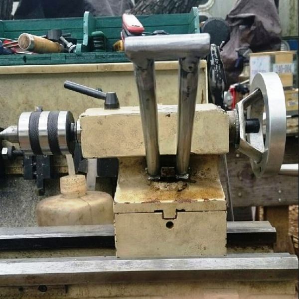

And in the up position the bolt heads apply force to the tailstock base, tensioning the bolt and clamping the tailstock to the ways. The geometry is such that the bolt heads cam over in the locked position so that the lock stays put until I want to release it.
