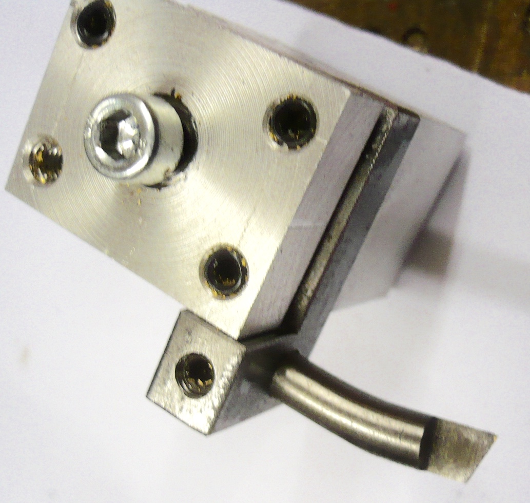

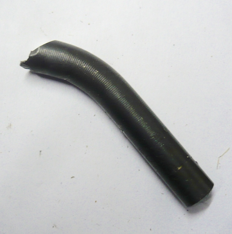

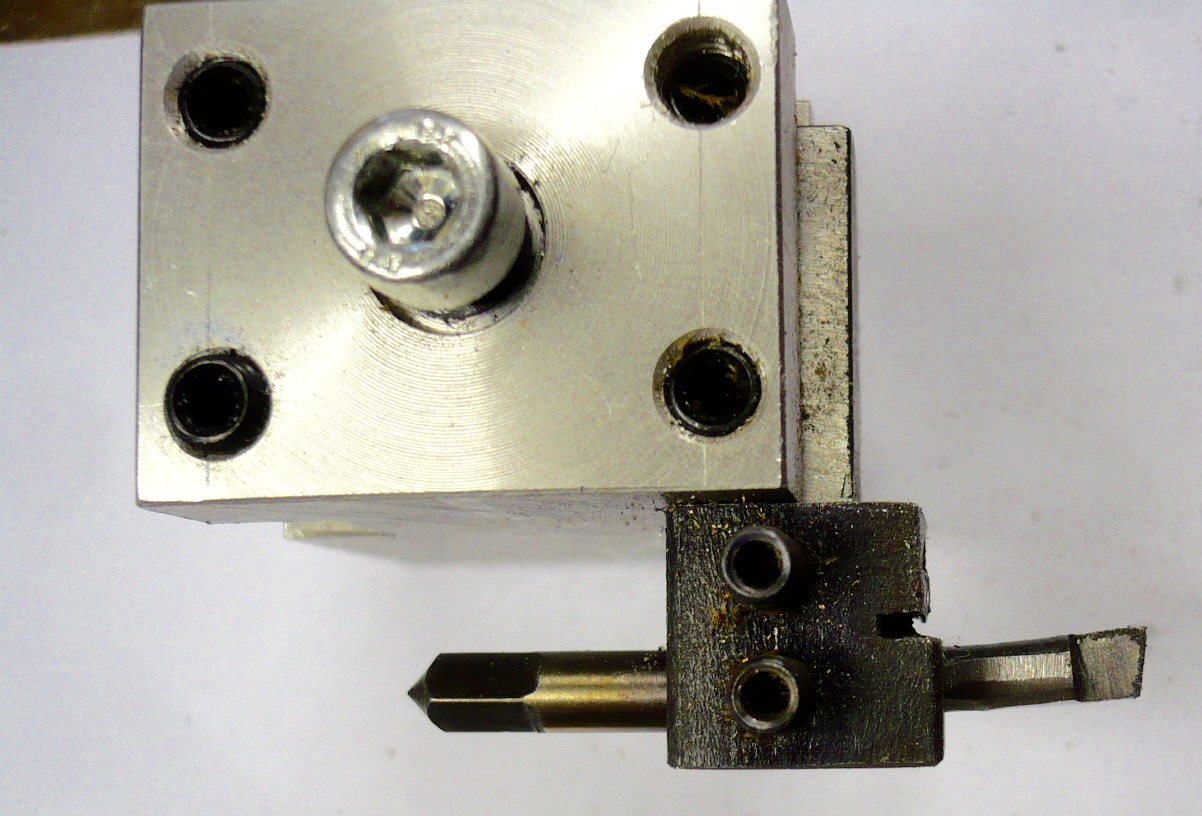

Jon,
I'm using bent twist drills for internal tools. Boring, threading, grooving.
I heat them to cherry red and let them cool down.
I found no degradation of tool life.
Ulrich
Attachment 39580Attachment 39581Attachment 39582
