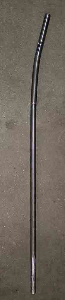

I bumped the power switch while reaching for chuck key I dropped.
A Christmas gift from a shop gremlin... 3 am (I like to go in early and play before I start working for customers) and I am working at my Rockwell 14" Lathe that I have had a love affair with for the last 26 years, we 5started dating when I was 9 and dad would help me get on my stool and get the material in the chuck... Anyways, so I am working with a 44" 3/4" stainless steel solid bar. As I inserted the rod I dropped the chuck key. I had a tape measure on my belt that decided to turn the machine on as I reached for the chuck key. For a split second all was well, I realize what I had done and reach to turn the machine off. At that moment, the rod decided to go for a swing and it hit me on my right forearm. As I descend to a lower level I manage to turn the machine off. I am not sure how long I was on the floor, but when I got up I had to make sure the machine was not damaged, the ways didn't have any dents and the chuck was not harmed from what I could tell with one arm and a SPLITTING headache (I think the rapid stop with the concrete and my skull caused this). I get to the door and meet my partner in crime, Dad had come to work. He helped me get to mom, a nurse, and she then called my doctors office to get me in. I've been to the ER in the past and I won't pay another $3500 for a xray and 4-6hr wait while begging people to kill me. Long short, I have health issues and my medical record looks to be as thick as the tax code book...

LONG story I know, but it does have a meaning, NEVER let the machine come to life without having the material secured and chuck tight.....
