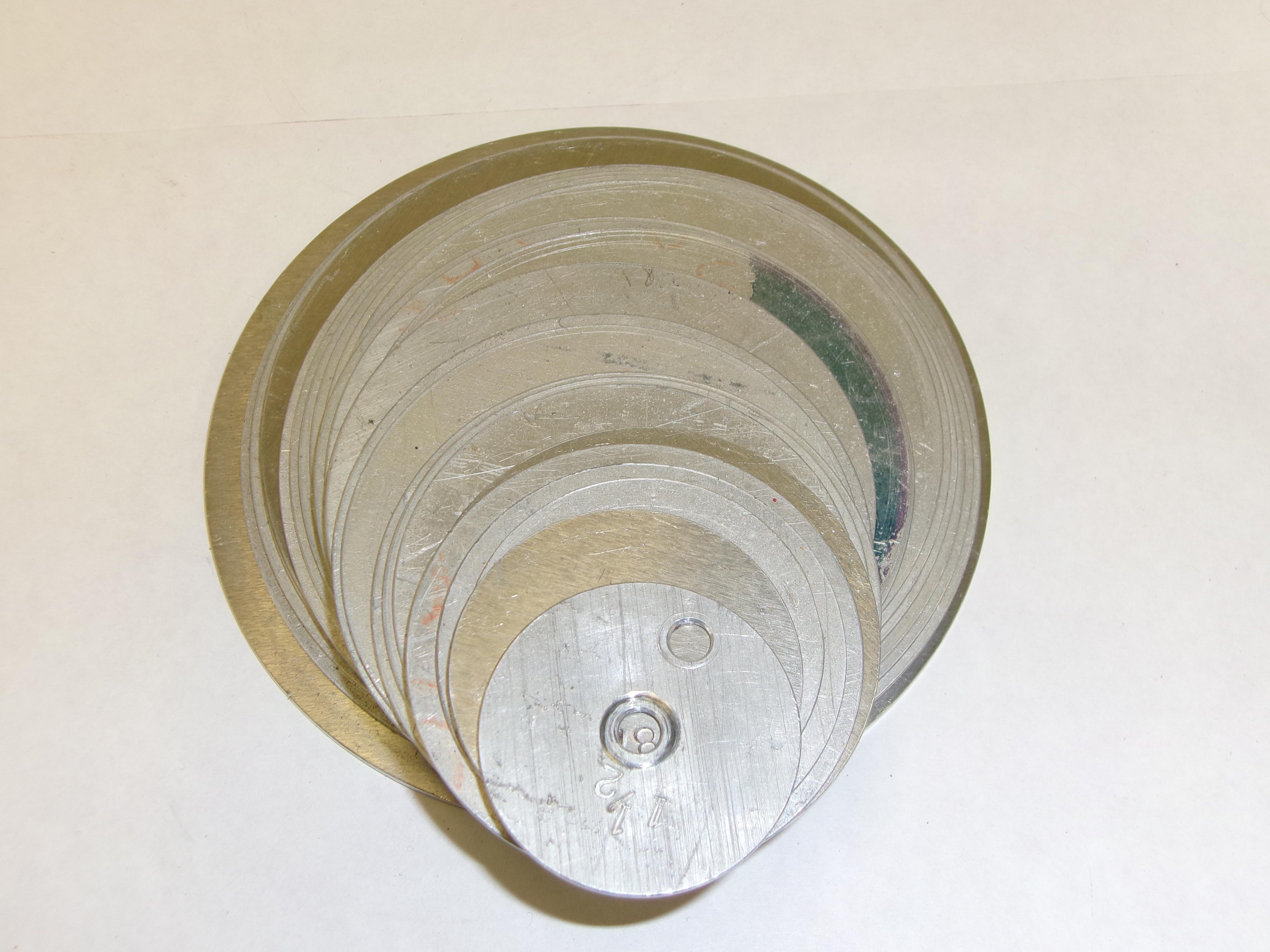

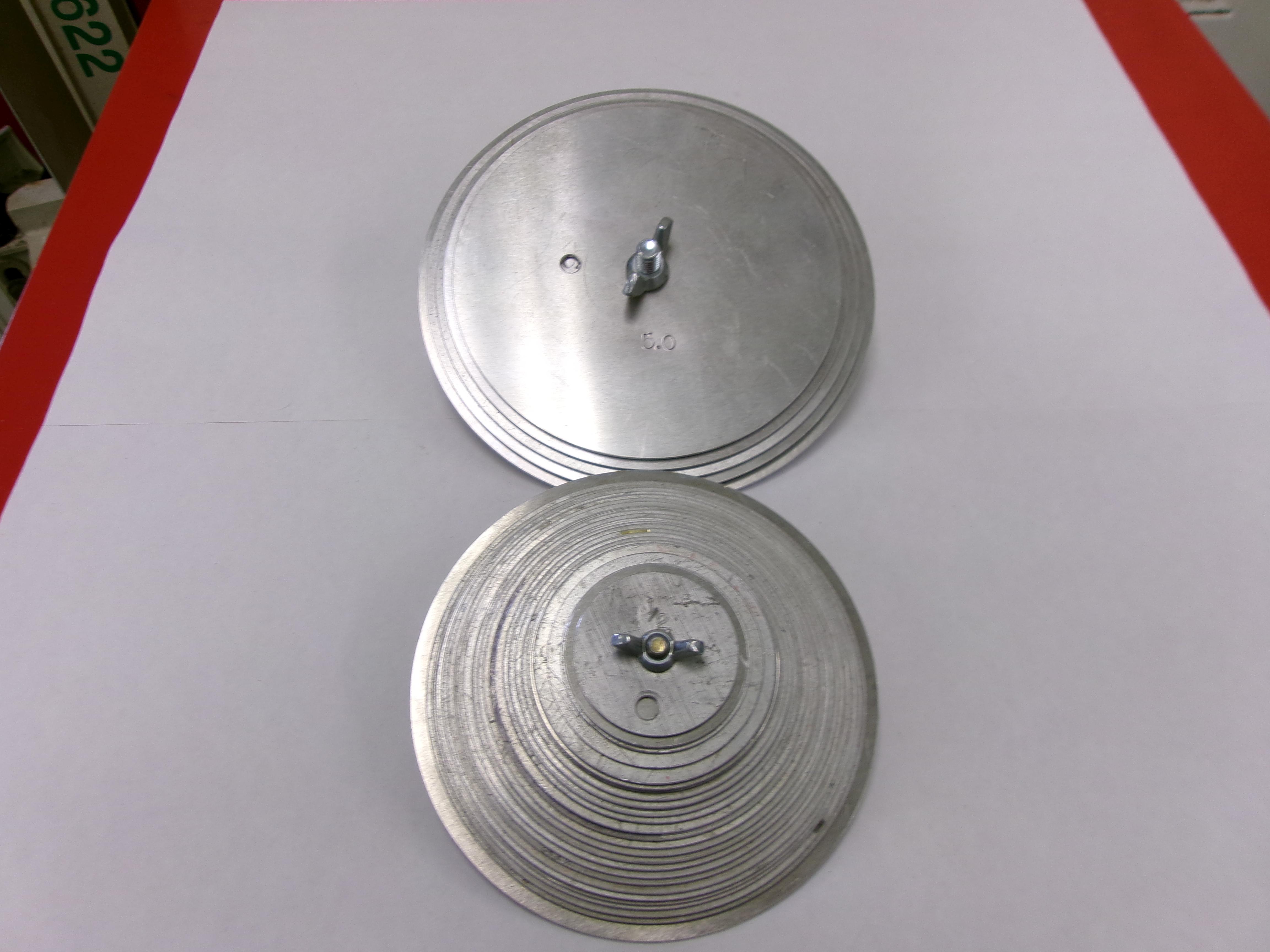

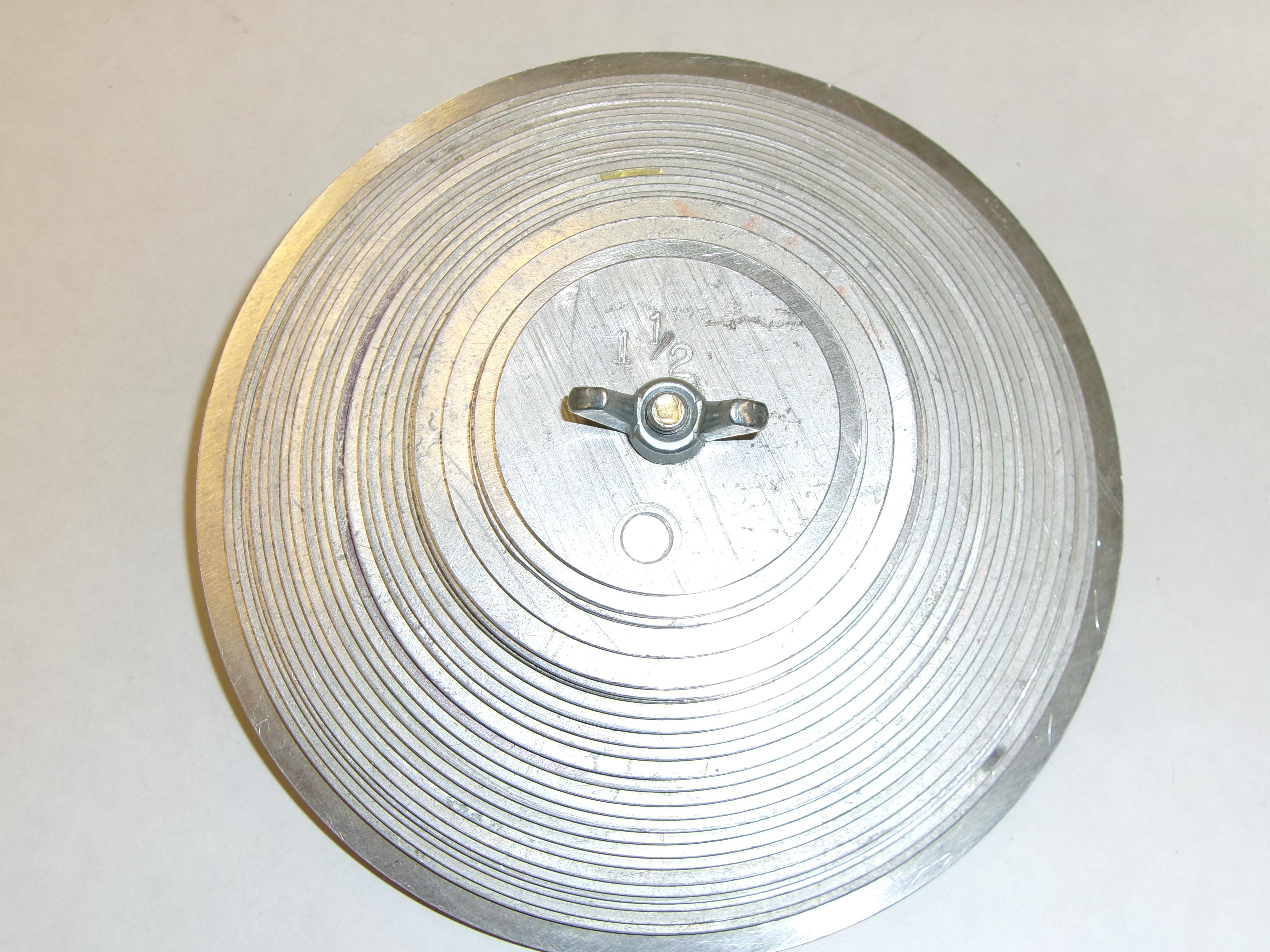

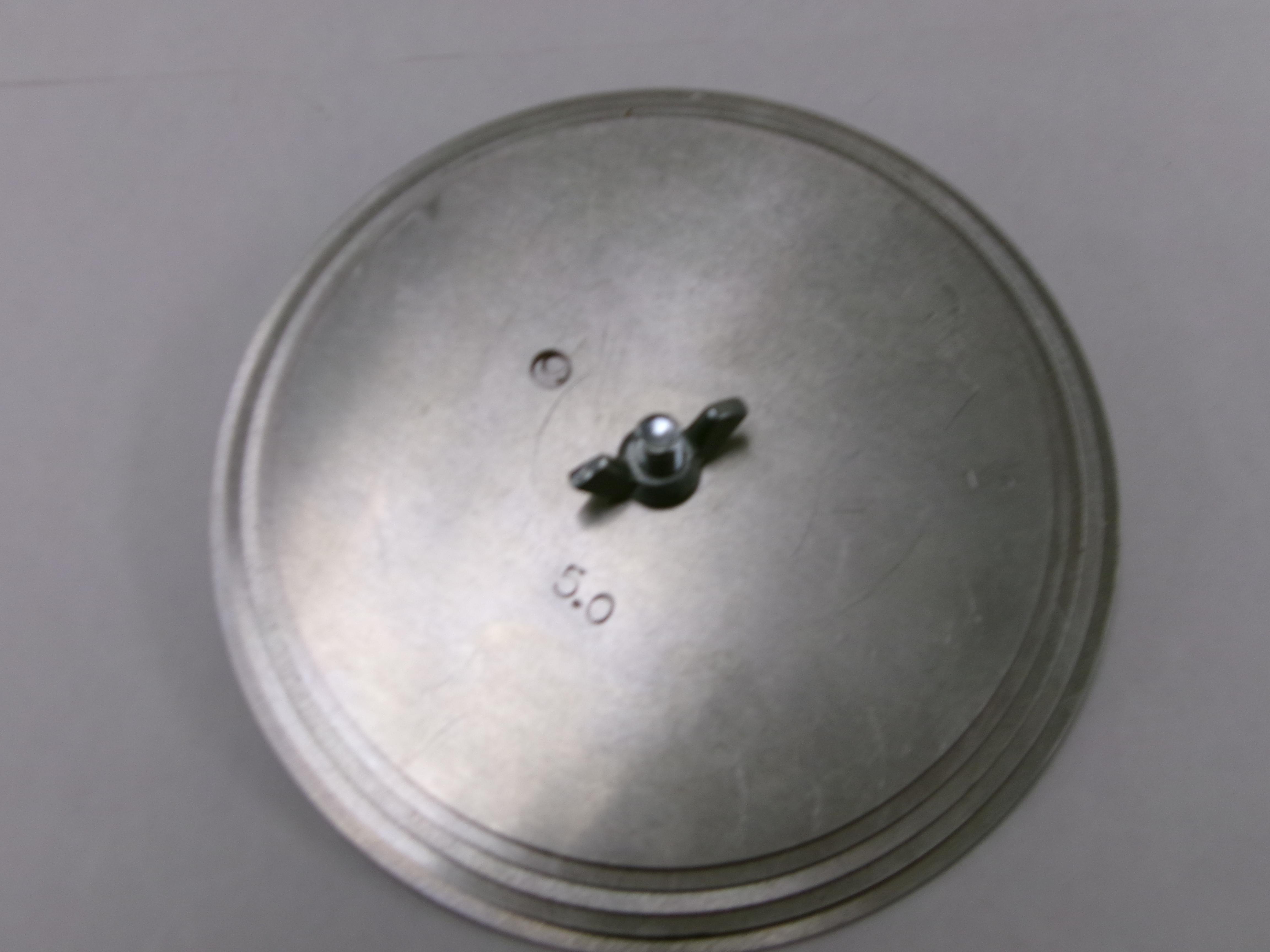

Here is a simple and useful aid in fabrication of sheet, plate and wood if needed to construct a radius at intersecting lines. Made from remnant aluminum sheet stock mounted to an arbor and turned to the required diameter on a lathe.
