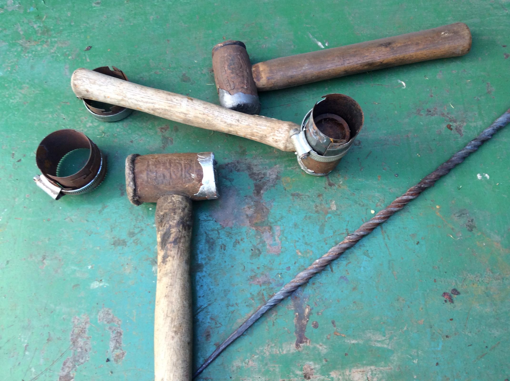

    Although it doesn’t last very long, I prefer to use a lead hammer when for example, scrolling material that’s twisted, to avoid marring it. A wooden mallet is too light and a hide mallet smokes and smells, and a brass or copper hammer is too dense. The hammers depicted will last a few sessions though and the mushrooms are easily removed, far easier than a copper insert. Hide inserts are fairly durable, but drop out, which is why I have these.
    As you can see, I hope, I take a cheap holesaw blade, tighten up a hose clamp, in order to make a form in which to cast the lead. NB Donning leather jacket, leather apron, gauntlets and visor beforehand. Tuck feet beneath an open drawer in case a droplet penetrates jeans and disappears behind tongue of boot. Which has happened more than once.

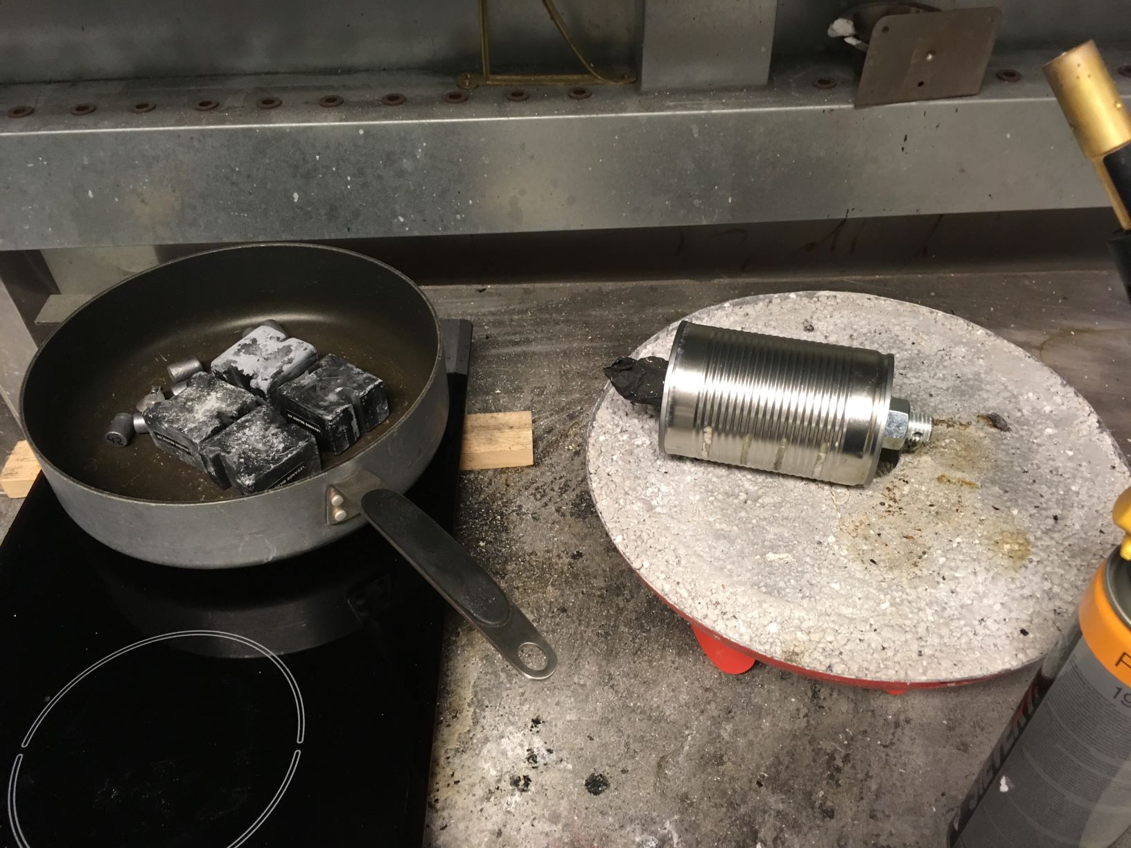

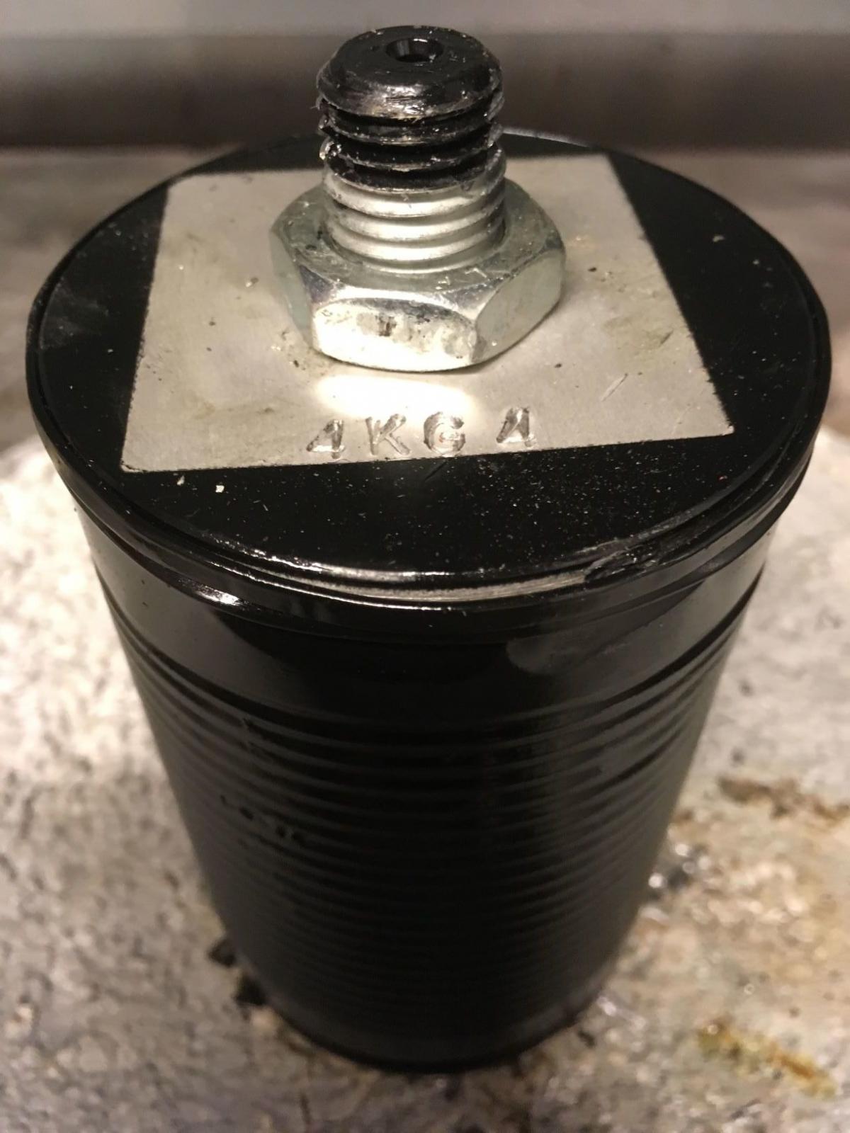

    Filled a crushed tomato can last February to easily achieve a Q & D 4,4 kg point load weight for a colleague,
    instead of his suggested "Just turn away 55 % of this free cast iron block I brought you":
    Lead hammer (lead cast to replace hide insert)-4.4-kg-lead-can.jpg Lead hammer (lead cast to replace hide insert)-finished-point-load.jpg

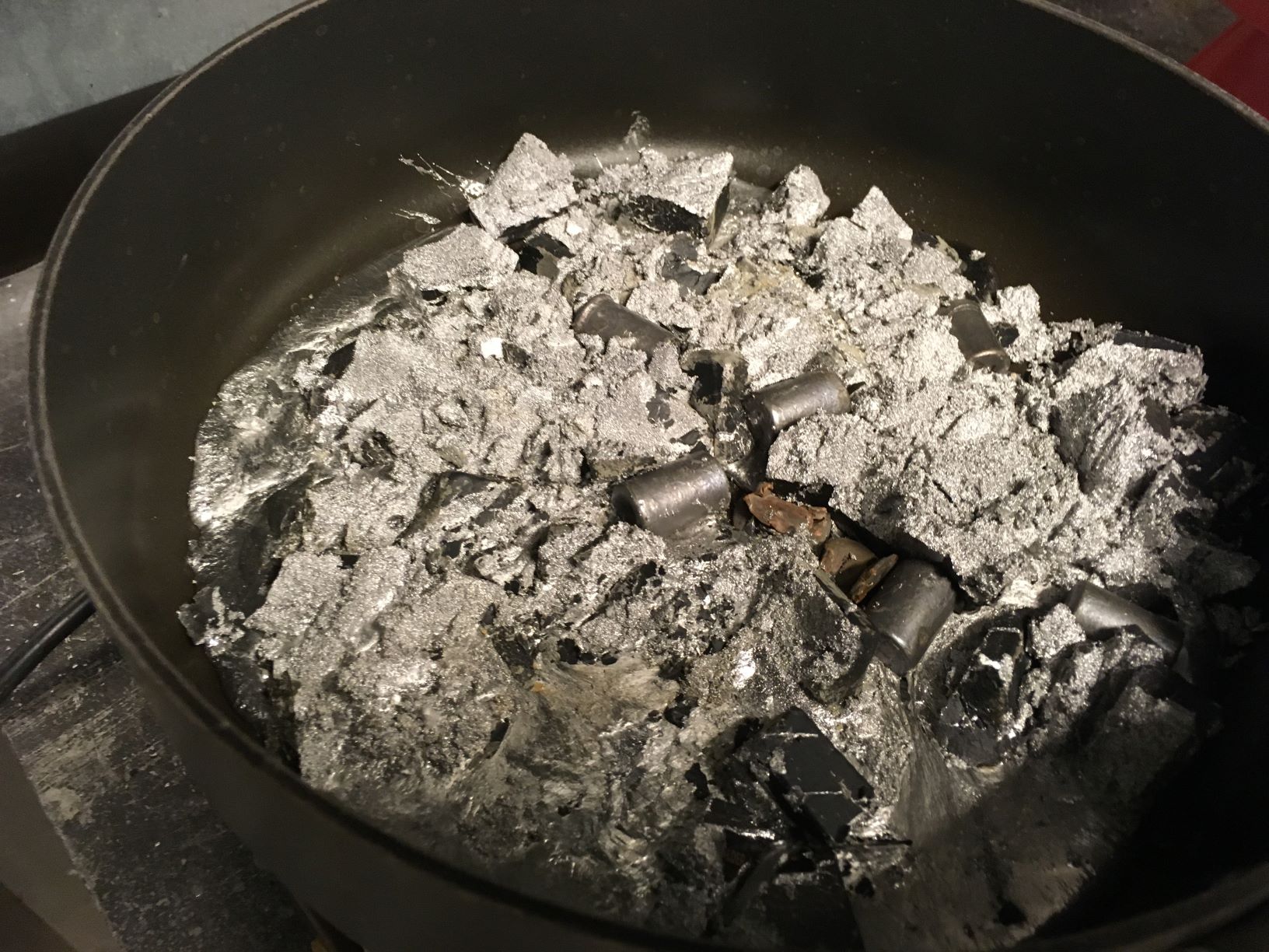

    How to:
    Use a gas absorbing respirator and PPE as you already stated.
    Melt on a stovetop in an aluminium saucepan, though it takes some time and is tedious
    as the heat conductivity of lead is pretty bad, spoon out the dross and pour in mold/ into billets.
    Lead hammer (lead cast to replace hide insert)-lunchtime.jpg Lead hammer (lead cast to replace hide insert)-lead-melting-skillet.jpg
    Just my thruppence worth
