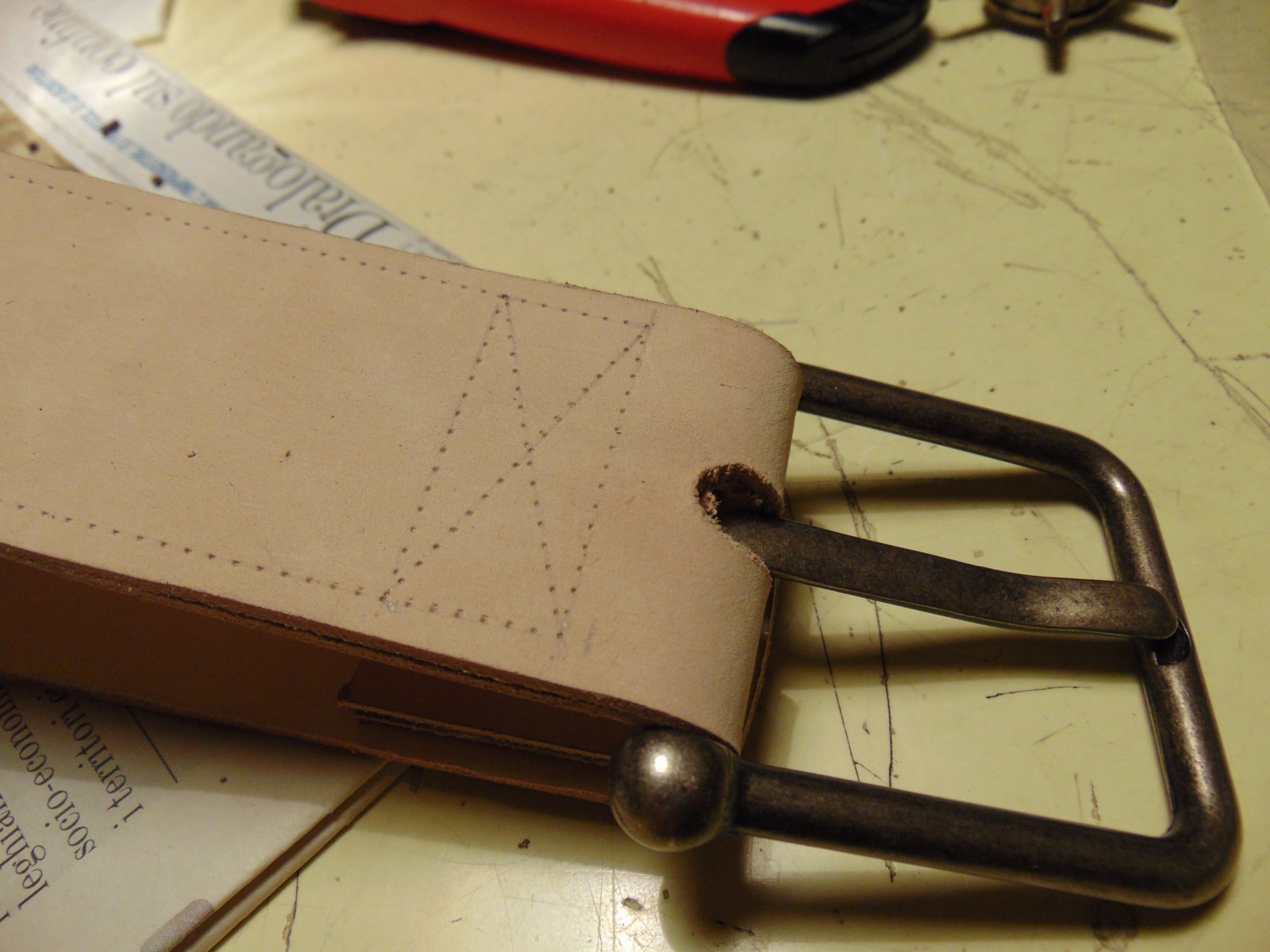

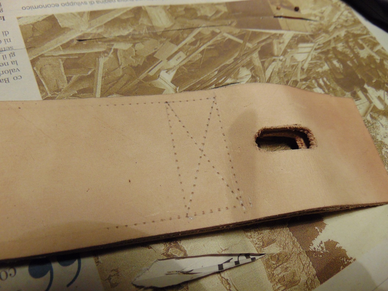

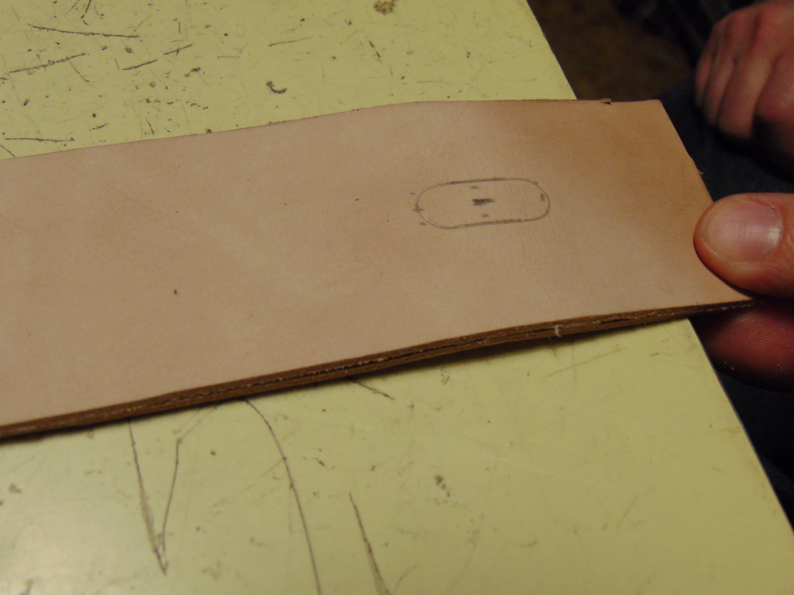

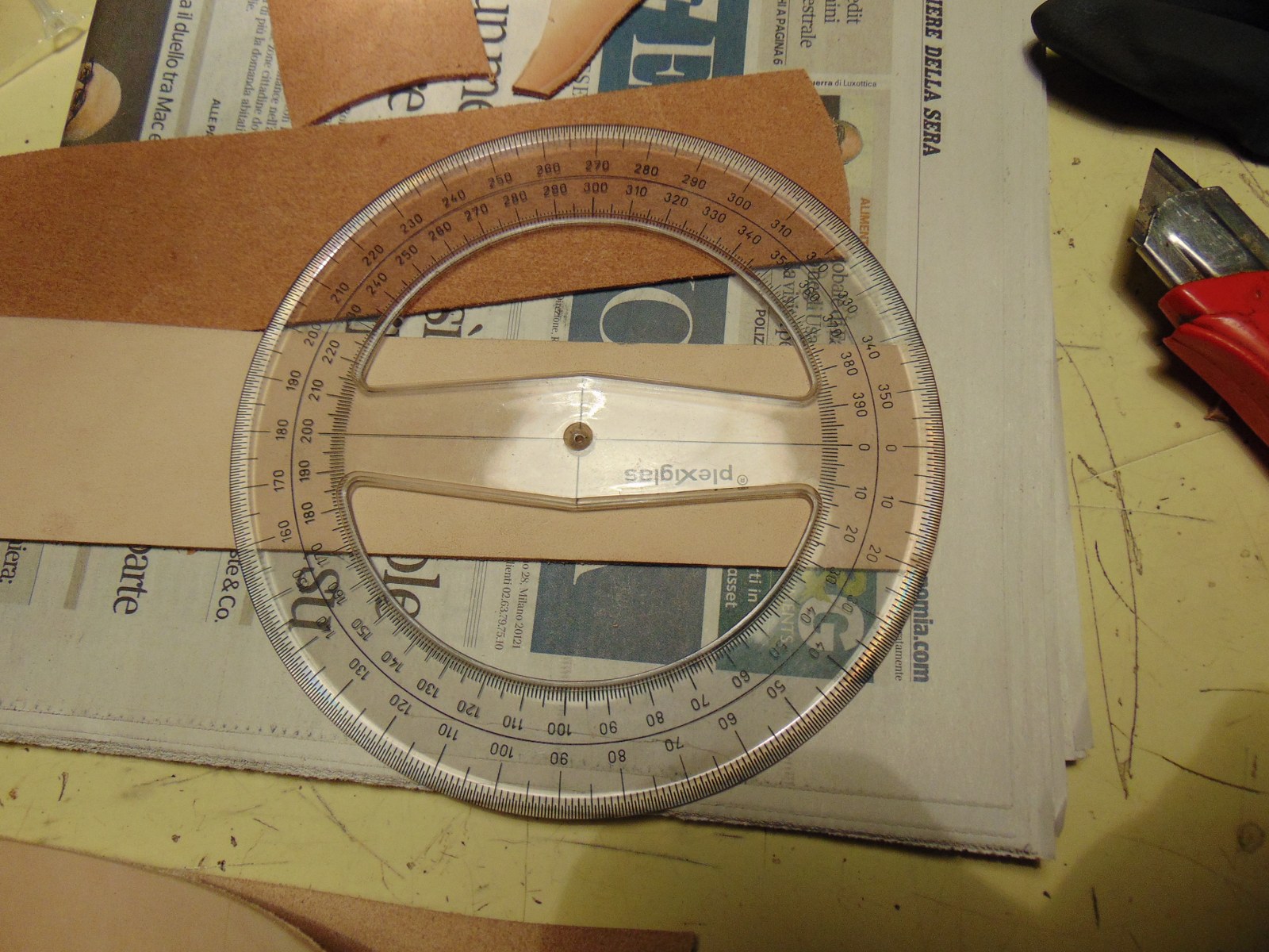

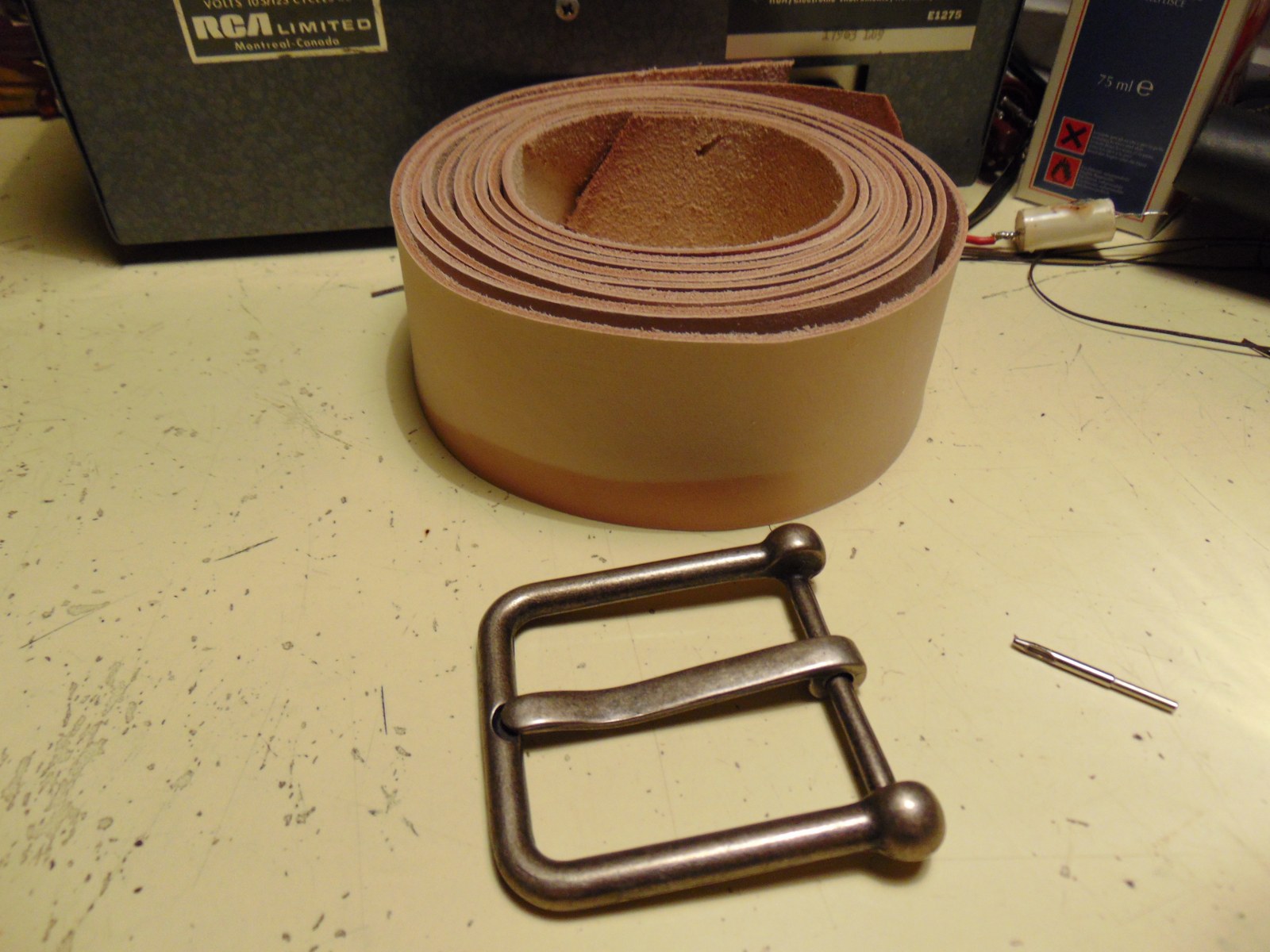

Today I started pasting the two sides of belt, 5cm width, Tomorrow I will trace hole pattern.

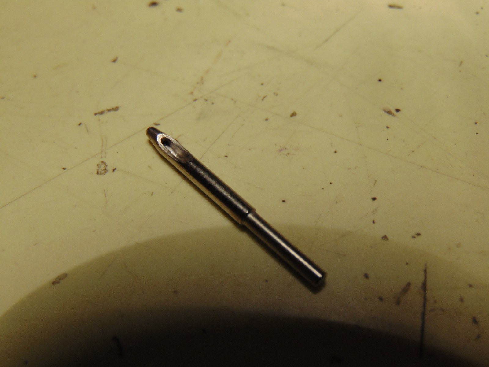

I bought a couple of hollow punch bit to do the job, 1mm diameter, for sure the right tool!:D I mounted on bench drill, it's fast and accurate, with or without engine running.
I will sew as usual with double needle and waxed twine.

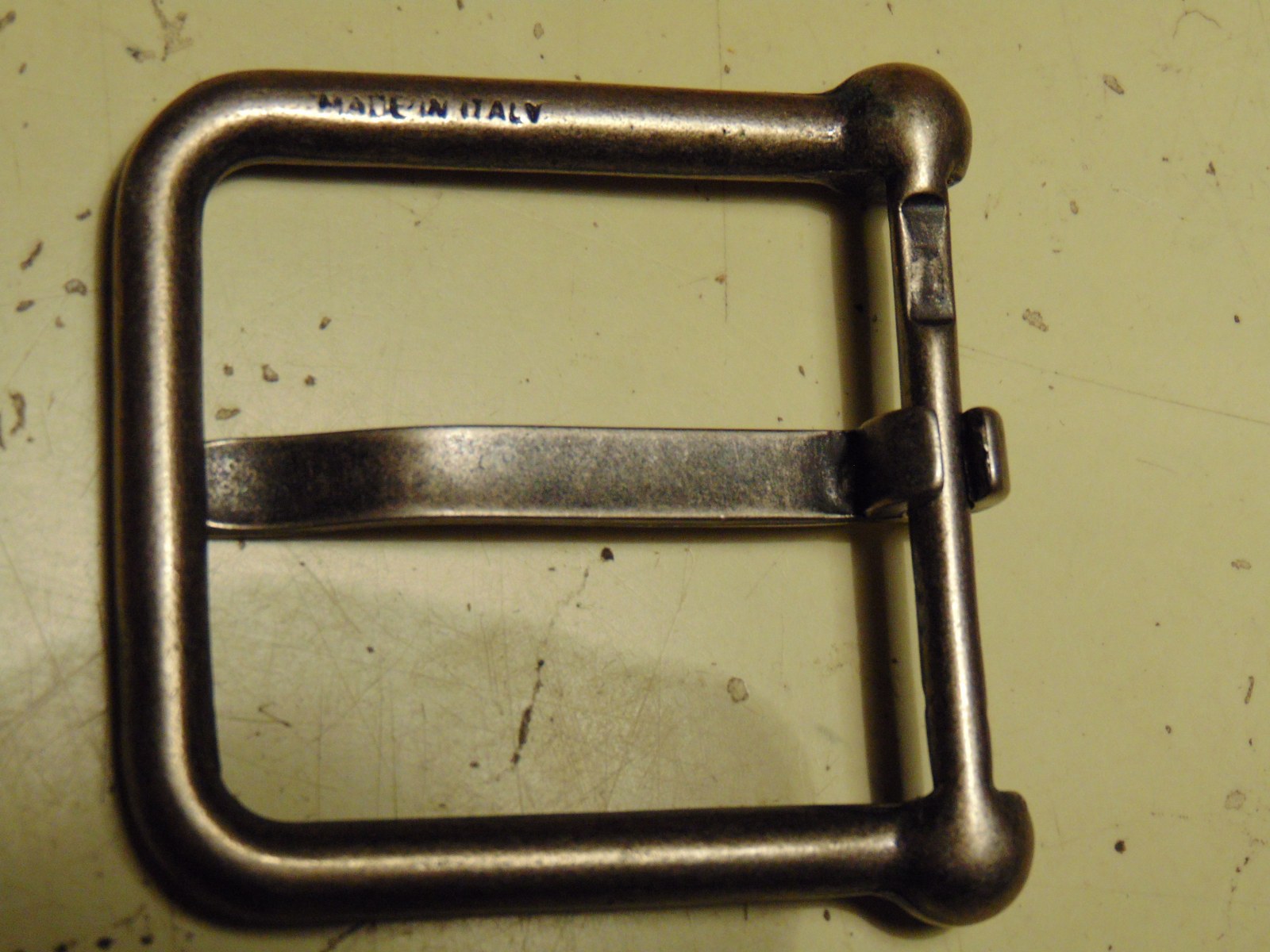

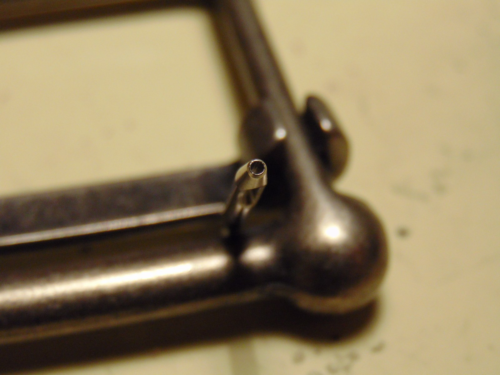

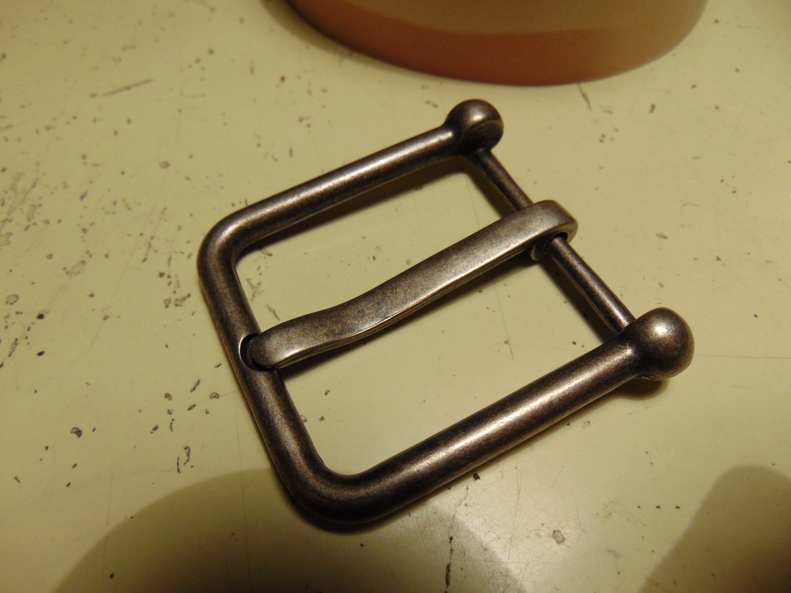

I was undecided on the buckle, I could build one, but it would take too long, so I decided to buy a good one, made in Italy, maybe made in zama :mad:, at least strong
Some picture of today
