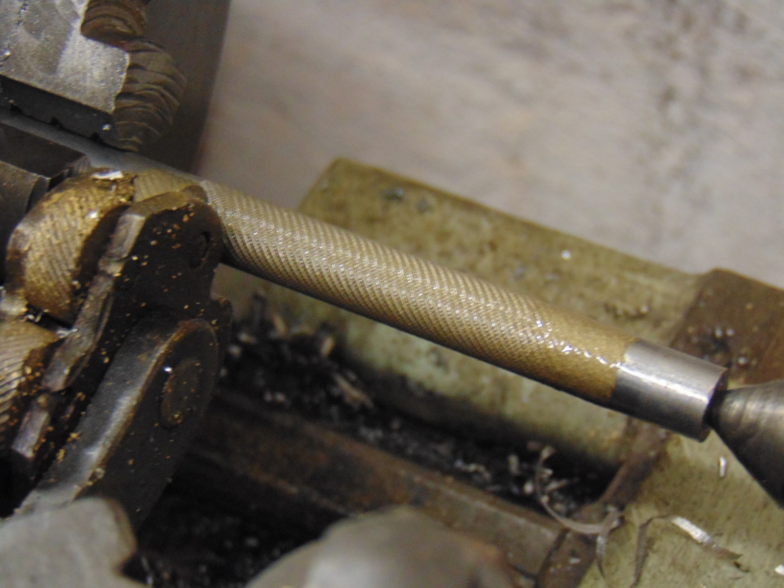

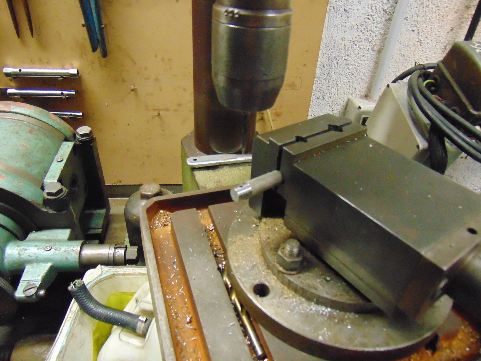

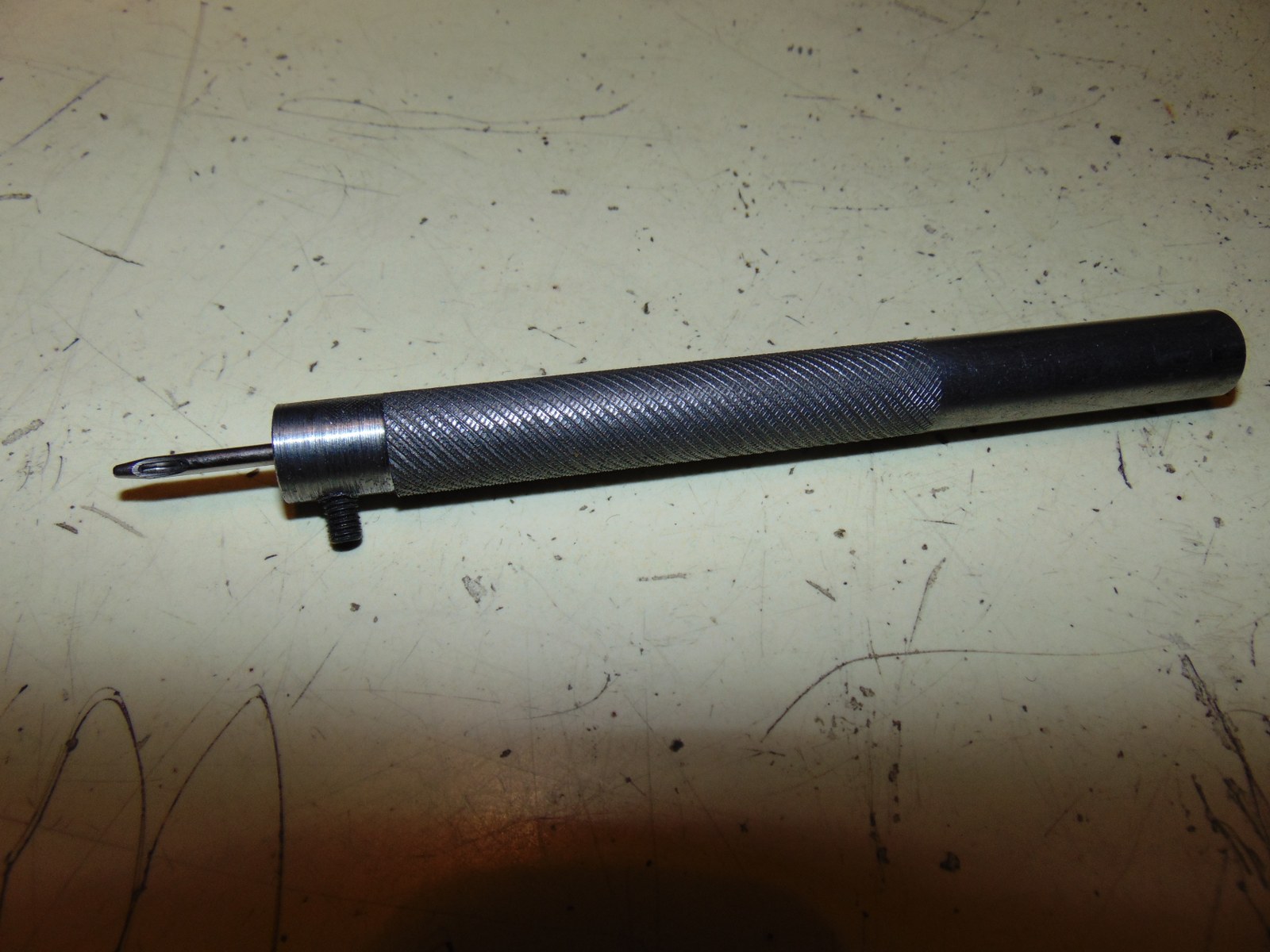

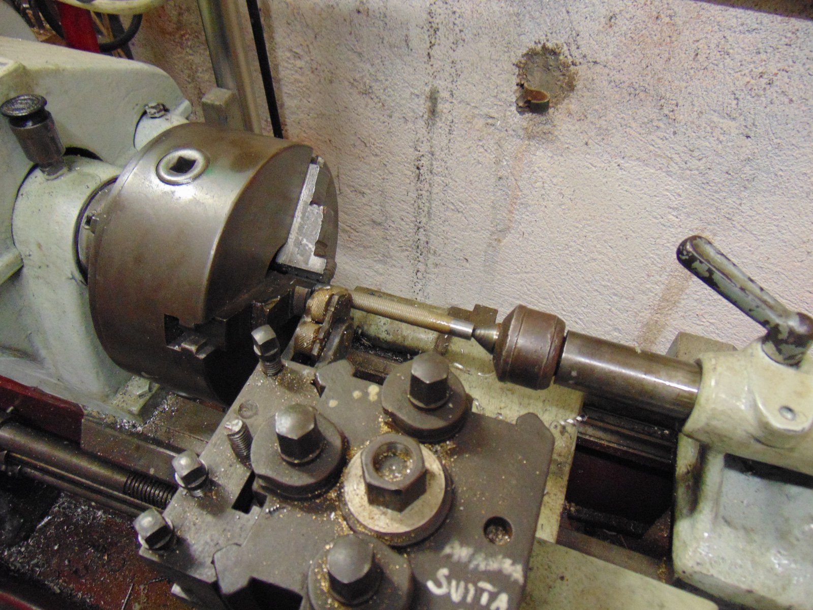

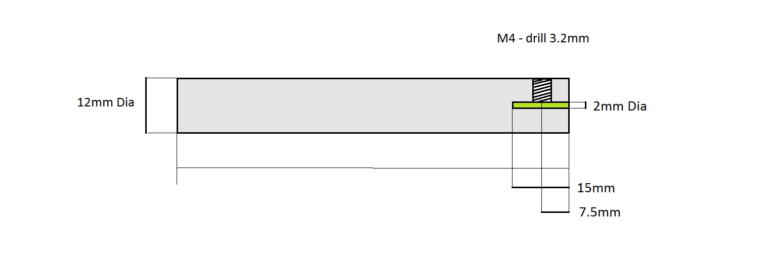

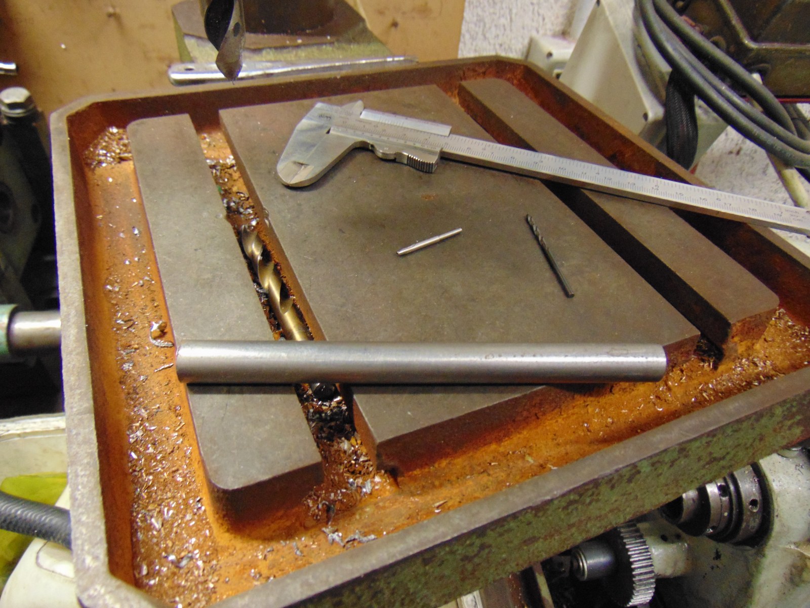

Hi all!
I built an holder for leather punch. Steel made, for 2mm rod professional type punch.
I applied a knurling for a better control on grip. The M4 grain block the tool in position and prevents slip.
I have to buy a new grain of correct size, in 5th picture I mounted one I had available only for test.
I not consider this a tool, but since I had to make a drawing for a friend, I decided to post here, maybe it can be an ispiration for someone :)
Saluti
Stefano
Attachment 16143 Attachment 16144 Attachment 16145Attachment 16146 Attachment 16147 Attachment 16148

I omitted in the drawing the total length because of hand size. I leaved some beef behind, trying to avoid shot of hammer , plus I leaved the lower part straight in order to have a good rest for pinkie. I found very convenient to use pinkie as centering guide and good for extraction. I found here from local leather "pro" shop replaceable punch bits, about 1 euro each, in different size, I tried also to use table drill to make the leather job, but I think the hand method is more accurate and fast
