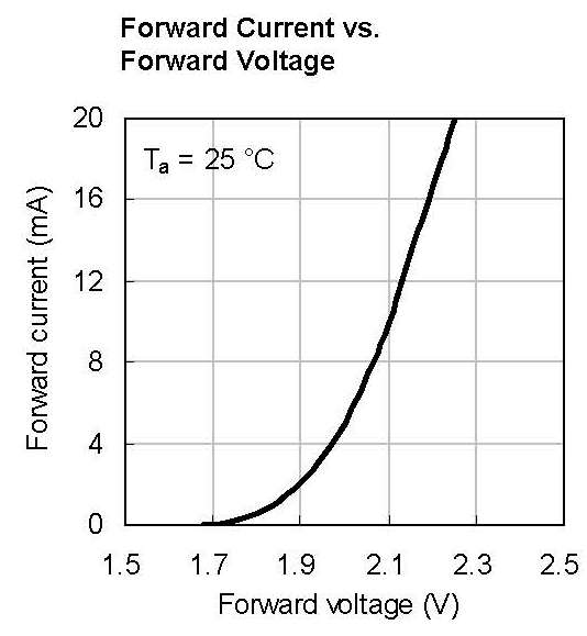

Here is a chart taken from a Knightbright WP7113PGT datasheet which is a Green LED, a good representative of a common Green LED. The first chart shows Forward Current (If) versus Forward Voltage (Vf). From this chart we see that up to about 1.7 volts, there is no current – so no light. Then the current increases pretty quickly. Notice that the largest If on the curve is 20mA. The datasheet elsewhere says the maximum If is 25mA.

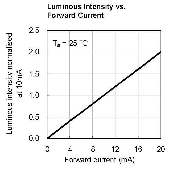

Another chart is Luminous Intensity versus Forward Current. This chart shows the Intensity (normalized to the 10mA If) versus the forward current. Again, the If goes to a maximum of 20mA. This chart holds a very useful hint – the manufacturer thinks it should be used at 10mA If since that is what they specified the Intensity in the graph.
Attachment 41349
These charts also indicate that the most important parameter in using the LED is the current – If.
Not voltage, but current.

For this example, we will use a battery voltage of 5v. We know from the LED datasheet that we want If=10mA and then from the graph we see that Vf would be 2.1v. Looking at the circuit, if the LED voltage is 2.1v and the Battery is 5v, that leaves 2.9v across the resistor and the current through the LED and resistor are the same, so the current through the resistor would be 10mA. Using Ohms law, V=I*R, if we want to know the resistance, we rearrange the equation to be R=V/I and R will be ohms, V would be Volts, and I would be Amps (so that 10mA will be 0.010A in the equation). Plugging in the values R=2.9/0.01 gives R= 290 ohms.

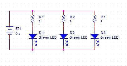

How about if we want three LEDs? For the 5v supply, we would need to have a current limiting resistor for each LED as shown here.
Attachment 41351
That is because 3*Vf is greater than the supply (6.3v > 5v). Each resistor would be 290 ohms. You might look at this a think that you could save 2 resistors by attaching all three LEDs to one resistor. First, you would need to have 3*If or 30mA in the resistor, which the resistor can handle just fine, but the problem comes to be if the LEDs aren’t very close in parameters. What can happen then is that the imbalance in If versus Vf can cause an LED to take more current and that can cause the LED to fail. Best practice is to use the three resistors.
