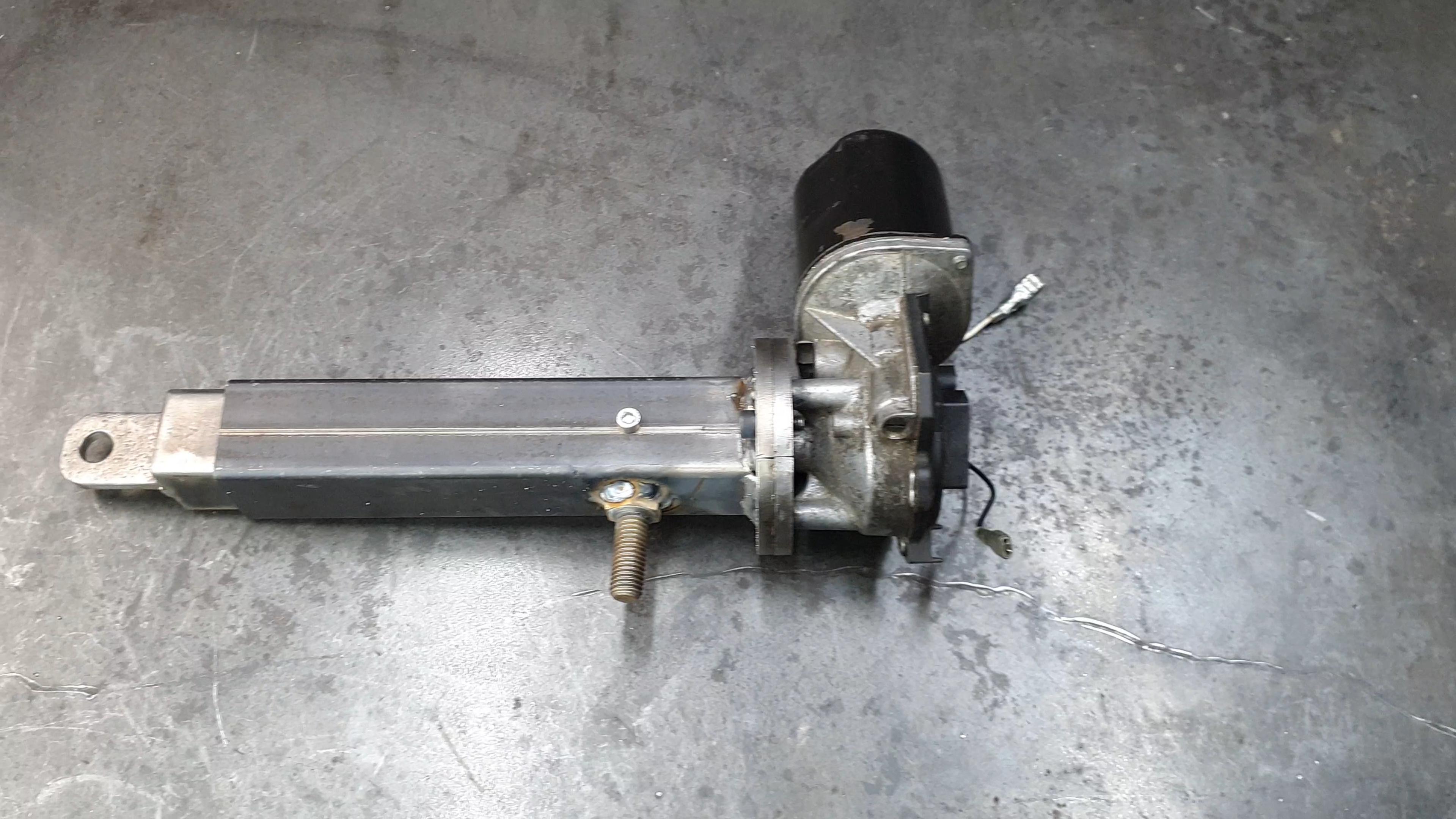

I present to you a 12V linear actuator of my design.
Attachment 48194

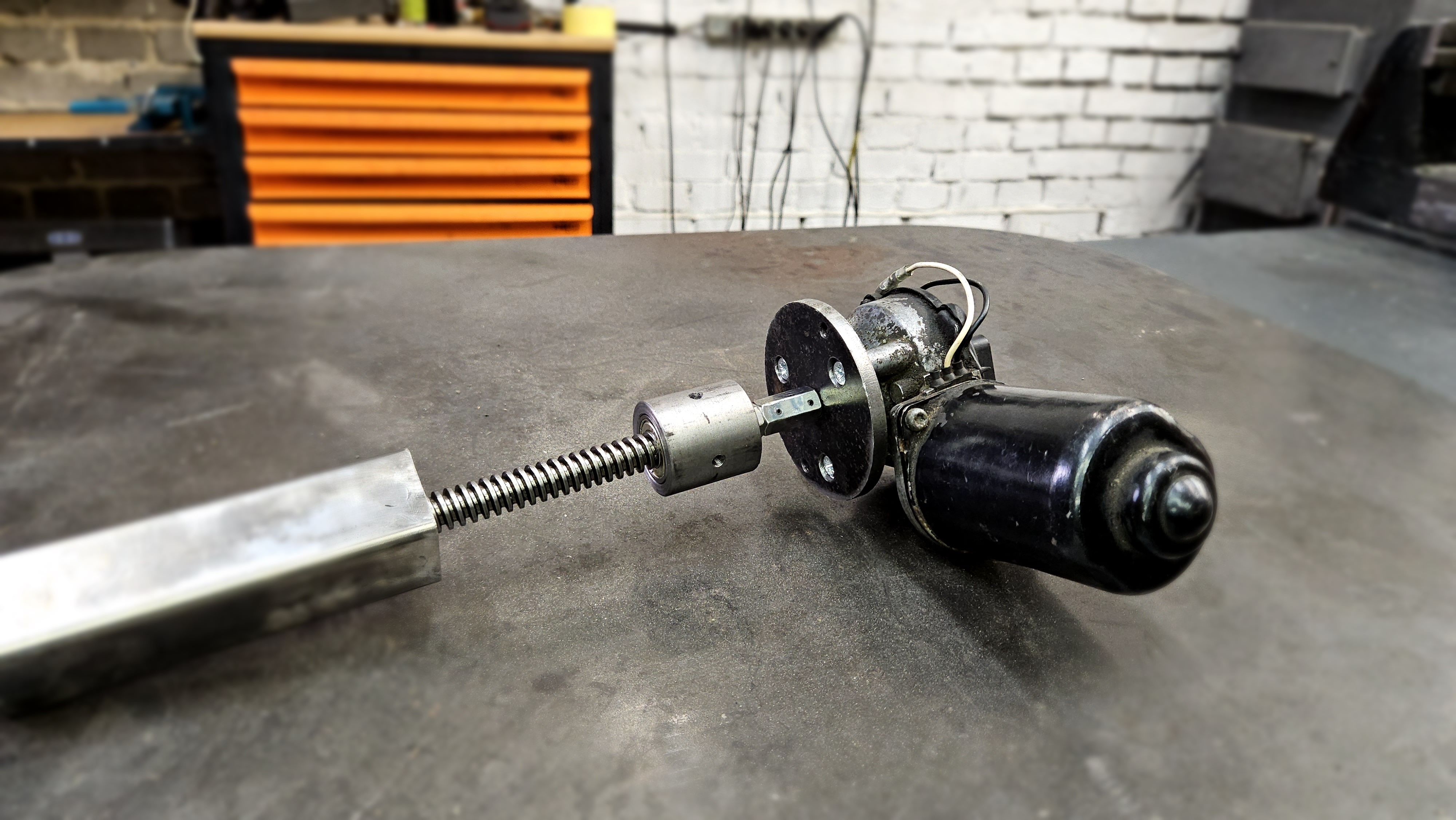

The motor comes from a car windshield wiper drive. It drives a 16x3 trapezoidal screw which pulls a nut welded into a 35x35 profile. This in turn moves linearly in a 40x40 profile to which a flange mounting the motor is welded.
Attachment 48195

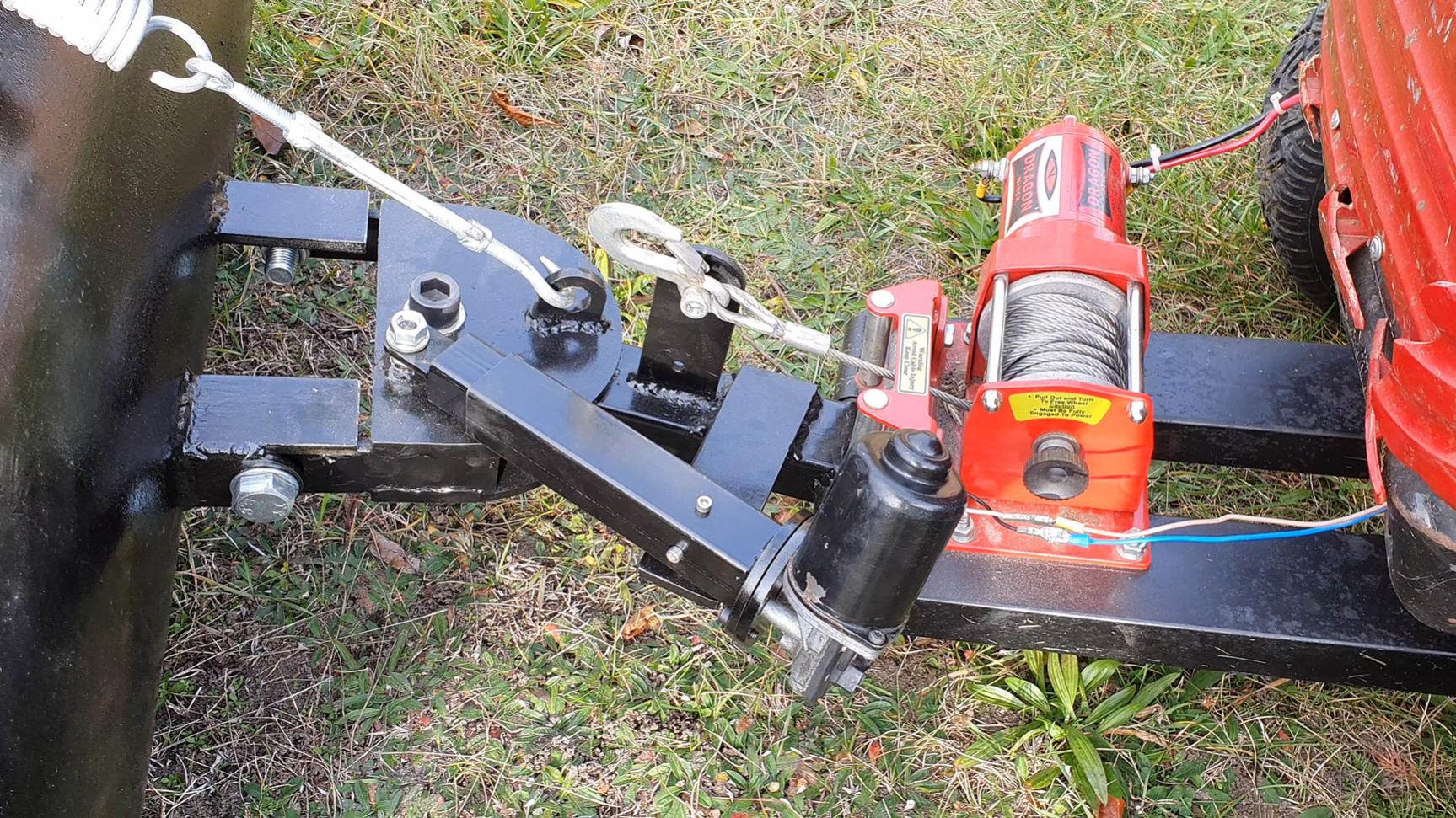

The actuator is designed to turn the snowplow sideways.
Attachment 48196
